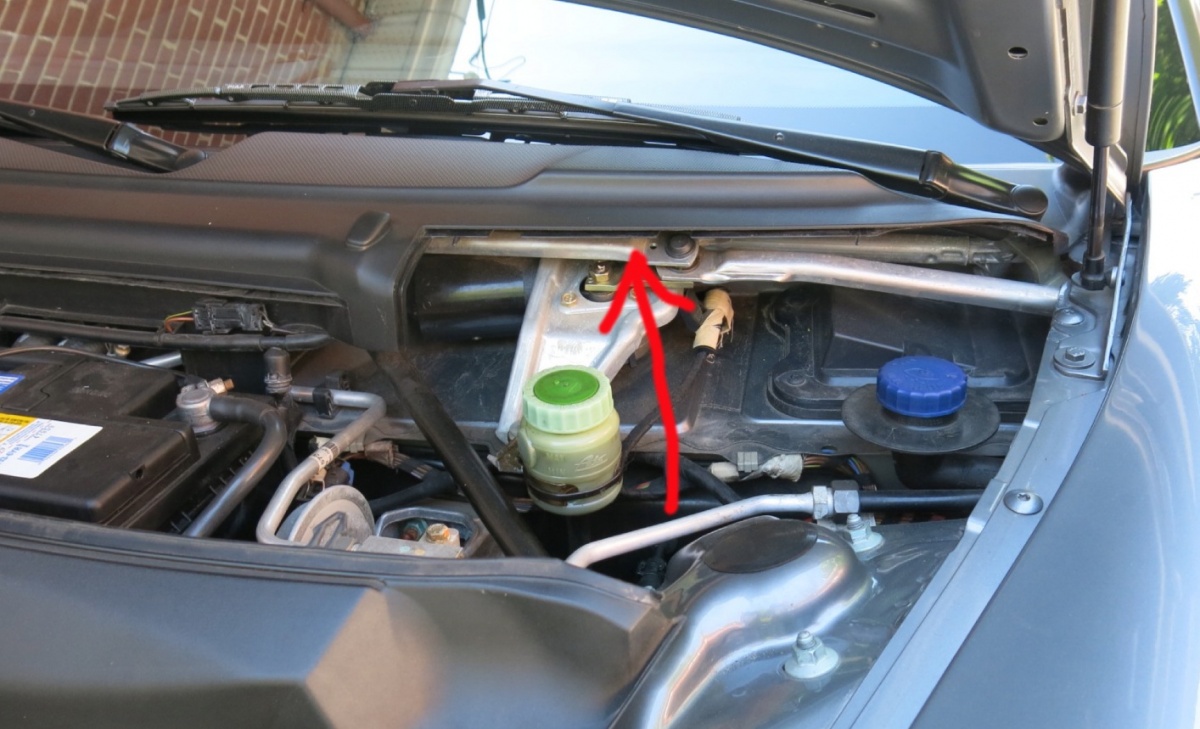

Remove the battery cover. Remove the left cover over the clutch reservoir. Look at the condition of the linkages on the wiper motor. I suspect the linkage going to the right side being disconnected from the wiper motor. See picture....You can also start the wiper operation and look at the movement. Warning do not operate on dry windshield also be careful not to have the wiper away from windshield if you open the bonnet. The arms will contact and damaged the paint....

Yeah, just a loose bolt.
