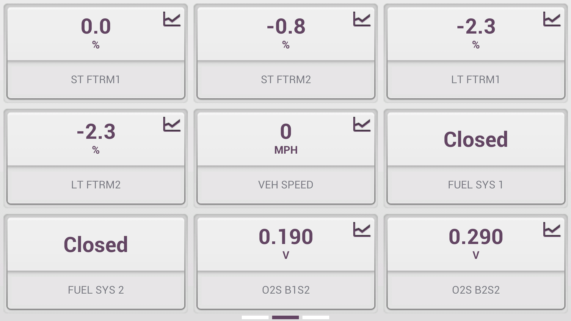

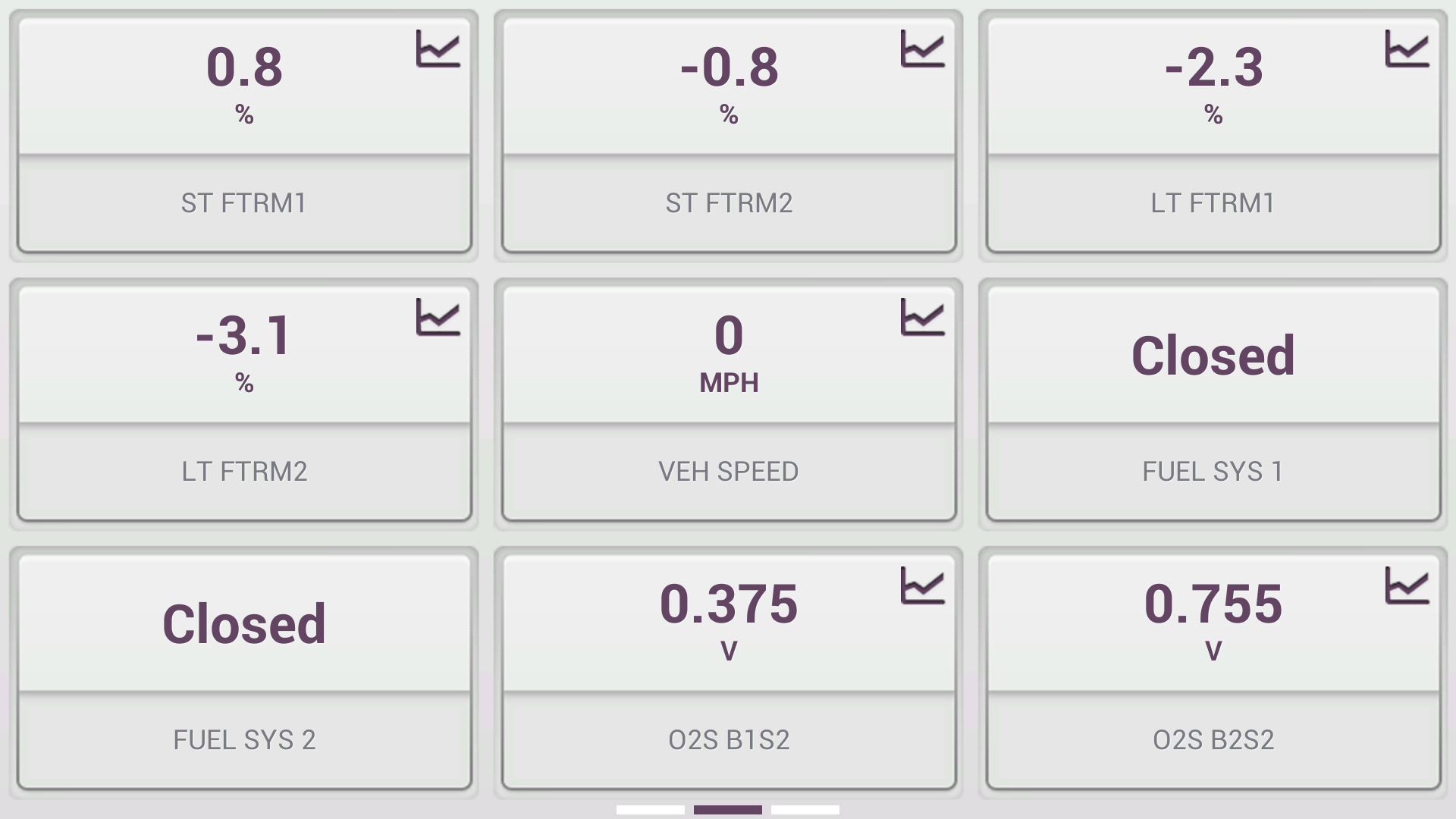

Will get too that so i converted my manifold pressure and at idle i am getting 36psi wtf????? Also im still waiting for a tune update to be sent to me.

not sure what you are doing there. Pressure value is a reading from a sensor and 36 PSI would be 2.48 bar.
Still no complete log yet? We need to see the whole picture.

Tuner over here said no more runs until you get an update tune. My WOT is perfect at 11.9 afr tho my idle is running in the -15 to -20 stftm. No boost leaks, no miss fires that i saw but at idle it just burns rich and when tapping the gas i get that hesitation.

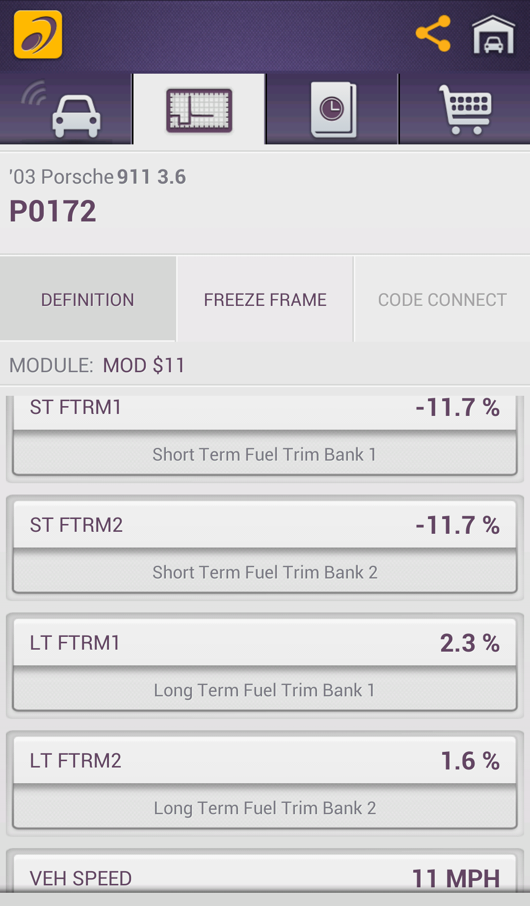

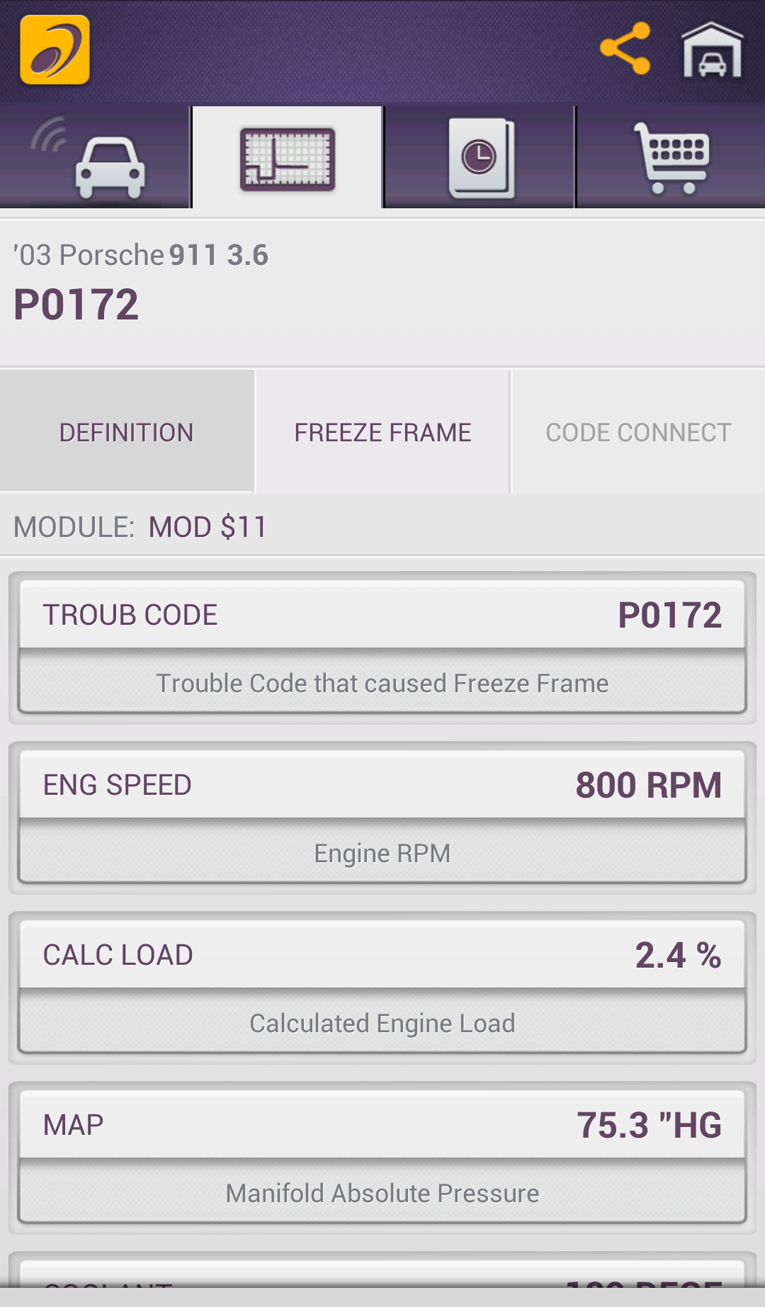

Hey your right about that and heres another screenshot this is a freeze frame when the code popped so something here is not right.

Were you getting the 36 PSI from the Manifold Absolute Pressure? Because that unit is in inches of Hg not PSI. See if you have an option to change units.
I tried to convert it i cant does anyone kniw what 73.5 hg in psi?
