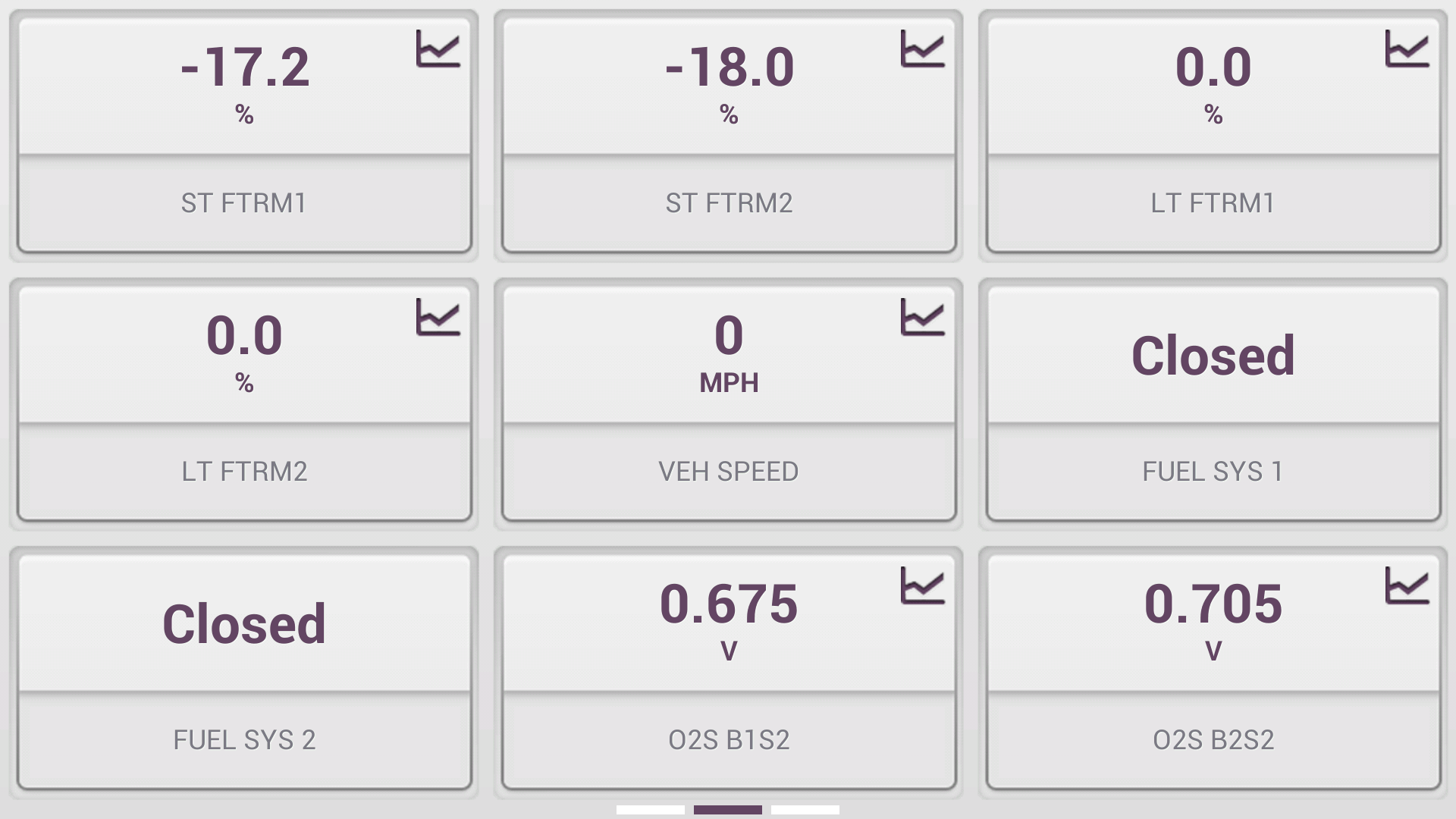

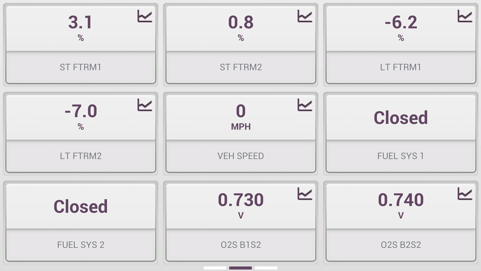

Ok guys sorry on the data from before i posted the wrong idle fuel trim numbers they were the old ones heres the new one on the right and old one on the left look at the difference. Now i don't burn rich anymore also when i floor it i don't see grey smoke.
It's like a new animal........... ohh my spool in 3rd gear i was at full boost around 3k. So far no P0175 and P0172 codes and i drove 30 miles.
