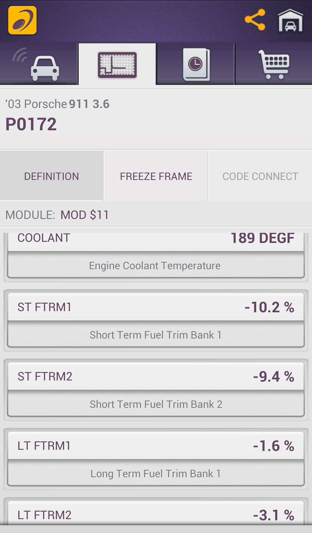

Alright guys heres a freeze frame of my ST FTRM1 this is what caused the code to pop up at exact moment. Sorry i forgot to take the freeze frame of the other bank. Thank you too U-Scan great device for free.
Manifold absolute pressure was at 75.3 HG at the freeze frame which equals 36psi how is that possible at idle?

Confirm you do not have the HKS BOV on the car? If you pull enough vacuum on it at idle, it will vent metered air to the atmosphere and can cause a rich condition. This will never show up on a pressure check. Your issues scream vacuum leak to me, but it wouldn't hurt to confirm with tony you've got the correct 5 bar file as well.

I have the forged diverters on the car for right now still doing the samething. Do those numbers look right? I can take longer data the tuner has confirmed it is running rich at idle. I did have Tony raise it up now i guess thats not a good idea.
Well for it too call up a freeze frame on those numbers something isnt right with the fuel trims. I should have taken the kther bank freeze frame p0175 p0172 if it happens today ill have both freeze frames for you guys.

Yeah doesn't seem right, do you have O2 values at idle as well? Are the Forge diverters recirculated like stock or are the outlets dumping to the atmosphere like the HKS was?

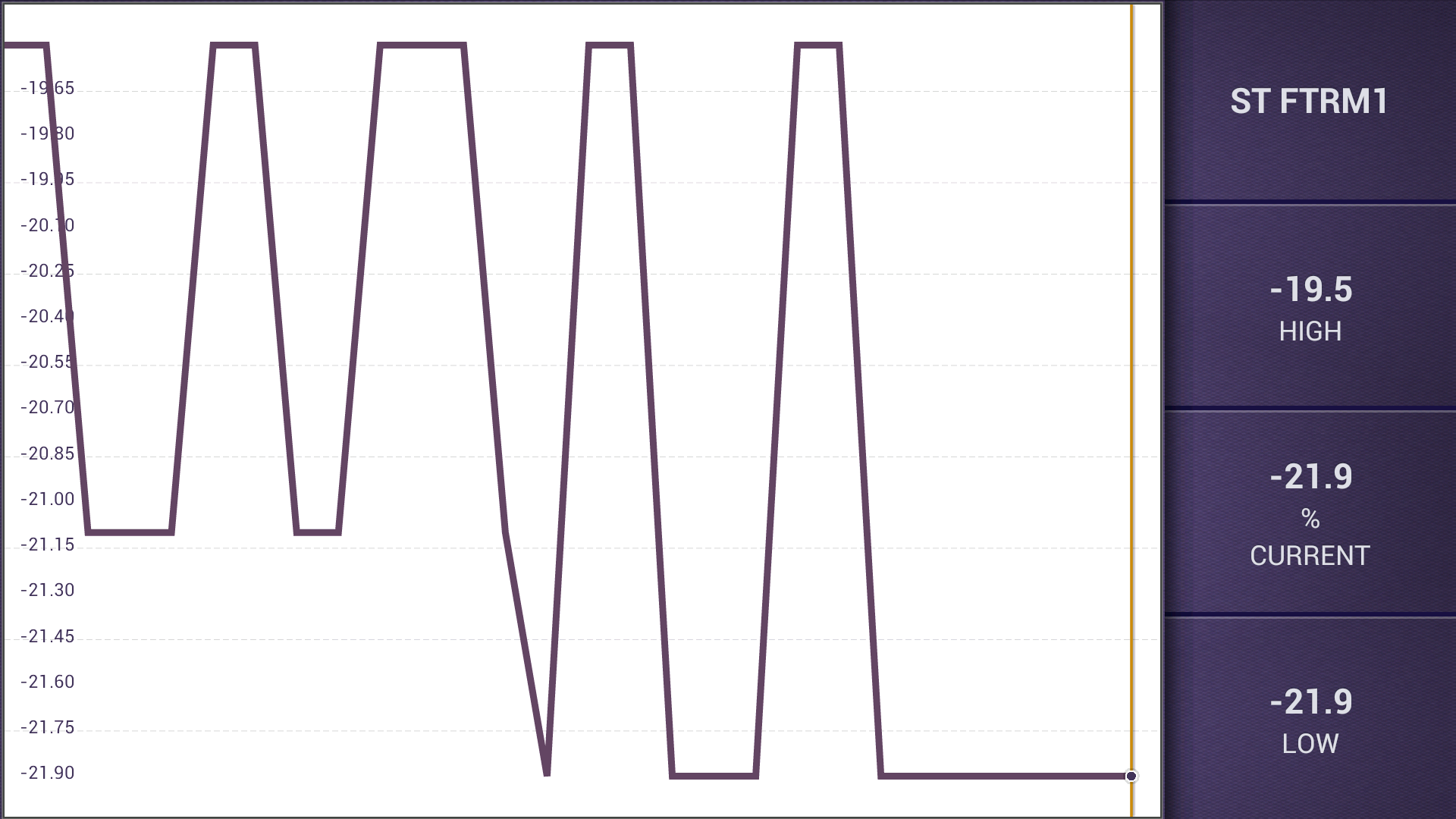

Everything is done just like you guys told me to do including the bov. I agree what i will do is the u scan takes live graphs i will do that and let it idle heres a crazy graph it took so my trims went back up once i cleared the code to -21.9 this is wacked lol also on the freeze pic it says i was doing 7mph so.
