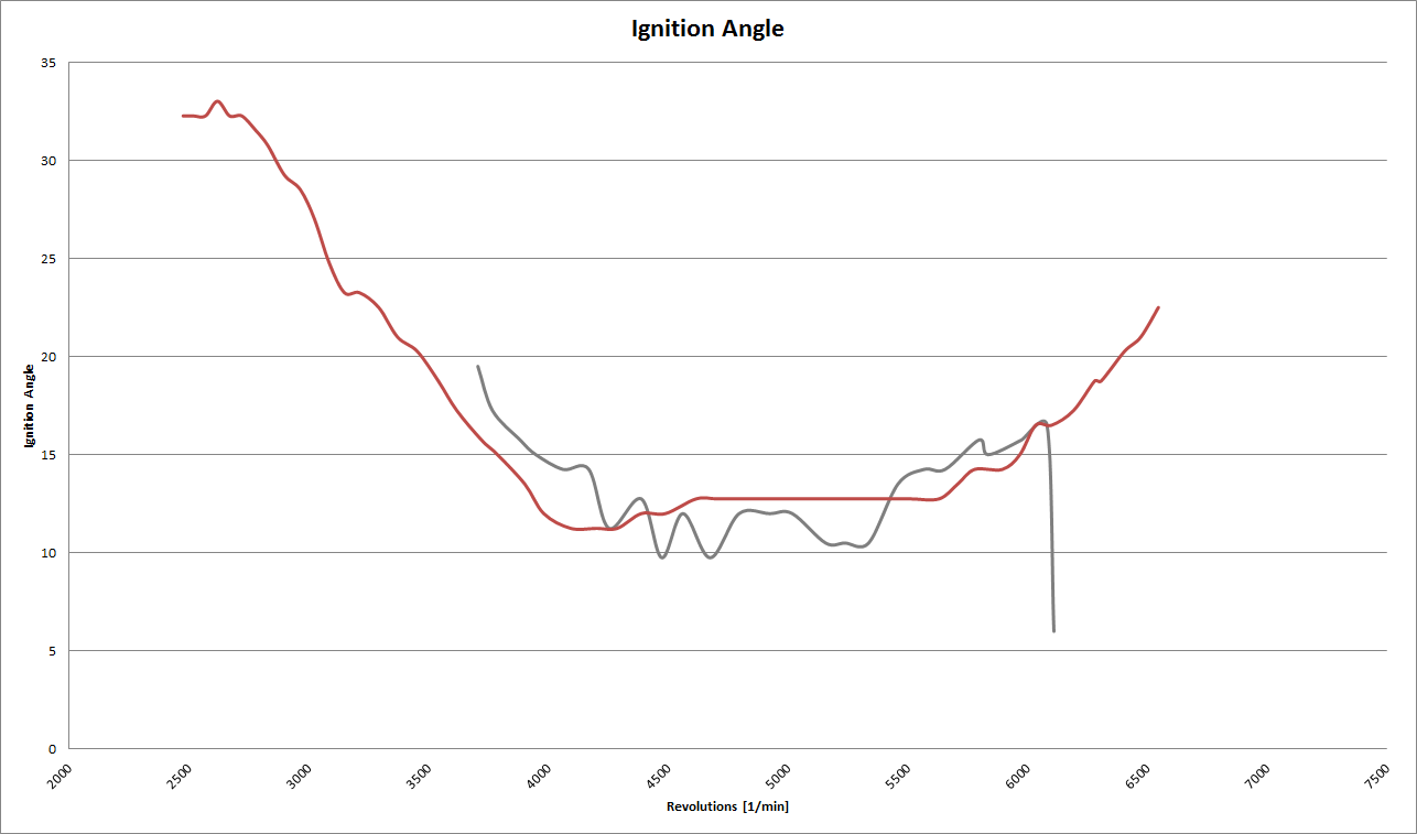

Just as a reference for future logs: this is your ignition timing from your log you posted here before. The red line is the iginition curve of my car when I did my last log - not meant to be a comparison. I always have before/after graphs in my visual representaion of the logs. My "before" data was just replaced with your data.
You have ignition breakups all over the place.
Hmm not sure i guess Tony can tell me what he can do for this.
When i floored it i felt no hesitation at all ohh might be because i need a colder spark plugs plus my plugs need replacing soon im guessing.
