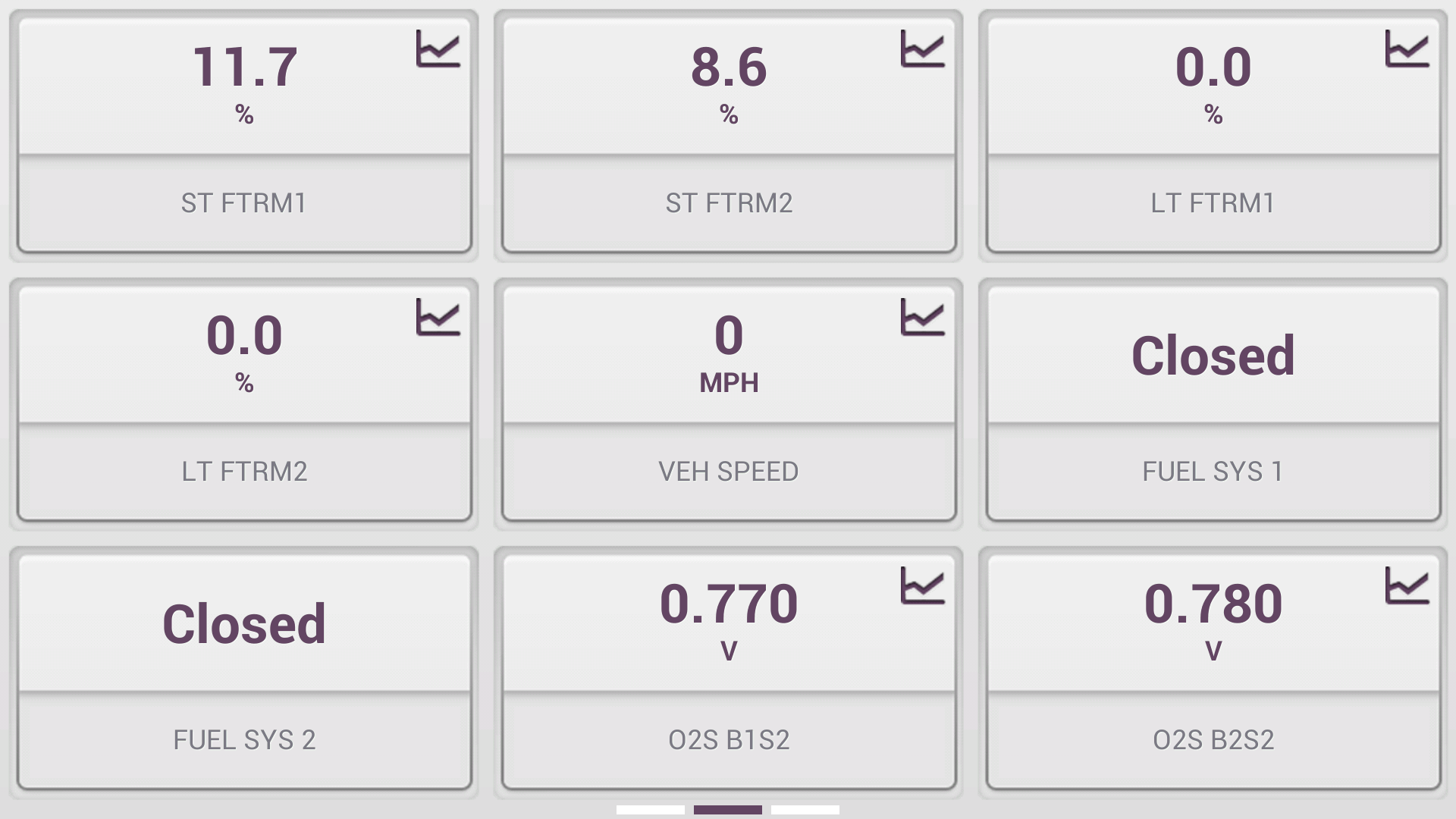

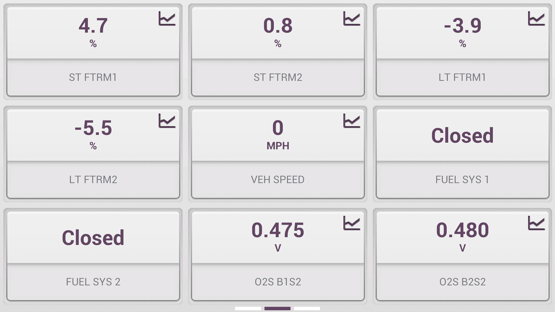

Tony is very helpful trying to track it down. Im frustrated myself because i find these problems on my own but i guess thats not the case. Something is wrong somewhere that the other shop did and i cant track it down.
Today i drove my car and all fuel trims were working great the most it went to was -5 to +5 at idle. I was like yes great. Well after 30 min of driving watching my fuel trims bam they go zero and dont move at all again for LT trims. ST trims just go wack at idle to -20 im like wtf light pops on. I did check out my 02 voltage they get up 0.500 to 0.970 volts when the car goes wacked.
Let the car sit for 4 hours restart it and bam fuel trims for LT start working again and ST go back to single digits. What in the world is going on my car runs awhile it goes crazy restart it later in the day it all goes back to normal.
Left pic shows my idle numbers prefect.
Right pic shows my numbers all wacked and engine light popped on.

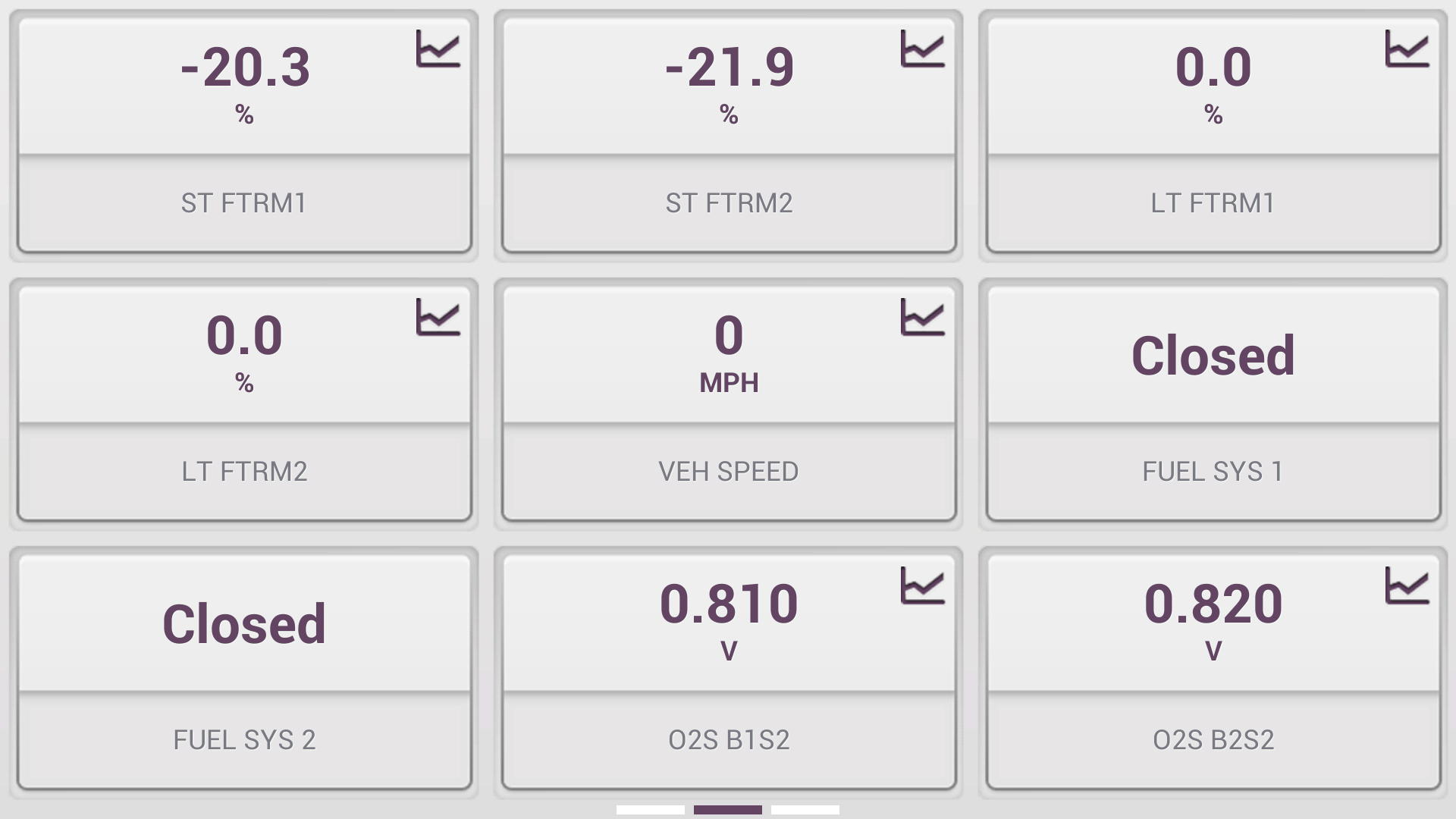

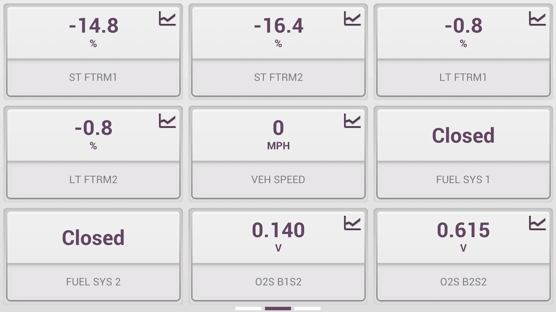

Guys look at my voltage it doubles for my 02 Sensors and too Tony we talk now in email sorry for all of this. If we can't find the problem im going to do injectors from Tony and new tune.
FPR Checked no leaks
No boost leaks
No exhaust leaks
Have no changed out the MAF yet.

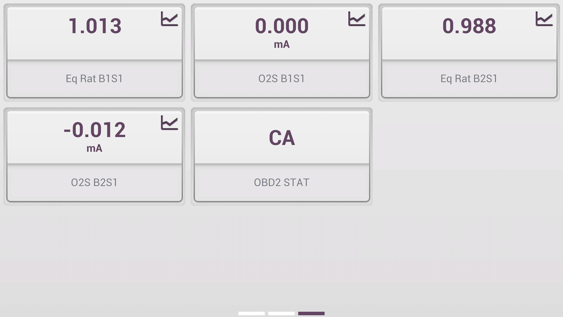

Screenshots of a log are not very helpful. We suggest Durametric because you can copy/paste an entire log which is way more helpful!
You need to monitor O2 B1S1 and O2 B2S1 ... You are monitoring after the catalytic converter which will throw off the actual o2 readings plus they are narrowband o2's so they are useless to monitor your actual AF. The S1 are the o2's that are pre-converter and the most accurate reading (ME7.8 and multiple other ECU's run off a true wideband O2 sensor).
At idle sitting at 1.0 on sensor 1 on both banks is good. That means you are idling at 14.7:1 a/f. Reving my car stays lean just like a stock one does.
Switch your o2's to the S1 on both sides at least for some of this.

Sorry here you go attached. I think were getting close to the problem....
