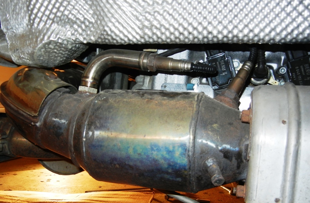

think mine is from Vibrant. Milltek exhaust. No CEL but not sure if its needed anyway...

the extenders keep the secondary O2's out of the exhaust stream and in a 'clean' air space. Not needed for muffler modifcations, only if removing or using certain high-flow catalytic converters.
I'm going to try removing them this year and see if I get a CEL...

I'm running 3.5" catless bypass pipes and using the short FVD extenders as you can see on the 3rd rearmost oxygen sensor below. Works as advertised. No CEL and all readiness codes show as READY.
