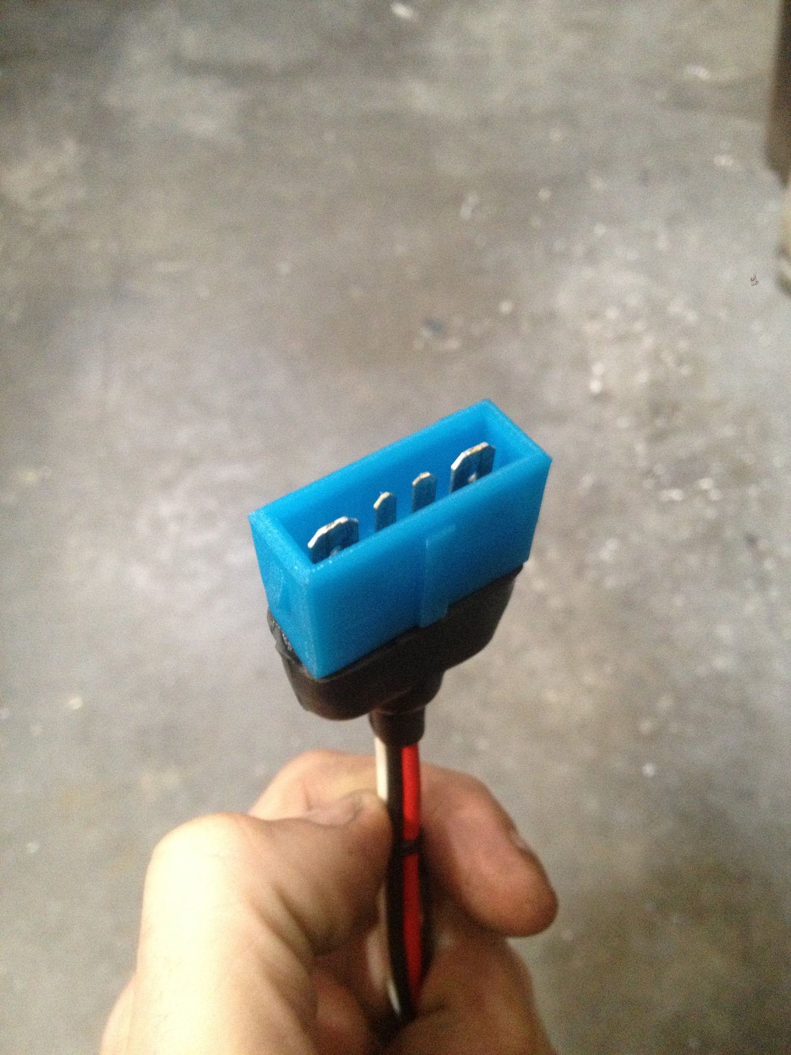

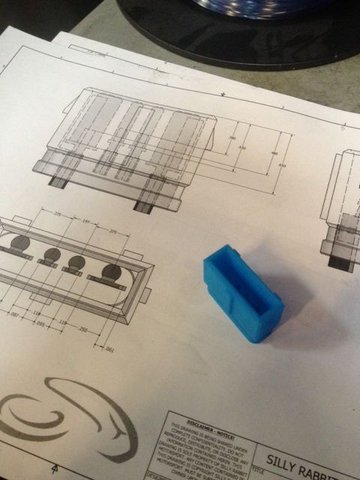

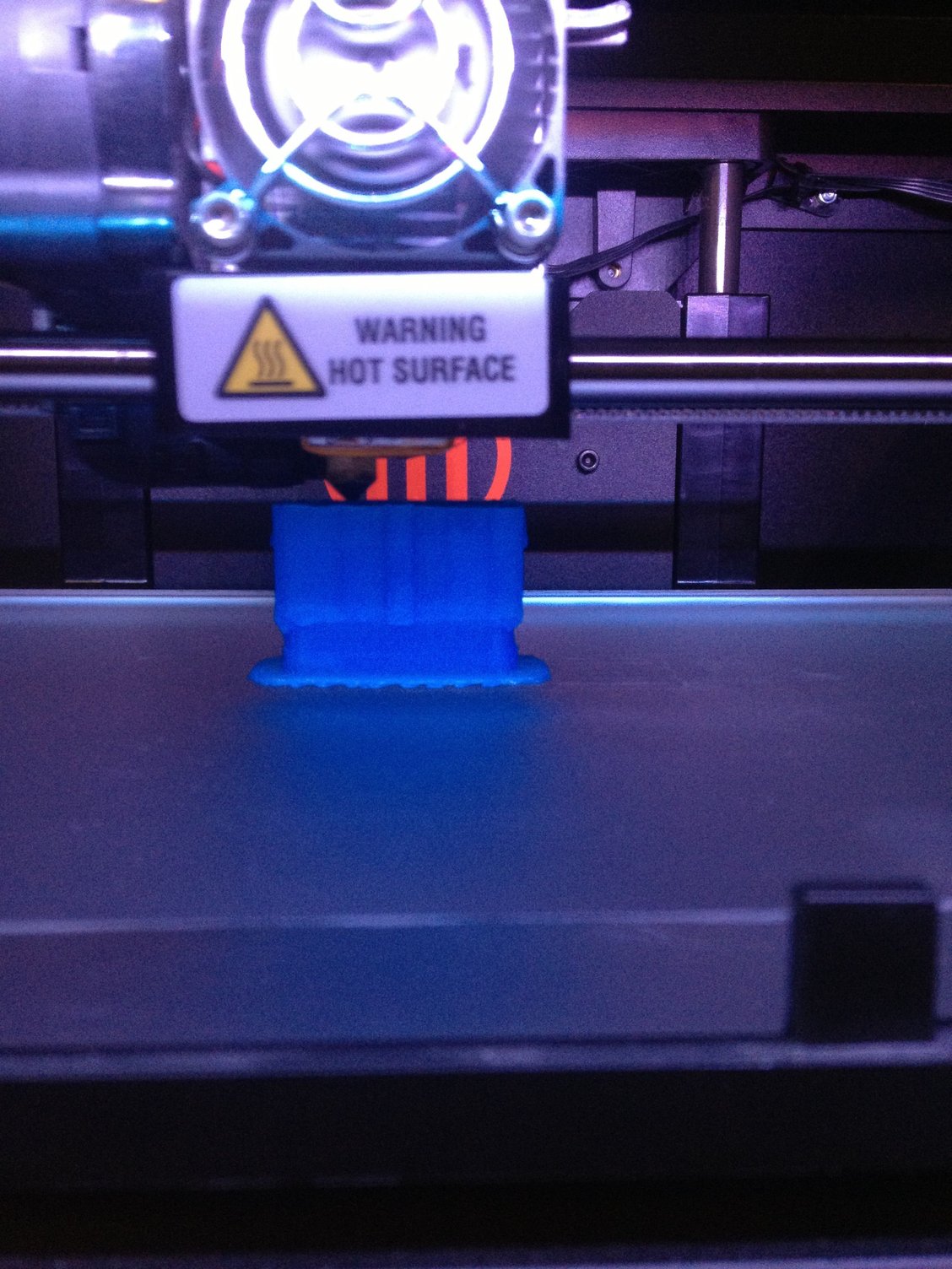

Sent all these to Sam he must be busy. 3d printed the plug as it was not available from anywhere.

Ah ha! Didn't realize you were the one behind Silly Rabbit - been checking out the PnP fuel stuff on your Porsche page wondering if any of it would fit the TT, question answered! Edit: And duh those are Audi systems I saw, not Porsche. If you can price this anywhere close you'll have hit a home run!

Sorry guys, vacation for a few more days. Hoping to have some next week! Sean and Kyle really hit the "we don't f&$@ around" level on this one. We can't find it so we'll just print it!

Pretty cool huh. Almost there.
I appreciate Sean at silly rabbit for taking notice of my opinions and having an awesome attitude about making the kit this way. Many of us are not afraid to cut and wire but when you can plug and play it's just much better! Especially if you or your shop DON'T want to cut and modify too much. It's the details!

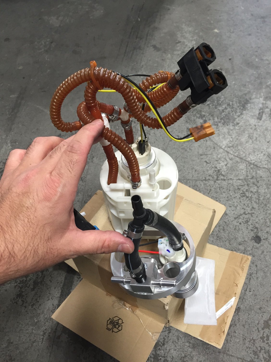

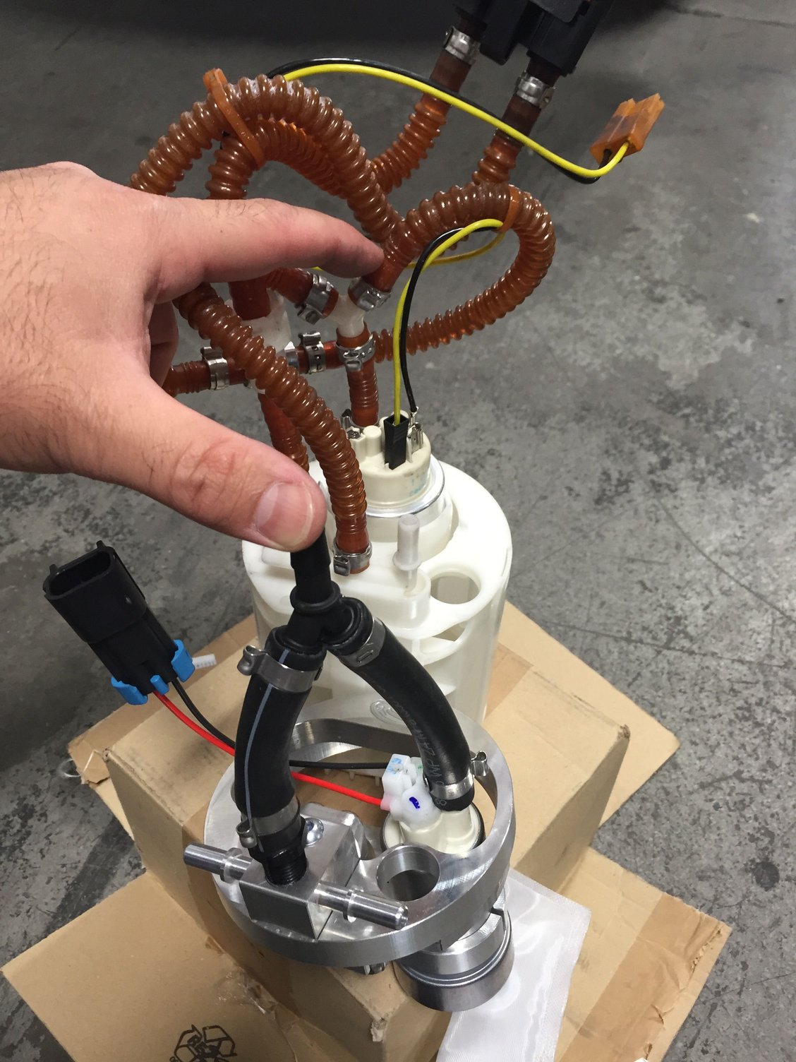

I'm in the process of installing the SRM fuel pump kit. What are you guys doing with the crack prone OEM "U" shaped hose? Any replacement options? Porsche doesn't sell that separately. Thx
I'm in the process aswell. I have the pumps setup and am finalizing the wiring.
I removed the entire oem "u" and the plastic line, and replaced with -6an hose and fitting to the top hat. To make the an lines fit, with enough room to do them up, I had to "loop" the line in the tank. For me, I feel much more comfortable replacing all lines.

Of course the first one I did in the house is there an updated pump without that rubber part. I'll try to get more photos up. Here I am pointing at the corresponding lines.
