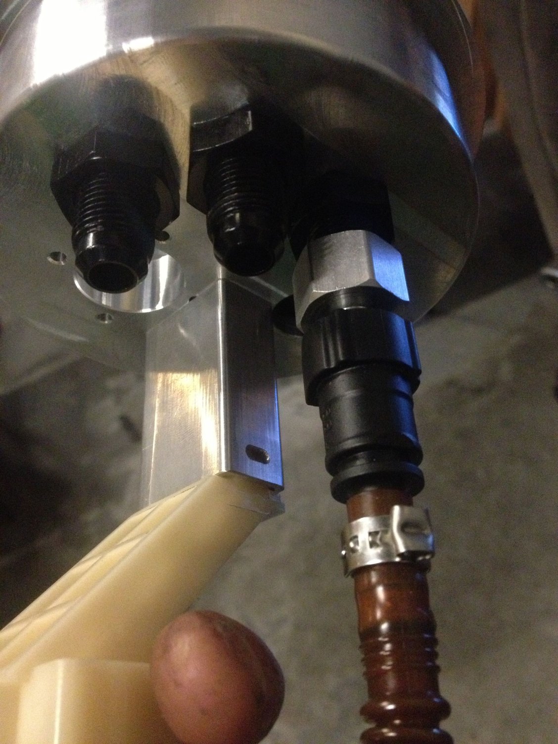

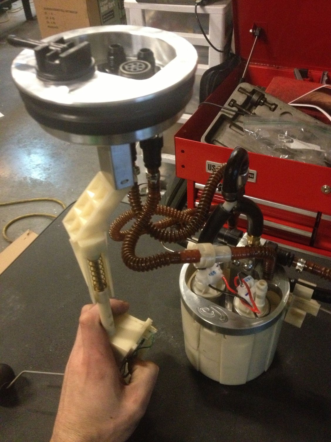

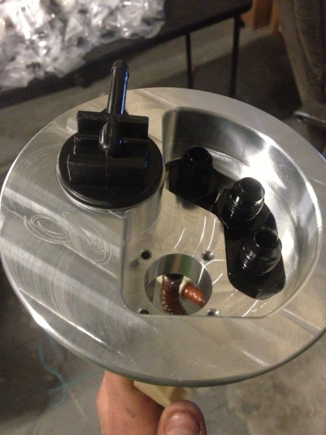

Originally Posted by SamboTT@ByDesign
Mmmmmmmmm
Upper bulkhead being machined. The lower portion of the factory sending unit will snap into this piece. All lines between the pump and a purple kid will be upgraded and provided. Above will be fuel line fittings for any configuration. Adapters for stock fuel lines...which will be fine on single pump set-ups up to 800/900 crank hp with large injectors. Or –6 fittings ready to Y into –8 all the way to the back into custom fuel rails being built now. Even a third pump can be added to this configuration but we think it will support 1200 crank hp even on E85.
Anything can be done. We have even talked about using one pump to power the Venturi's and the other pump solely to feed the engine fuel. But I think the best option will be a single pump or dual pump and it should cover most builds.
There will be a mill spec electrical connector that everything plugs into. No cutting. I promise more pictures as I get it. Sean and Kyle are really moving fast.
Getting closer ASLAN!

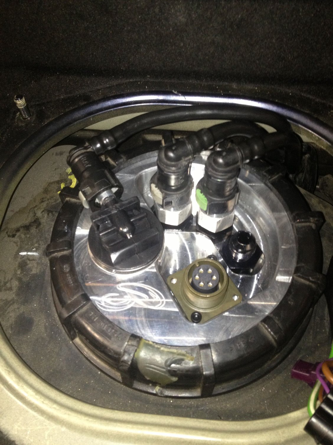

For those guys waiting on me to post thank you for your patience. Sean and Kyle at silly rabbit motorsports have been working hard all week on top of other things they have going on to get this done and installed.
All set and clean like he wanted. All they have to finish is the plug and play wiring harness then comes the stage two with the full line kit front to rear end rails. They are working away.
Sorry for the massive pictures.
Top and bottom pump section. Sending unit incorporated
Old Dec 19, 2014 | 08:44 PM
  #116
SamboTT@ByDesign's Avatar
Joined: Sep 2003
Posts: 4,901
From: L.A.
Clean!

Nice Sam. Very nice.

Beautiful work for sure!

Ooooh I love me some billet items....
Beautiful with the machining marks...
Nice work!!
