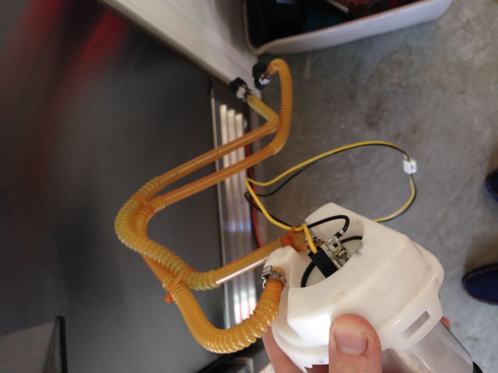

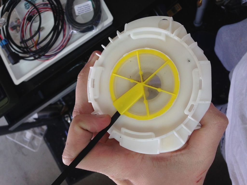

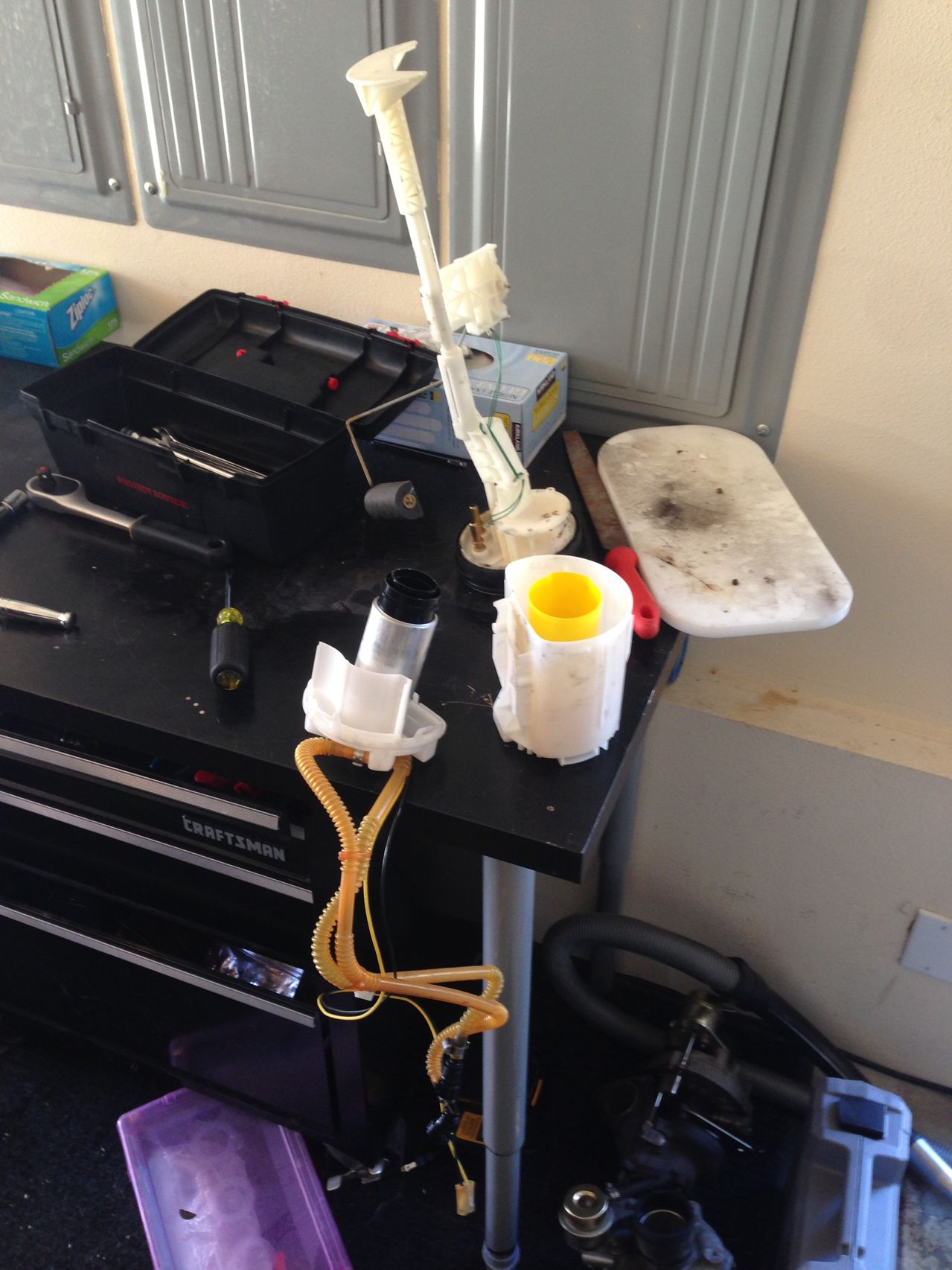

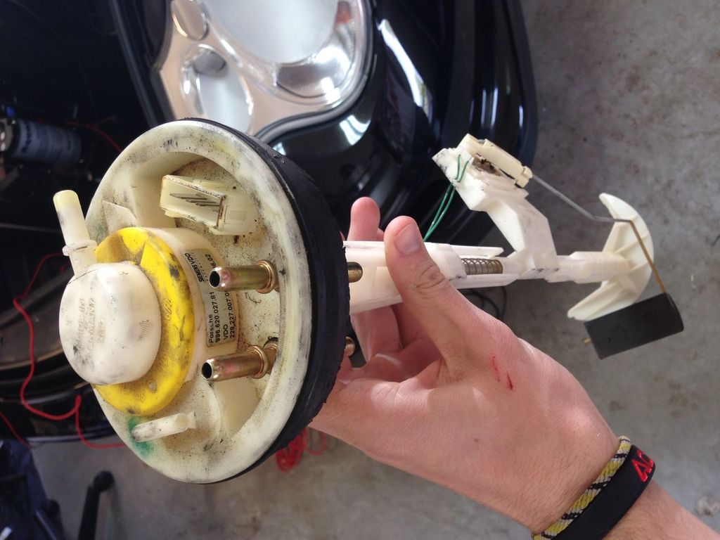

Podigy mentioned that there was a single jet on the gt2's fuel system, but I think this is year dependent. My gt2 is a 2003, and didn't have a single pickup. (I'm the gt2 LQQK is refering to when he says he did a fuel system).
This is the reason for the flow increase... If the gt2's part number for the pump is different, its ONLY to categorize it. Its a standard pump- The jet system/basket is the only difference.
We dropped the walbro e85 450l/h pump in, and never looked back. 630whp right now and I'm not close to running out of fuel!
Edit: I have also been to a few track days with the new pump system, and have yet to notice any sign of fuel starvation...

The only fuel moving into the basket is the return line from the fuel rail. The rest comes in passively from suction at the bottom of the basket. On the GT2, the pump sits in a basket submerged at the bottom of the tank. Its not at the top up by the fuel fittings, its literally in a seprate basket. I'll post some pics.
I used a thicker gauge wiring for the pump, but it pretty much uses the same wiring as the OEM pump. I just spliced the wires. The stock lines are too small for the increased flow. I went to -6an fittings/tubing all the way to the rail, but left the oem line for the return fuel. I also removed the stock fuel filter and installed a fuel-lab one under the car, along with a check valve.
The pump is so quiet that when we tested it for the first time with a durametric, we thought we hooked something up wrong. However, a second later our Gatorade bottle was about to over-flow, so we knew something was right...

As Max said - he and I did the install on his 2003 gt2, with walbro 450 and 6an line to the fuel rail. Also installed fuel filter near gearbox. I didn't upgrade the wiring in his car at all.
Max - do you still have the photos. I think you posted them in dgreens thread a while back. I'll see if I can find it.
The basket was like the standard Carerra basket, and because of the flat bottom there is no jet pump. The fuel enters thru the bottom of the basket and the return line come back in the top. This stops surge.

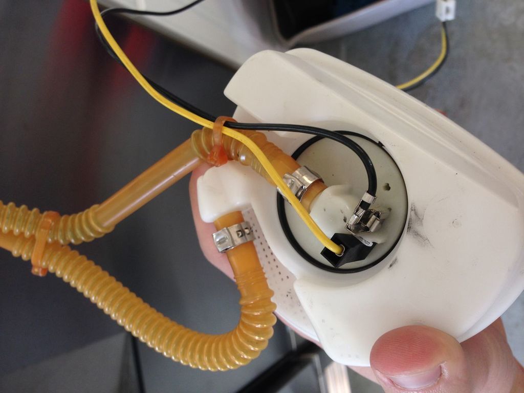

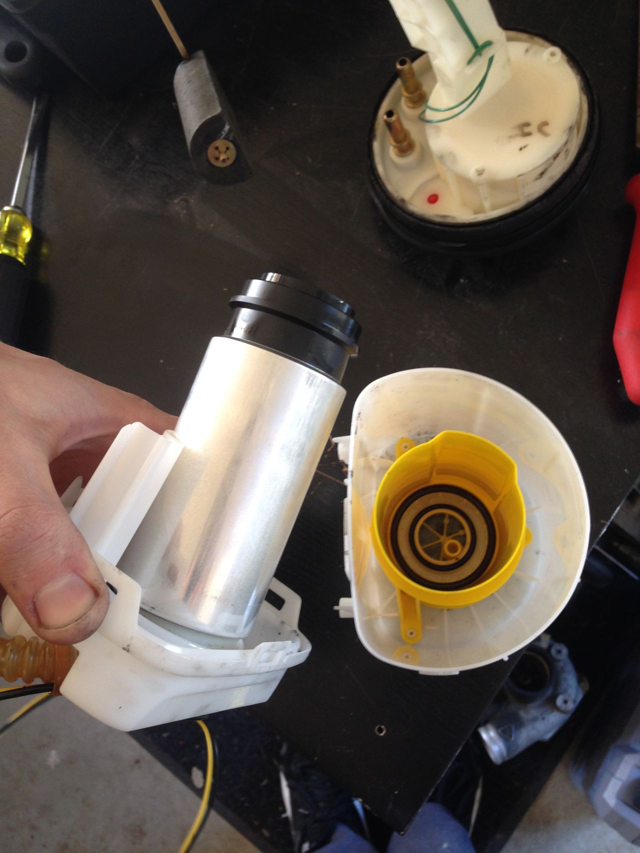

Heres a couple:

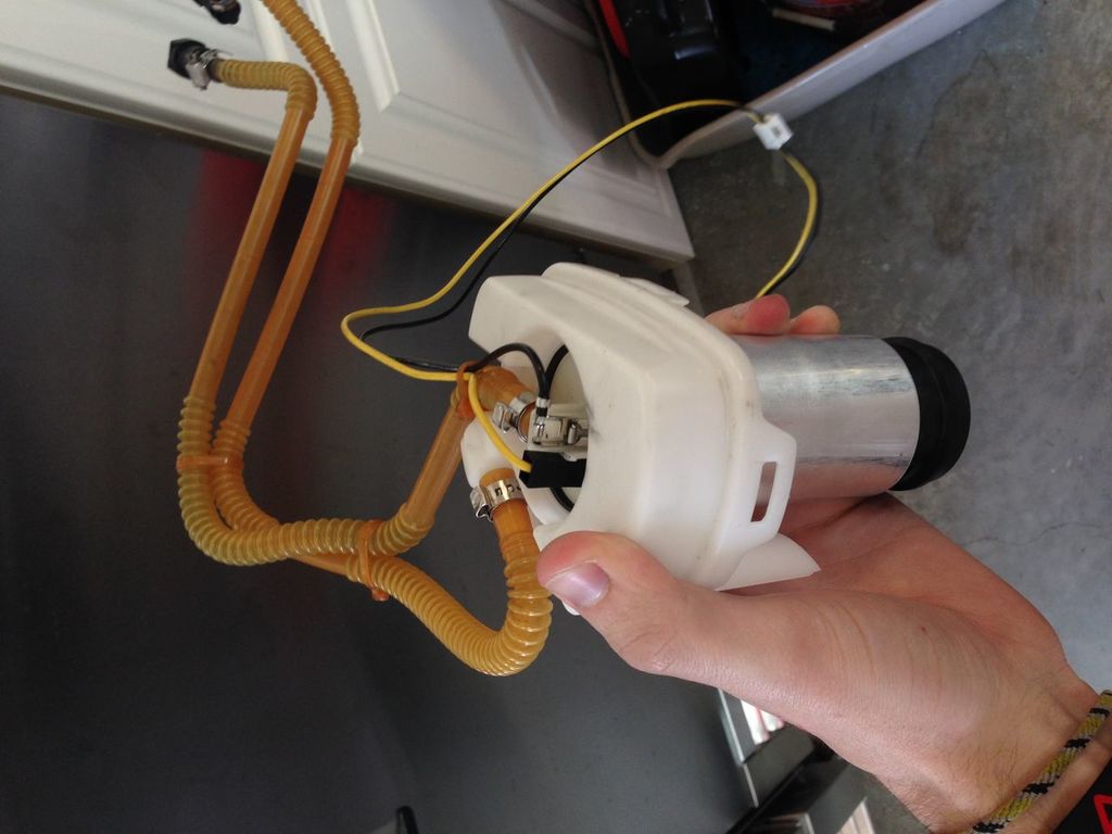

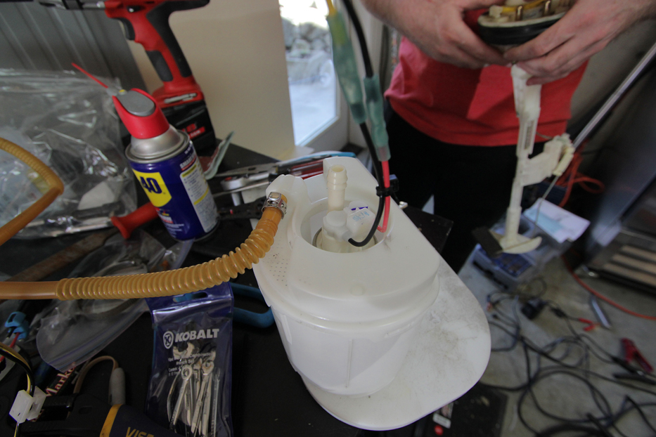

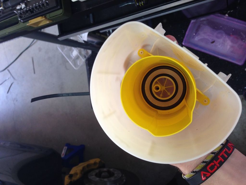

As you can see, the two tubes are just to and from the rails, no recirculating.
Couple more pics:
