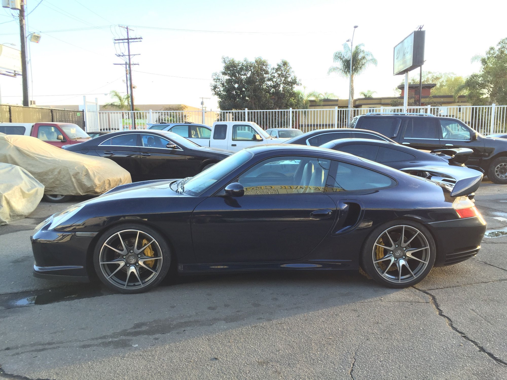

Originally Posted by SamboTT@ByDesign
Haha. Work in progress. Hopefully we will see some real parts in a few days
nice! gt2 parts and ceramic brakes. winning!

It's a turbo with the body parts and stuff on it. But I promise I will not write GT2 on the deck lid! Yes that chassis is the same for GT3, turbo and C4 cars. If you have remove the front Drive stuff it should work. Exactly, and your gas gauge will not be useless below 3/8 of a tank!
