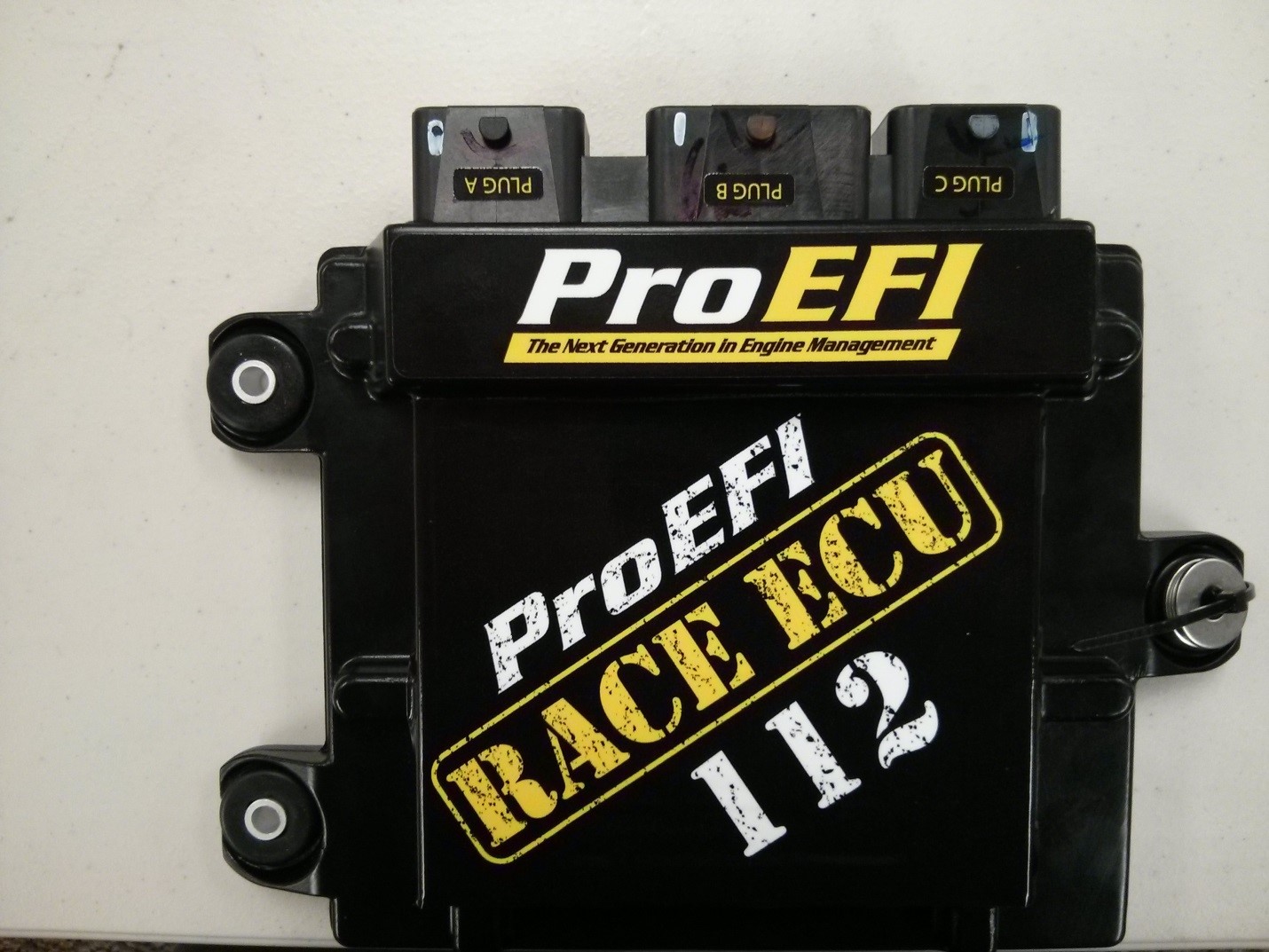

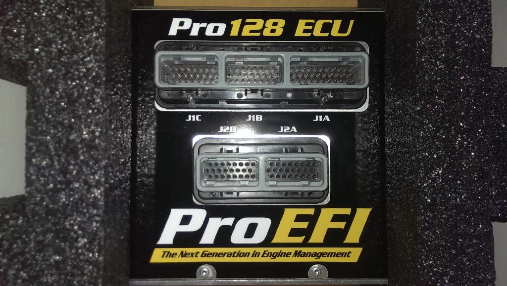

its worth a trip up to garth shop to see exactly how the proefi works. the 112 is smaller than the 128 and it might not be what you want. the 128 has 5 i/o and will handle as many sensors as you want
i don't think the 112 is any faster than the 128 because when it came out i asked garth if i needed to go this route. his reply was mine (128) was bigger and no need to go backwards.

From what I understand ProEFI can be used as either a piggyback or full standalone. Last I spoke to Garth he's setting up my 112 as a full stand alone
prior to the release of the 112 all the 128 setups were running as a piggyback. it was things like fan control for the heat/a/c c/c that held it up as being a full standalone. since the release of the 112 either unit can now be run as full standalone without any use of the factory me .( ic ant speak for emissions as i am still piggyback for now and dme tuned to pass) garth was instrumental in bringing this to the front and the 112 was a great new tool for those to use. it incorporates the cruise control stalk for all the boost, rpm, launch control etc settings so no switches need to be wired up. mine was done prior to this so i have the switches. now its able to be done either way, owners choice
from what i understand the 112 is physically smaller and has 3? i/o were the 128 is larger with 5 i/o. i don't think there any other difference processor wise as the 128 is still the most advanced computer proof sells but i could be mistaken. as i said prior i was ready to make the switch when the 112 came out and garth advised me it was unecessary and a step backwards regarding i/o capability and inj. capability
i know this has devolved into a proefi thread and i apologize to the o/p. heres a couple pics of the 2 units and ill bow out as I'm hugely biased!!
