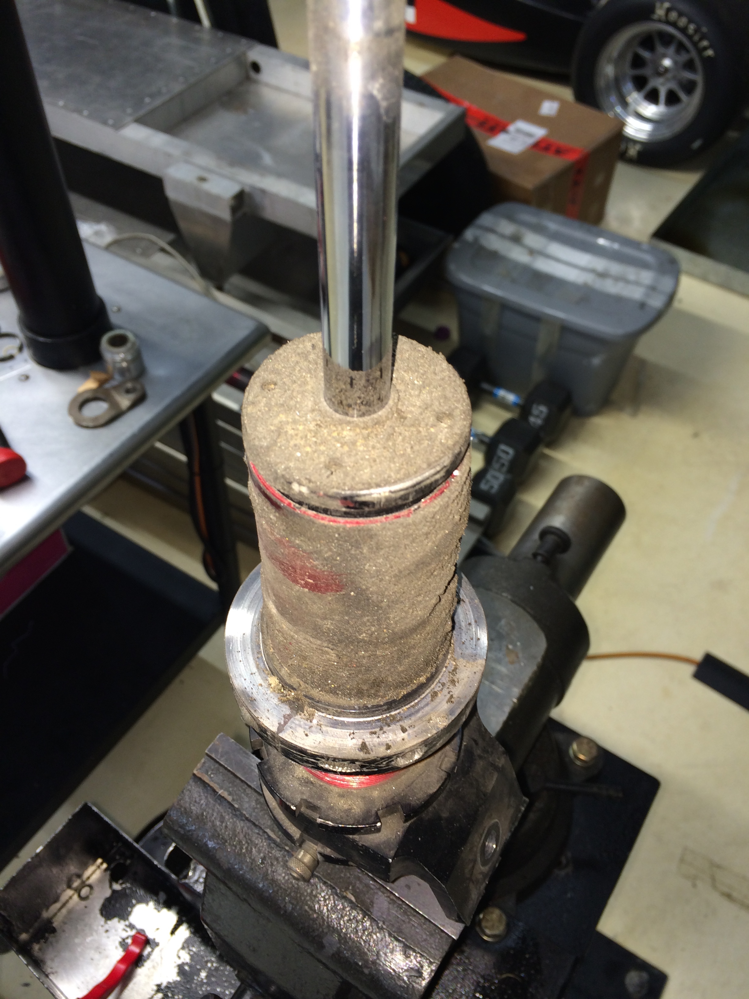

i agree with most of what your saying. once i saw what my coilovers looked like when disassembled it became clear the only thing working on my suspension WAS the springs. the nitrogen had leaked past the seals contaminating the fluid and i had sludge. heres a couple pics. most never see this and my car handled like a honda on cut springs since the day i got it. it wasn't until i installed the rebuilt setup that i found out how amazing these cars can be even for a non turning driver like me. the wavetrac does help but it won't help much if the suspension is shot, just my .02
the shop that rebuilt mine told me coilovers should be rebuilt every 2 yrs! of course these were 7 yrs old and never have they been touched
