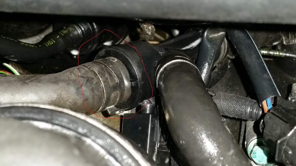

I was doing a leak test today on my car for the first time. I found a leak coming from this hose circled in red. What hose is this, is this a common leak? Can I take off the factory clamp and use a worm gear one to fix it? Looks hard to get at because it is behind the oil filter housing any tips or tricks?
Thanks!

I can't tell which hose that is but I have replaced some of the factory clamps with the worm gear stuff because of boost leaks.

Just tried that, It appears like the black plastic Y fitting is leaking and not the actual hose now. So much for the easy fix!

I have had several leaks from hoses with factory clamp, used worm clamps also and leak stopped, just don't over tighten.

That is not a pressure line Matt. That is a vacuum line providing vacuum to the brake booster in the front of the car. I capped this line off after swapping to the 997GT2 vacuum pump. Hope that helps...

Thanks John, If that is the case I must have a bad check valve somewhere I think..

the check valve just above the plenum is notorious for cracking. if you can pressure test from the turbo inlet you'll hear it hissing. it'll be that obvious. not sure from the pic its the area you've outlined but air box out, and near the plenum. if it is? change them both same time. cheap insurance, and they commonly go bad.

its the black venture valve... replace and do another test

Thanks, I have ordered a new one now.
