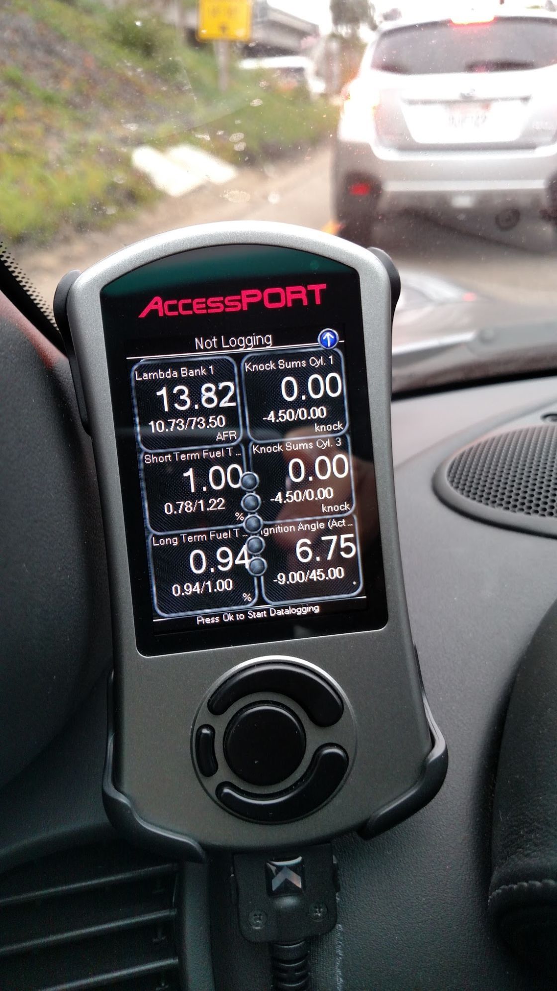

Yes, the Cobb reports short term and long term fuel trims as a deviation from 1.00. So your description is exactly how it works.
Left middle is short term fuel trim bank 1
Left bottom is short term fuel trim bank 2
