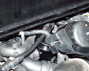

NEW DV INSTALLED
OK, just got the car back with the new DV's replaced by Porsche under warranty...they are black so it is difficult to tell APPEAR to be metal as opposed to plastic....see the pic.
Prior to replacement, I could hit 1.0 bar (only mods are upsolute chip and a little tinkering with the stock exhaust), but it was a stretch and it would only hold for a second, and on the way home from the dealer tonight I hit 1.1 bar in 3rd gear and held it easily. Couldn't repeat due to traffic.

Those look like the stock ones...see my sig...
