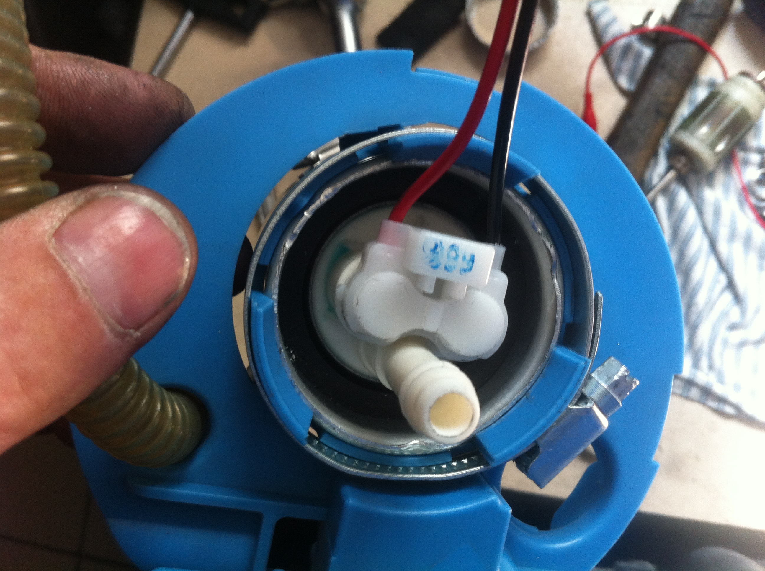

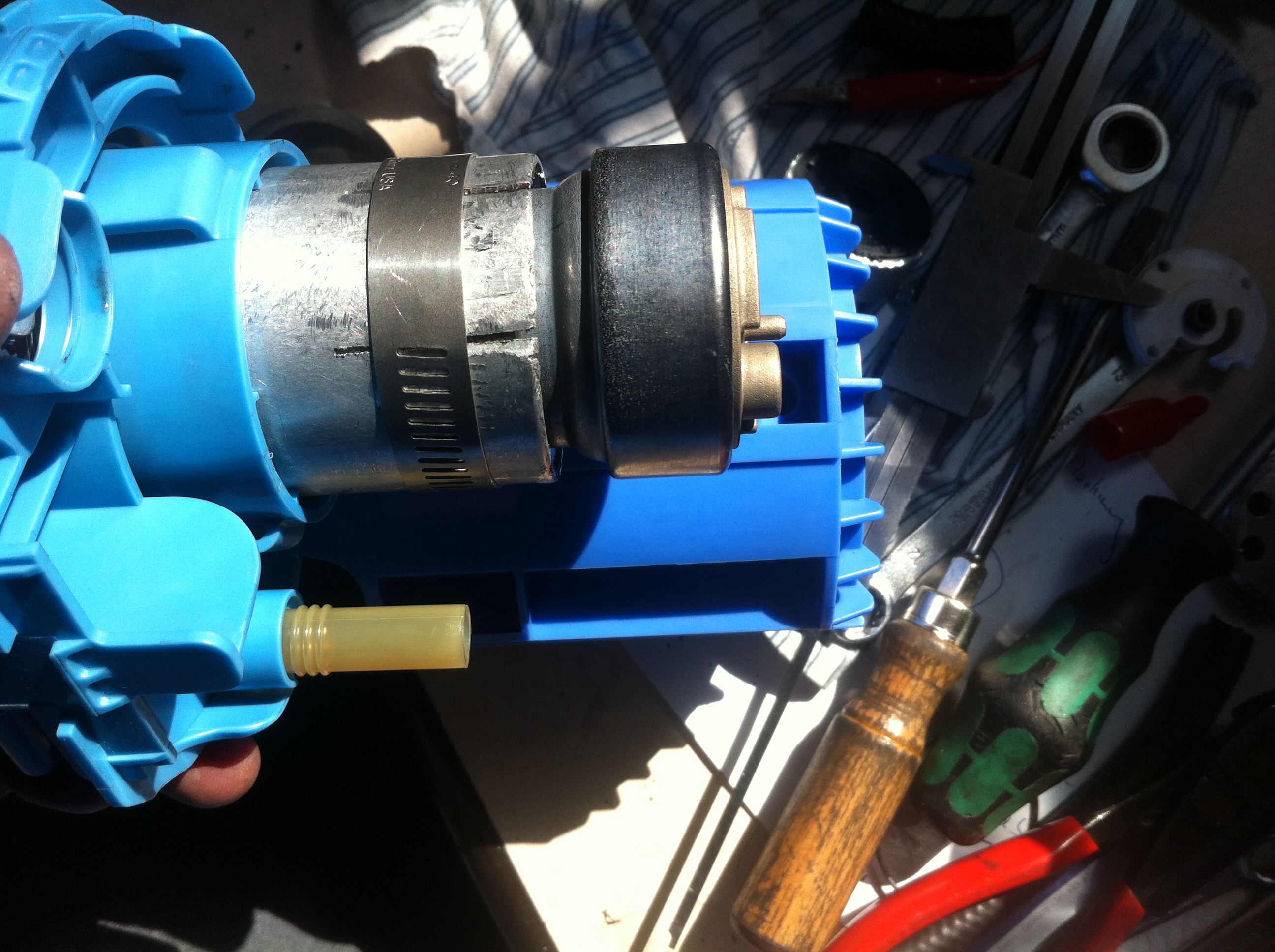

fuel pump after 80000km
inspect fuel pump after 20000km with 5bar and 80000km over all
pump was only able to made 98psi
first picture shows the pump inside the collector was worn out / magnetic stator was lose and made some noises
so time to do a testversion
i use tim´s version and install a walbro 450 intank (excuse my dirt finger`s)
after install i do a log...afrs very good up to 1,5bar boost..pump is able to do more than 120psi ( engine is more powerfull and save)
a very good advice from tim ...thanks

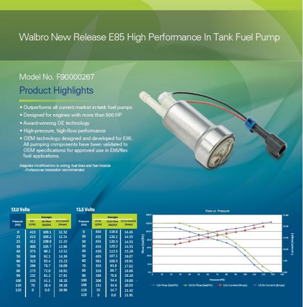

Also the pump flow falls off heavily up top because of an internal pressure valve. With the 5bar reg this will happen at 1.2bar off boost.
You can mod the top of the pump to increase the pressure of the internal valve and stop the drop off. I would recommend this for anyone with a 5bar.
Itguy can provide instructions

Wink
flow range
