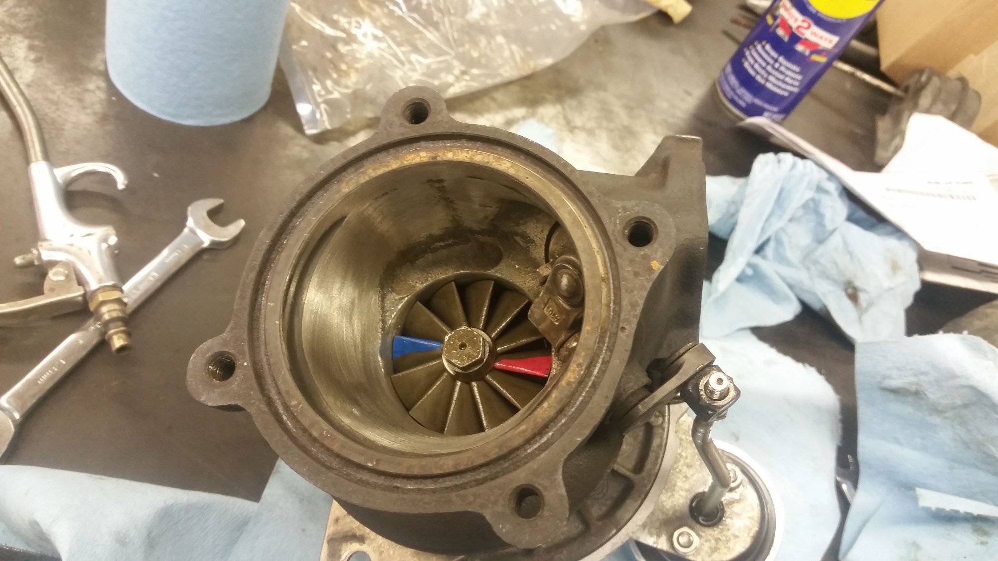

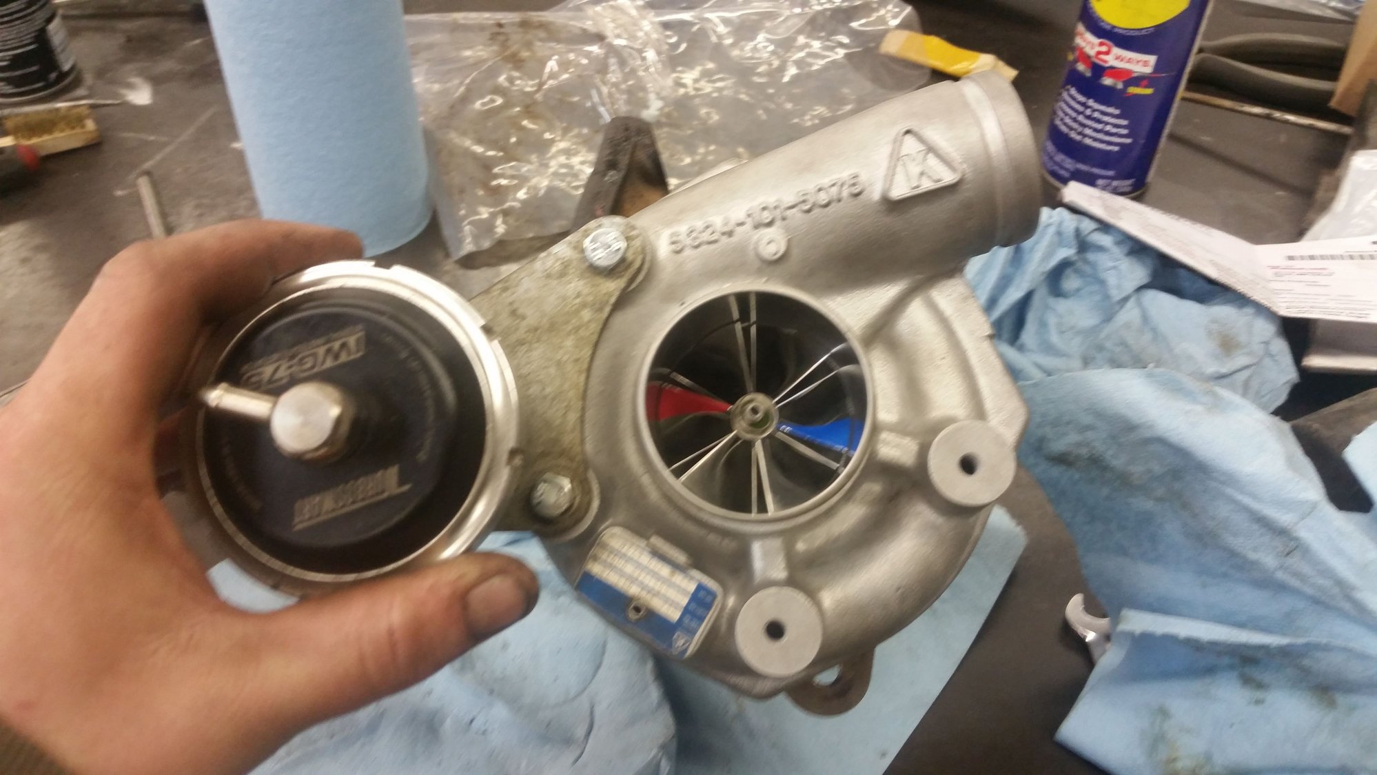

Oh yah, I forgot that you changed the turbine also. This is still on a k16 frame though, right?
Yes k16 frame but the k16 and k24 use the same housings just with different wheel sizes. The k16 turbine does have a weird little hole spot in the outlet the k24 housing does not have. Here is a pic of mine.
