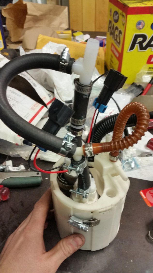

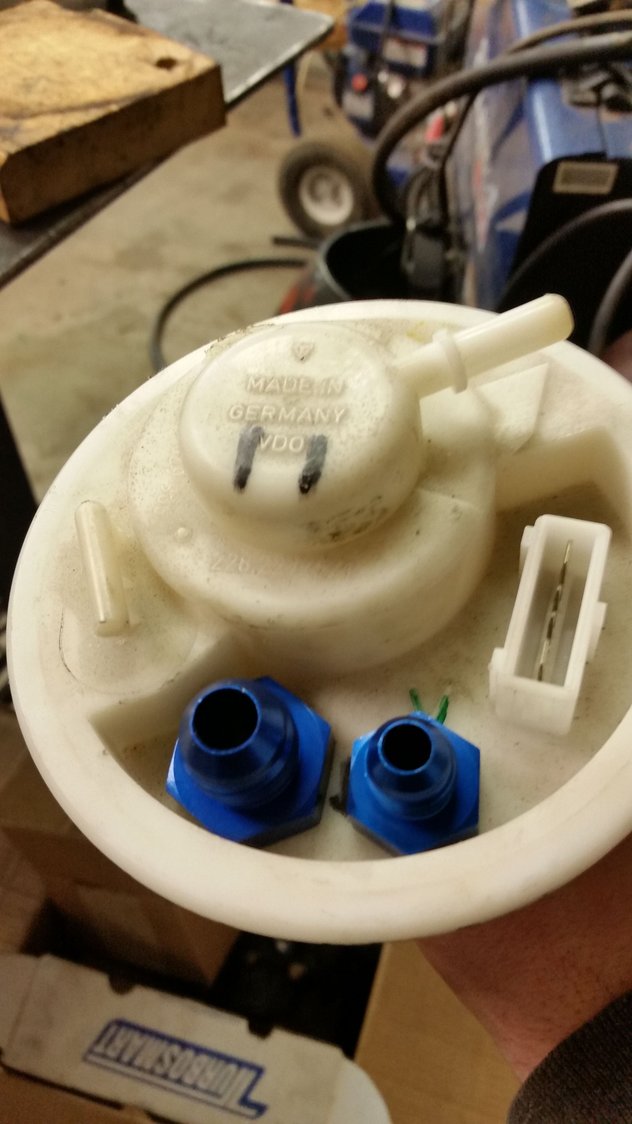

Didn't get as much done as I wanted to and had a ****ty weekend working on the car. Got the intake dual pump system done and in, secondary air pump delete done, coils and plugs installed, bunch on stuff striped thay wasn't needed and my fpr and fuel sensor mount built. Got at least 100 more hours of work to do on the car, maybe more. Next 2 weeks I don't think I'm going to sleep much.

Looking good and I like the clamp in the fuel basket! What I did with a smaller pump was put a clamp around the pump body itself to wedge it in. That was a temp setup until I could get a replacement OEM pump, I like your idea much better! Nice mount for the fuel sensor and regulator too, looks good. Pressure test before putting into the car?
I did actually have to put the clamp end on the inside as yu can't get it back through the hole in the tank with them on the outside. It was a pain getting everything hooked up in the tank though. Had to make a long loop hose to have enough room to be able to connect in to the top hat and not kink the hose. All in all it works but next winter I'll probabaly pony up the cash and go to the srm setup which is much cleaner.

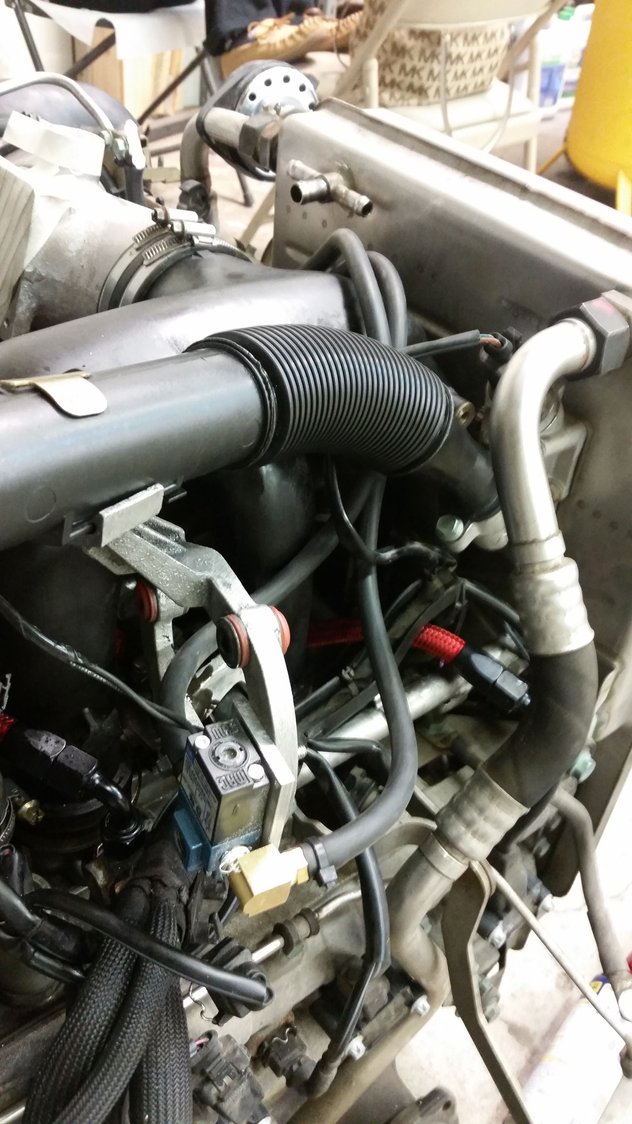

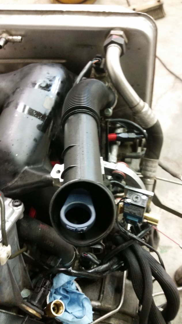

Old Apr 11, 2016 | 07:53 AM
  #37
flewis763's Avatar
Joined: Jun 2015
Posts: 829
From: Fargo, ND
Rep Power: 76
flewis763 has a reputation beyond reputeflewis763 has a reputation beyond reputeflewis763 has a reputation beyond reputeflewis763 has a reputation beyond reputeflewis763 has a reputation beyond reputeflewis763 has a reputation beyond reputeflewis763 has a reputation beyond reputeflewis763 has a reputation beyond reputeflewis763 has a reputation beyond reputeflewis763 has a reputation beyond reputeflewis763 has a reputation beyond repute

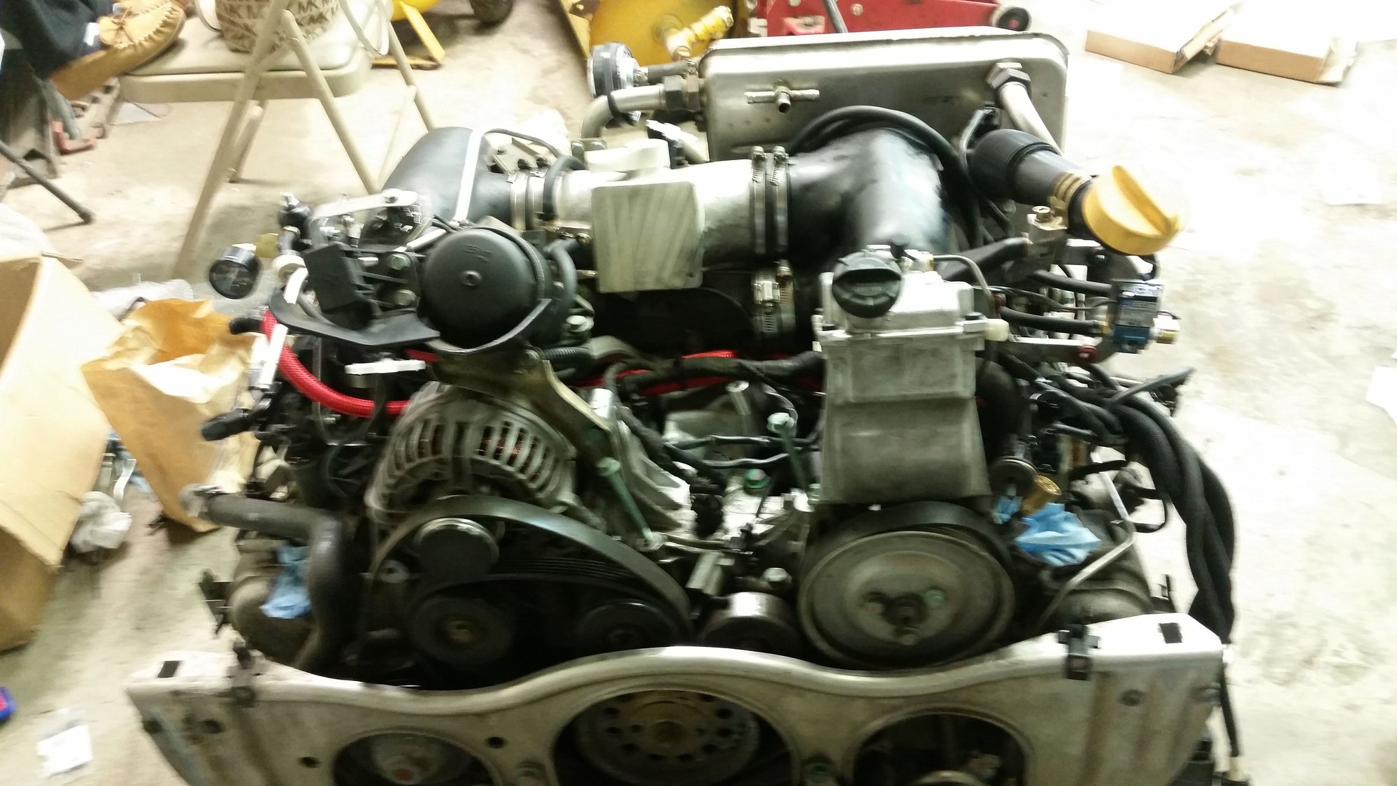

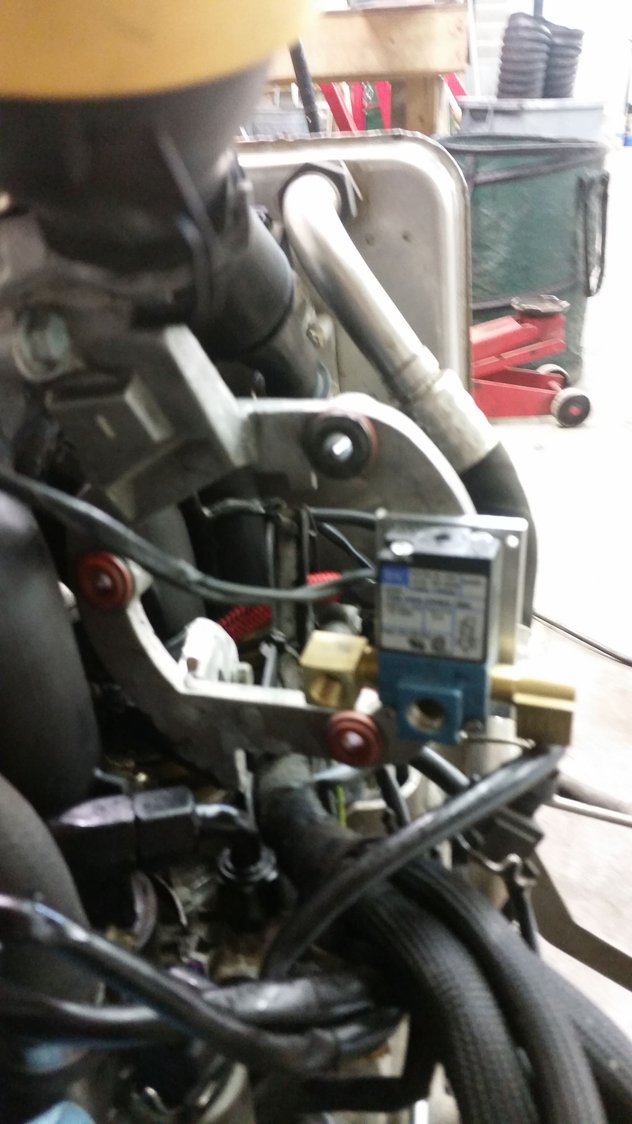

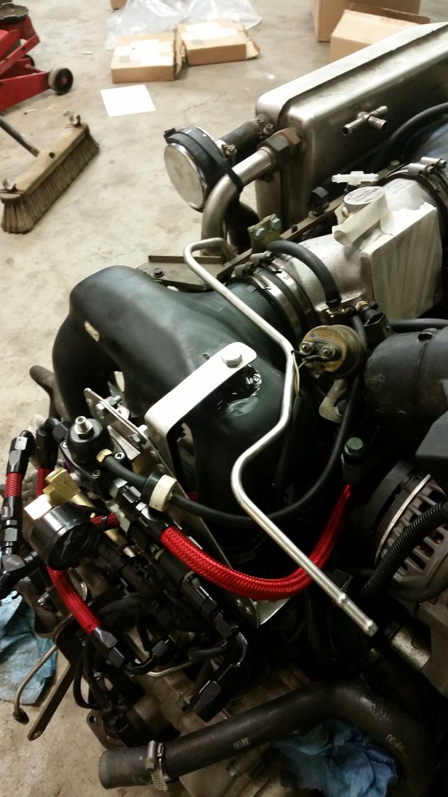

This weekend I didn't get as much done as I wanted but made good progress. Finished the fuel system, did the vac reduction, mounted my boost solenoid of the other air pump brackets, coolant pins, manual dipstick, and a few more things. By the end of today hopefully I have the turbos on, clutch off, and everything else on the engine don't and bolted up to the trans

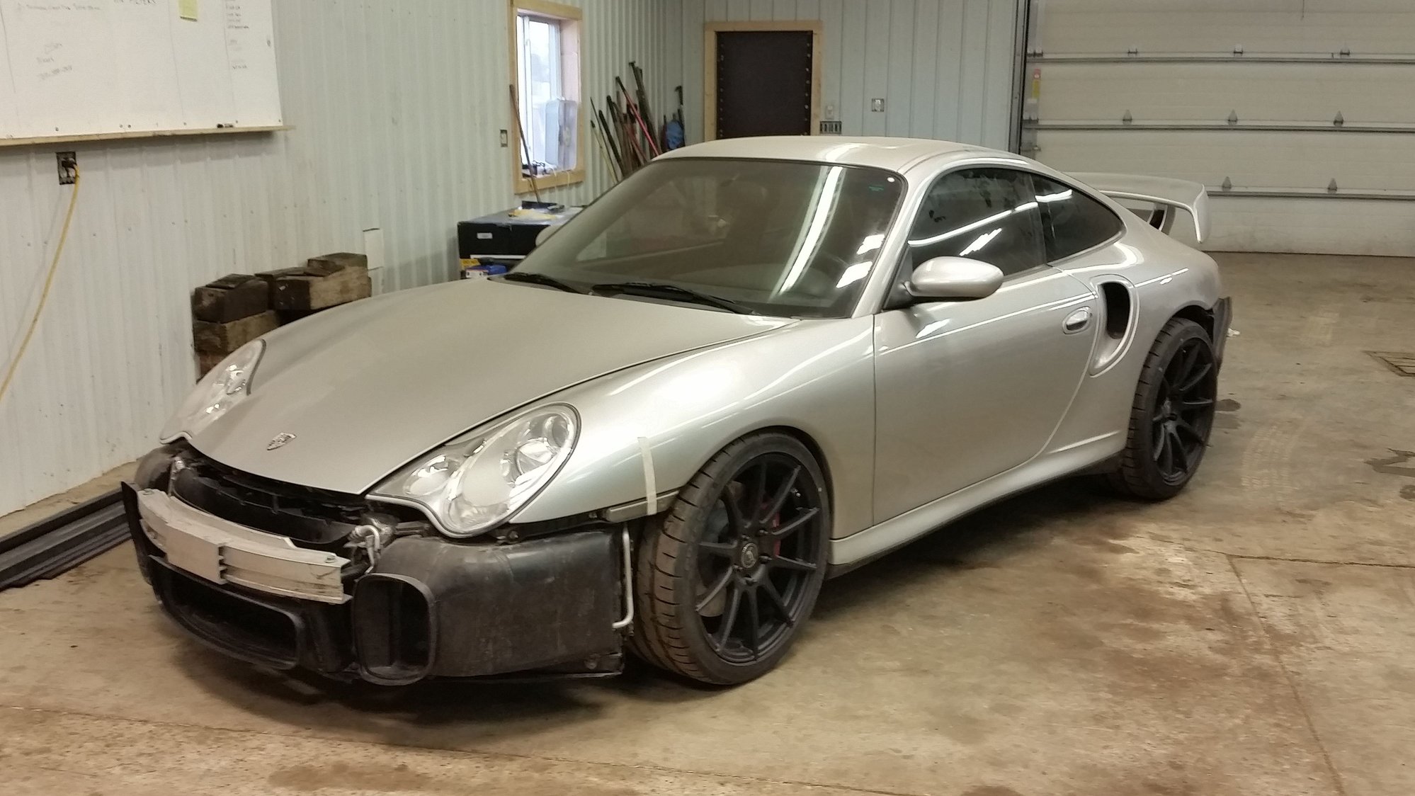

Originally Posted by MadWhip
looks GOOD
Thanks. Here are a few more pics just for fun.

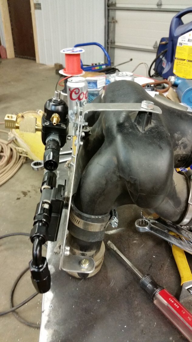

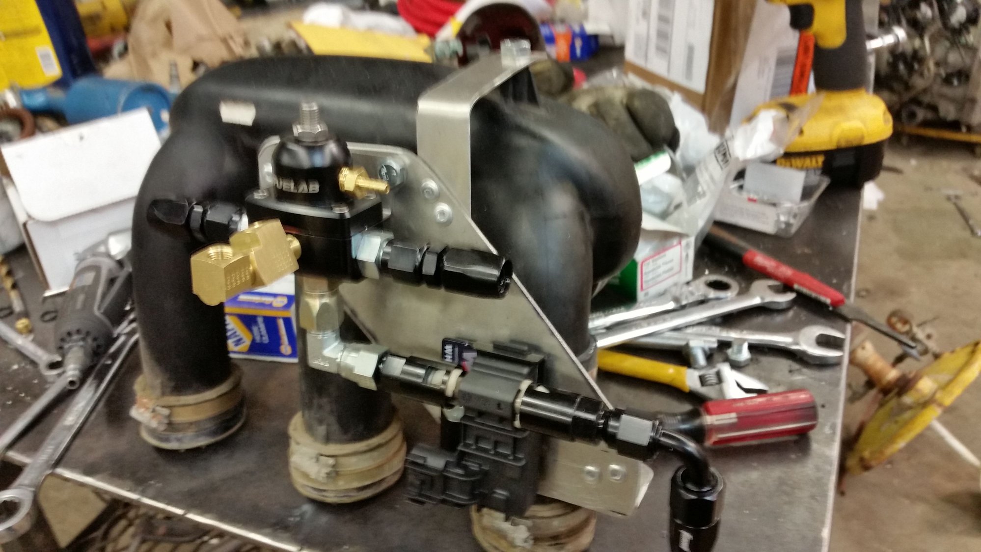

Getting there man!! Looks great!! just curious Freddy... I noticed you're running modified stock fuel rails...did you pressure check them?
Old Apr 11, 2016 | 08:35 PM
  #43
flewis763's Avatar
Joined: Jun 2015
Posts: 829
From: Fargo, ND
Rep Power: 76
I got them from Steve (32krazy). The came off his car Scot so they do not leak. I'm going to pressure check the system before putting the motor though

I'm pretty sure you do not want to run a one way check valve in your fuel pressure reference line. It needs to see both boost and vacuum. Like the oem one.
Old Apr 11, 2016 | 11:53 PM
  #45
BLKMGK's Avatar
Posts: 2,949
From: Virginia
Rep Power: 575
BLKMGK Is a GOD !BLKMGK Is a GOD !BLKMGK Is a GOD !BLKMGK Is a GOD !BLKMGK Is a GOD !BLKMGK Is a GOD !BLKMGK Is a GOD !BLKMGK Is a GOD !BLKMGK Is a GOD !BLKMGK Is a GOD !BLKMGK Is a GOD !
Good catch, I didn't notice that! If that's a check valve and not a filter get it out of there, he's right!
