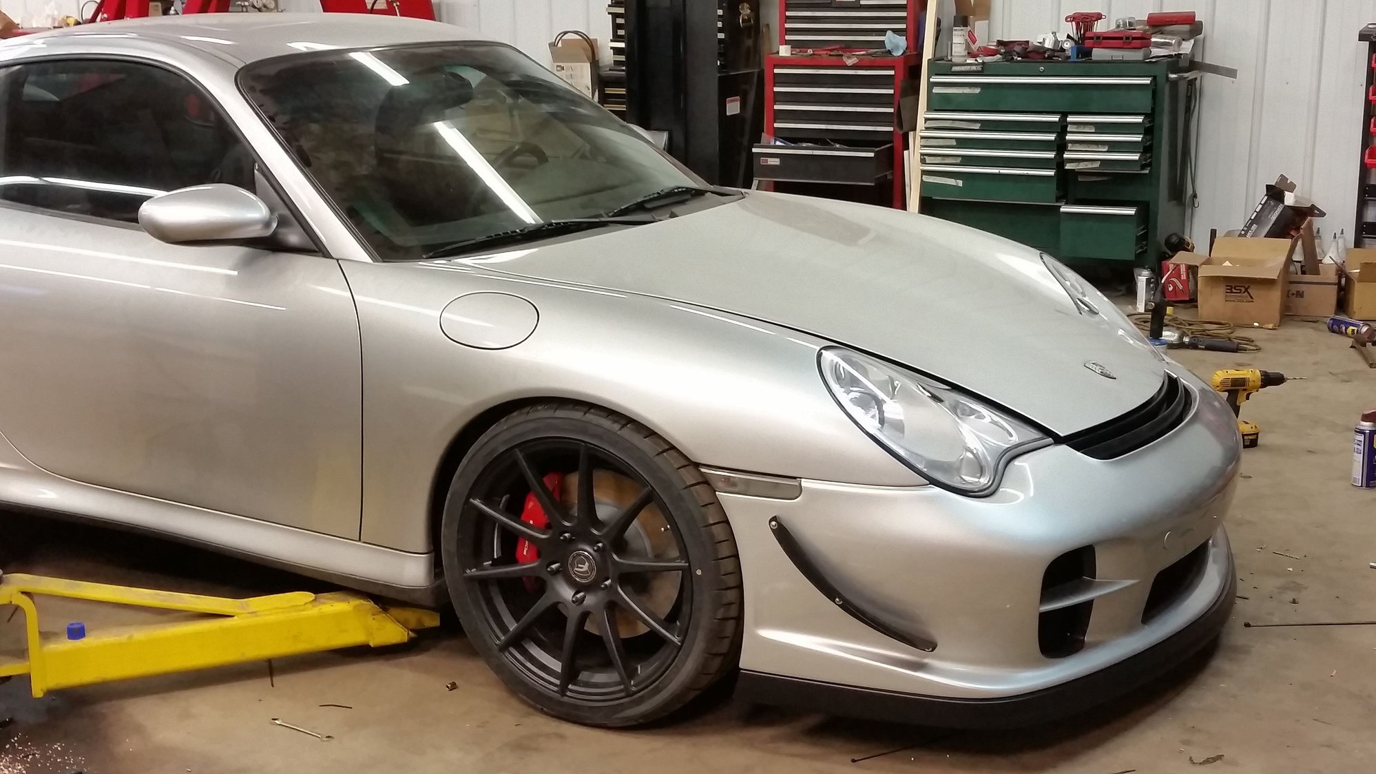

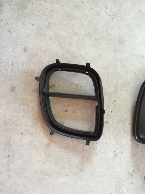

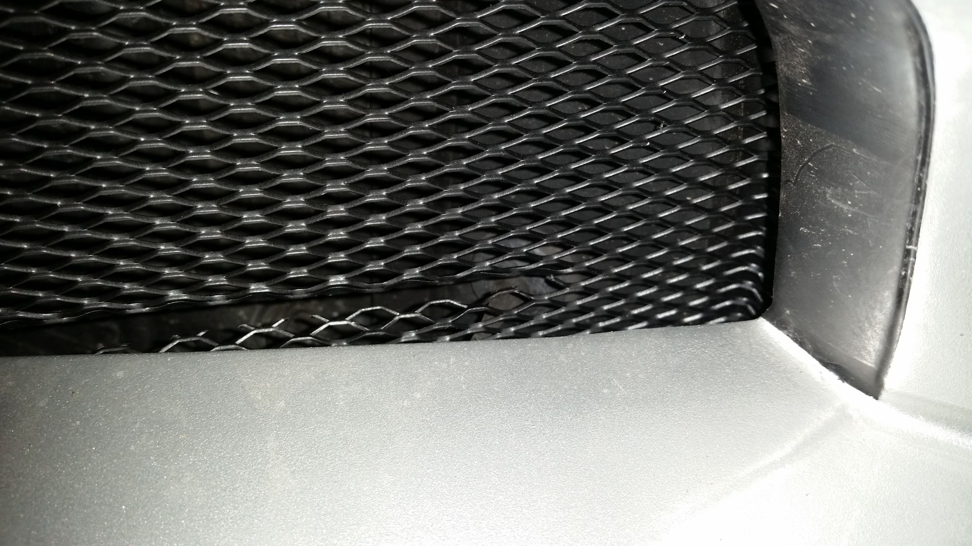

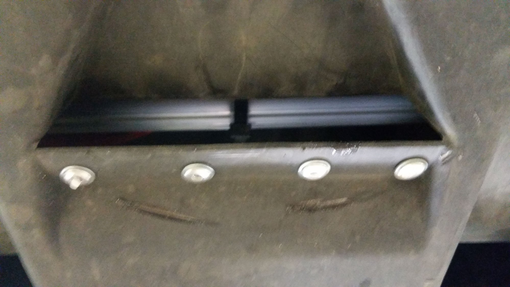

Ya I bought them from rennline not realizing they are designed to fit only the oem gt2 bumper. With the bumper on the center sits flush on the bumper but the side vents there is a space between the bumper and the screen

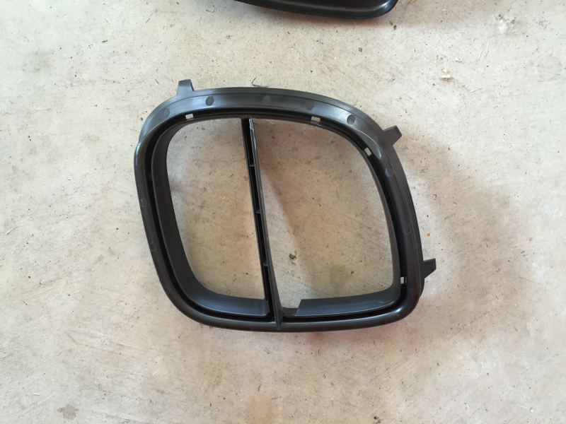

Do you have these pieces installed on the ducting? It goes between the bumper and the air duct

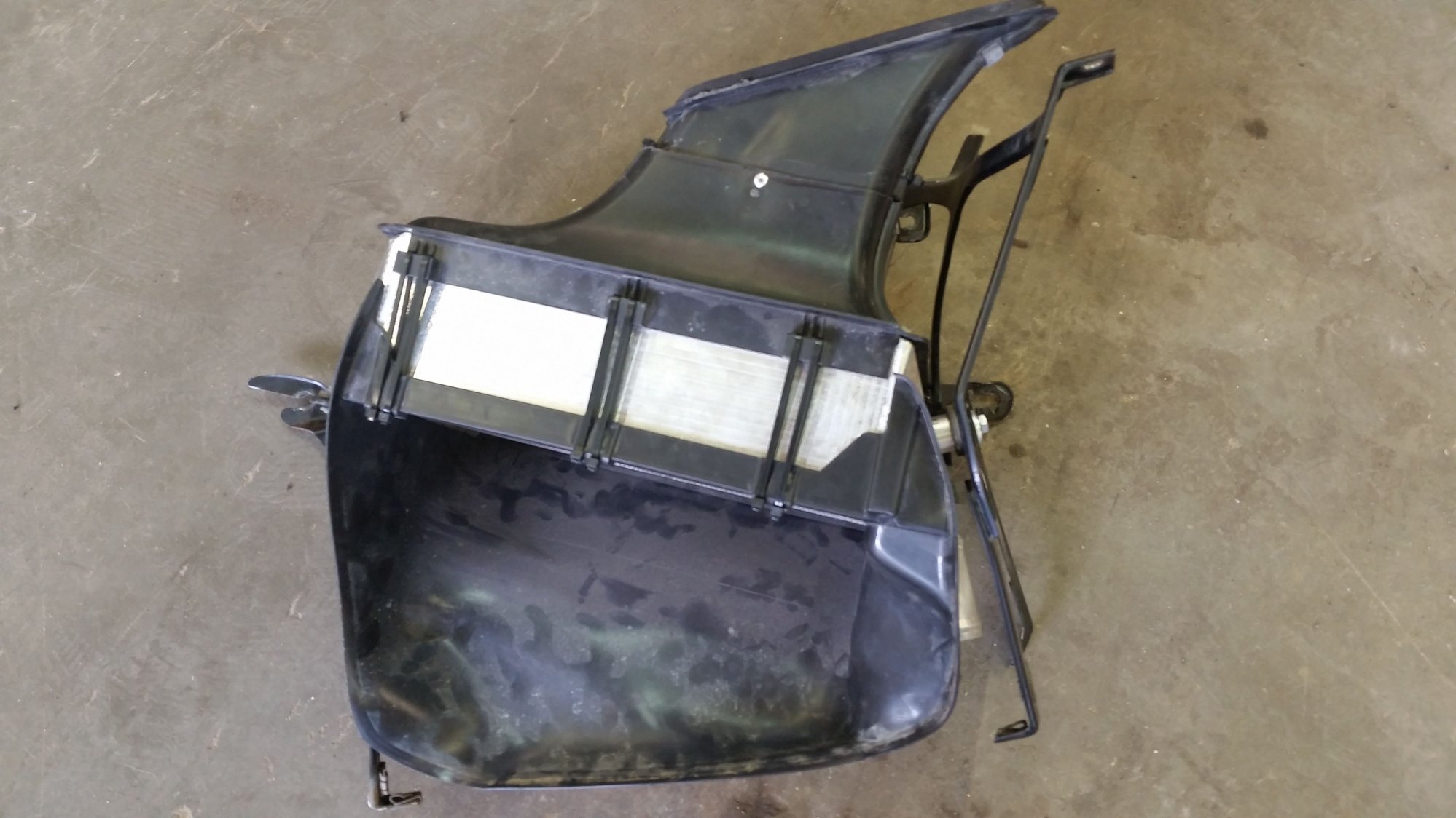

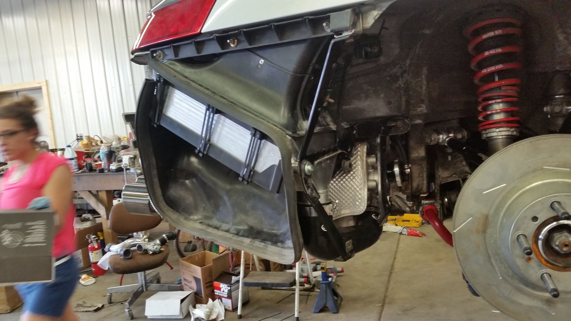

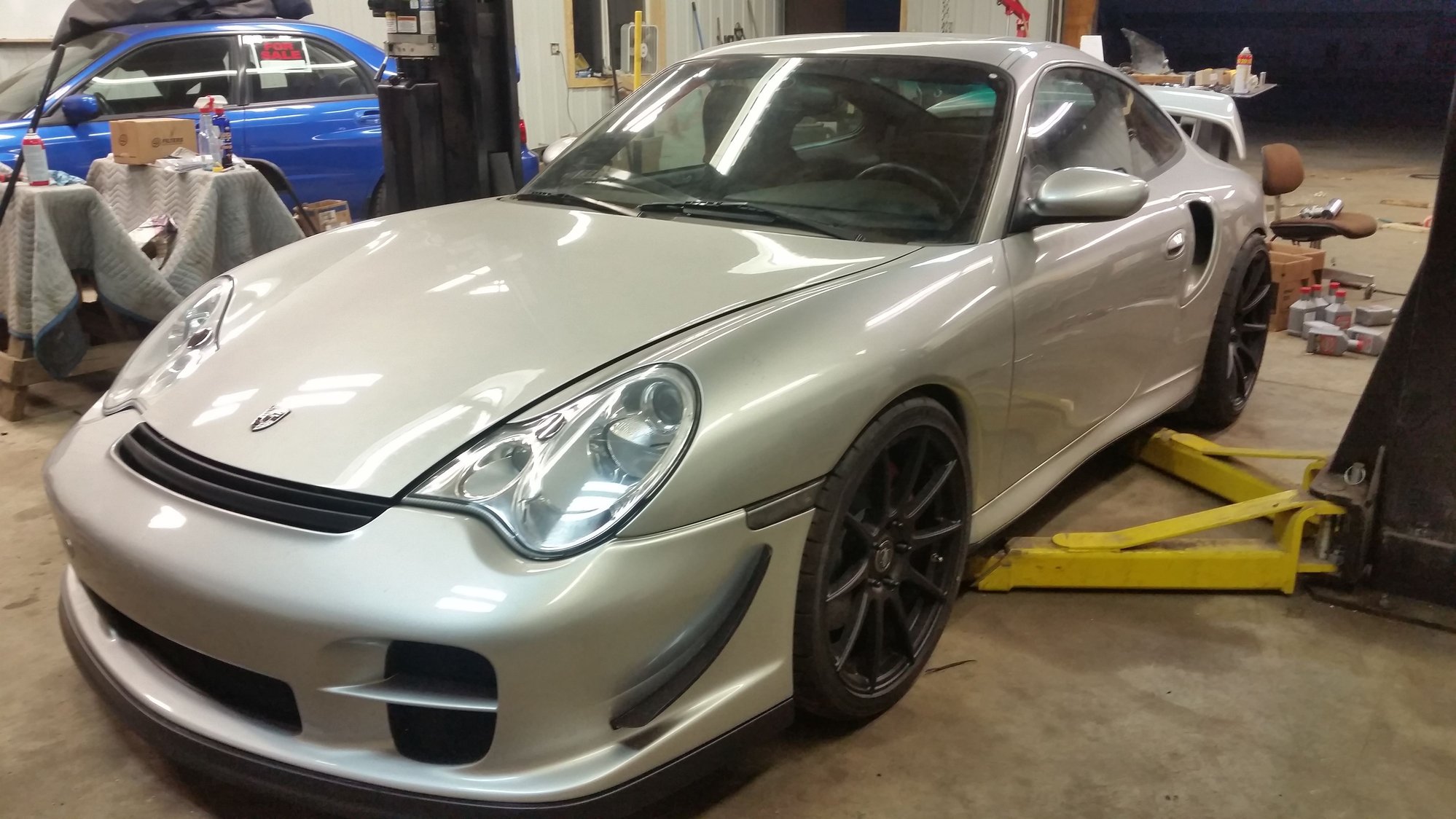

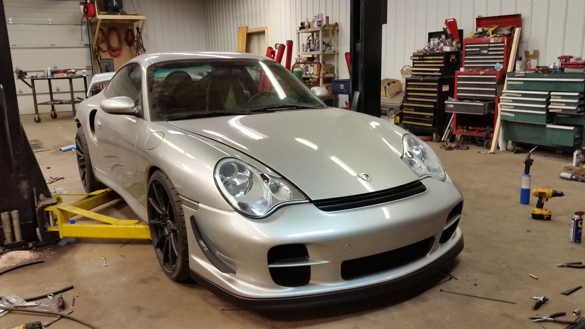

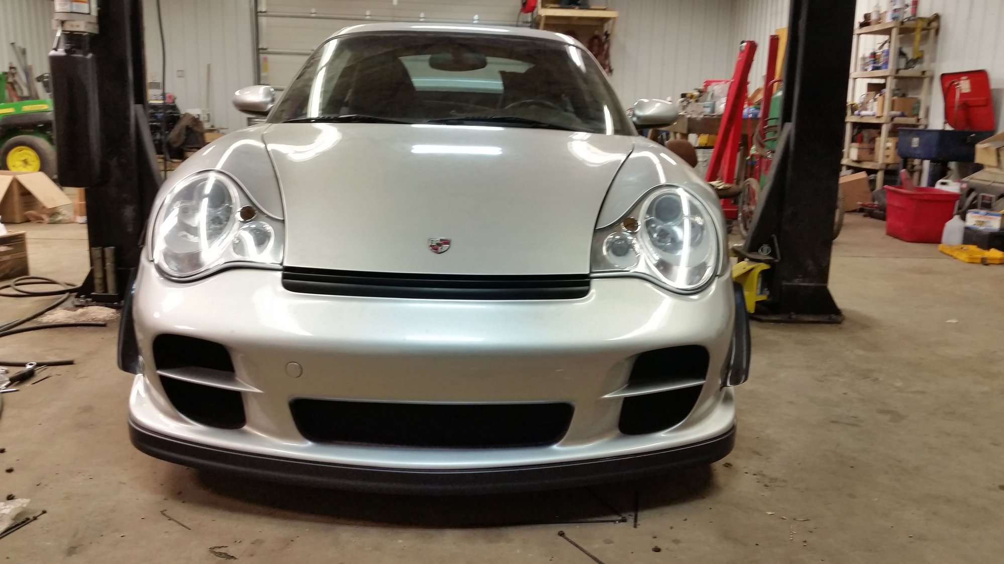

We talked about those saturday. I don't but should get them eventually. Here I what it looks like right now which again is still better than nothing there. Also some shots with the bumper on.
Old Apr 25, 2016 | 08:04 AM
  #79
32krazy!'s Avatar
Joined: Dec 2008
Posts: 5,551
From: tn
Rep Power: 628
Thats likely why the screens dont fit well
Didn't even know those vents existed until after I bought the kit. As some right now I don't want to pull the bumper back of as I already sealed arundel the headlights. I will get them eventually though and make it right.

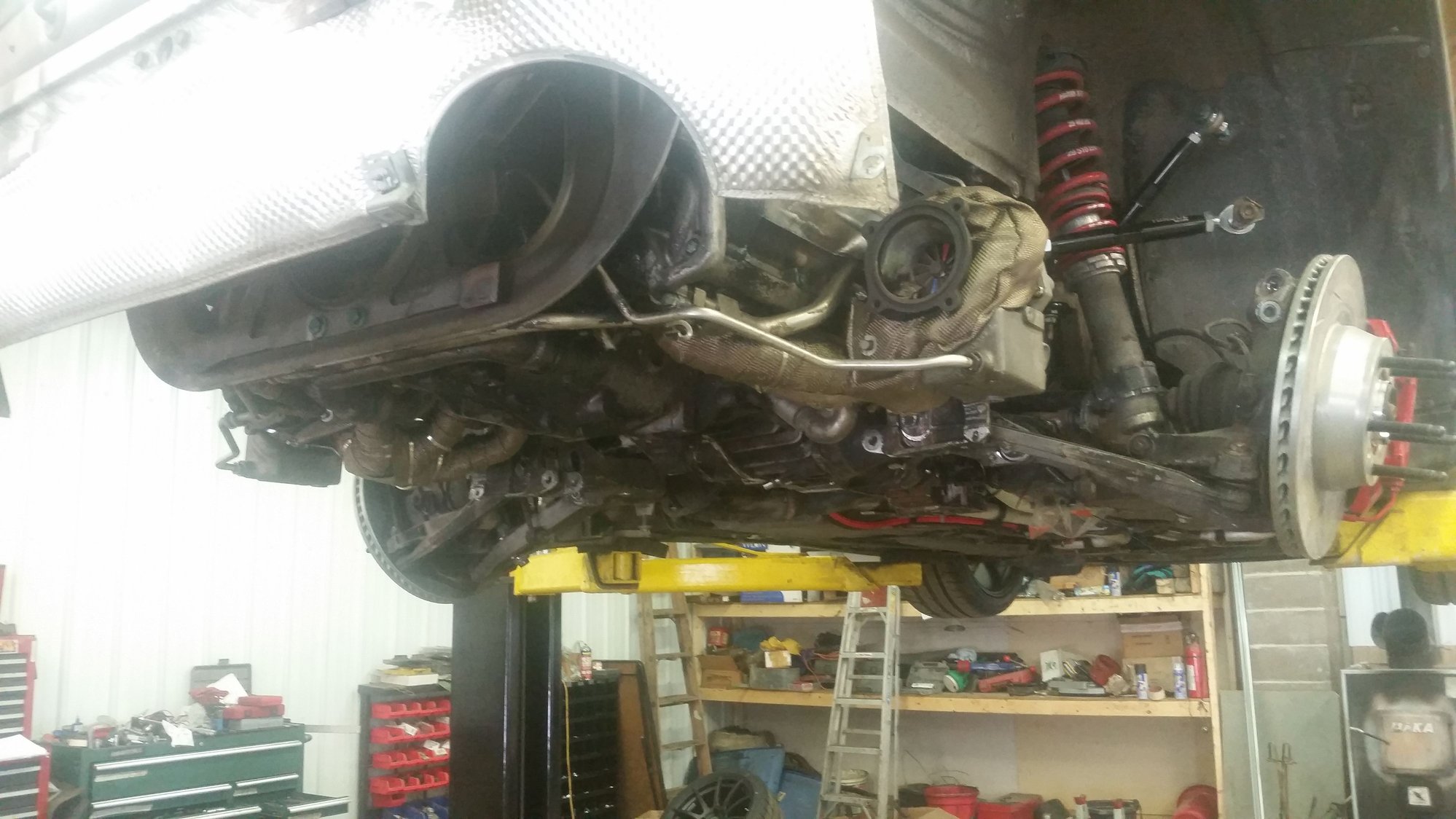

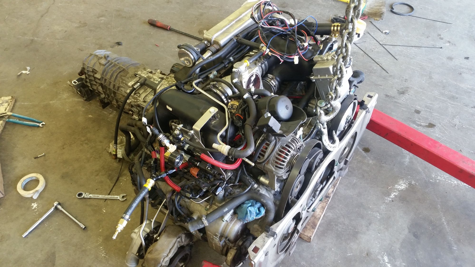

Well after 6 weeks on the road and basically home for 1 night, I got some work done this weekend but has set backs of course. Engine and trans are in with the new mounts. Fuel system is all complete and hooked up. Wiring is 90% done.
Problems now with my intakes. Filters I bought are to large, ordered smaller one this morning. Going to make that work for this year and come up with a new idea I think this winter.
Waiting on my 4.5 intercoolers from sean at srm and still have to weld the exhaust together. Also have to put the gt2 clutch master and spring in and bleed that.

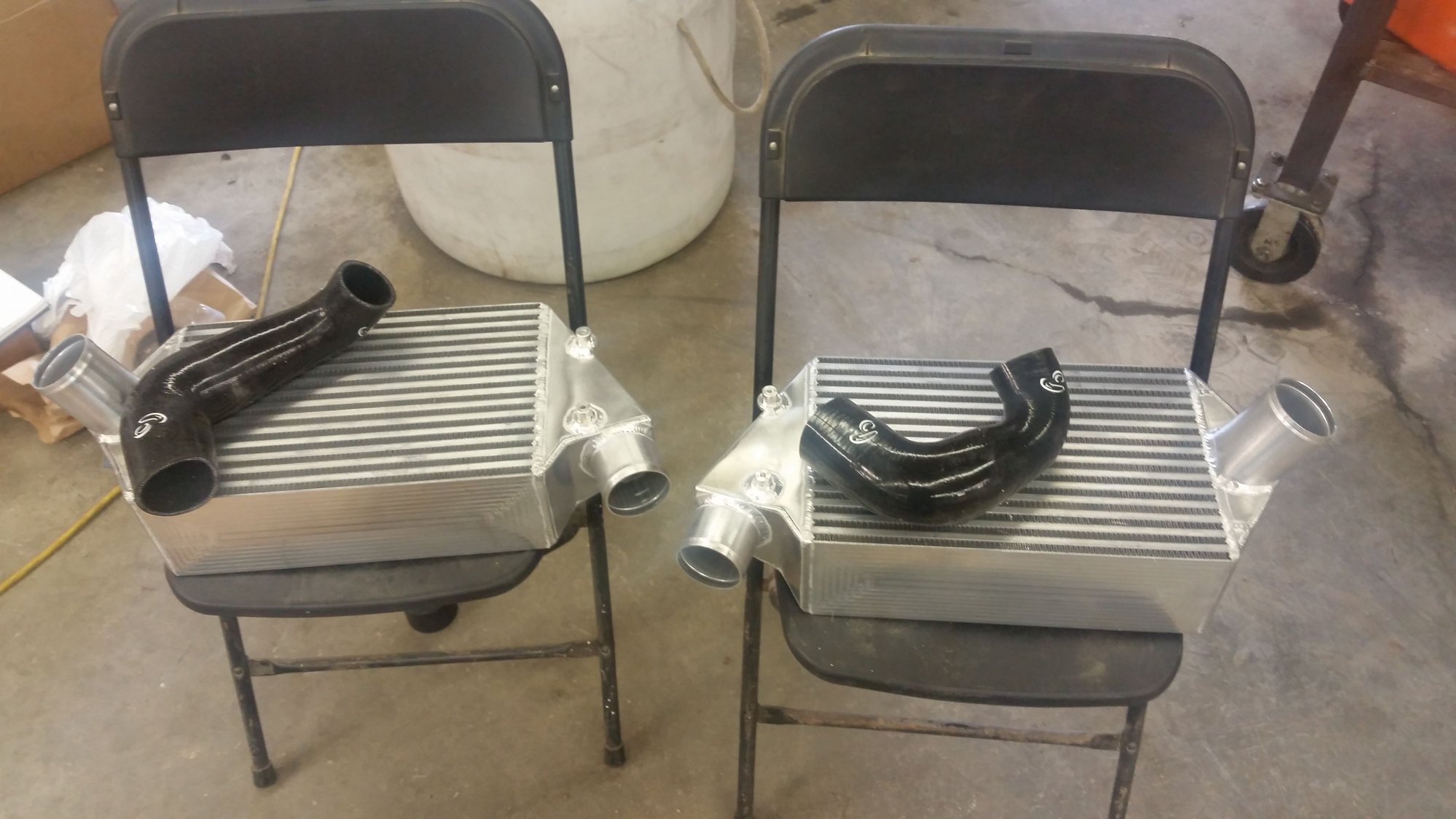

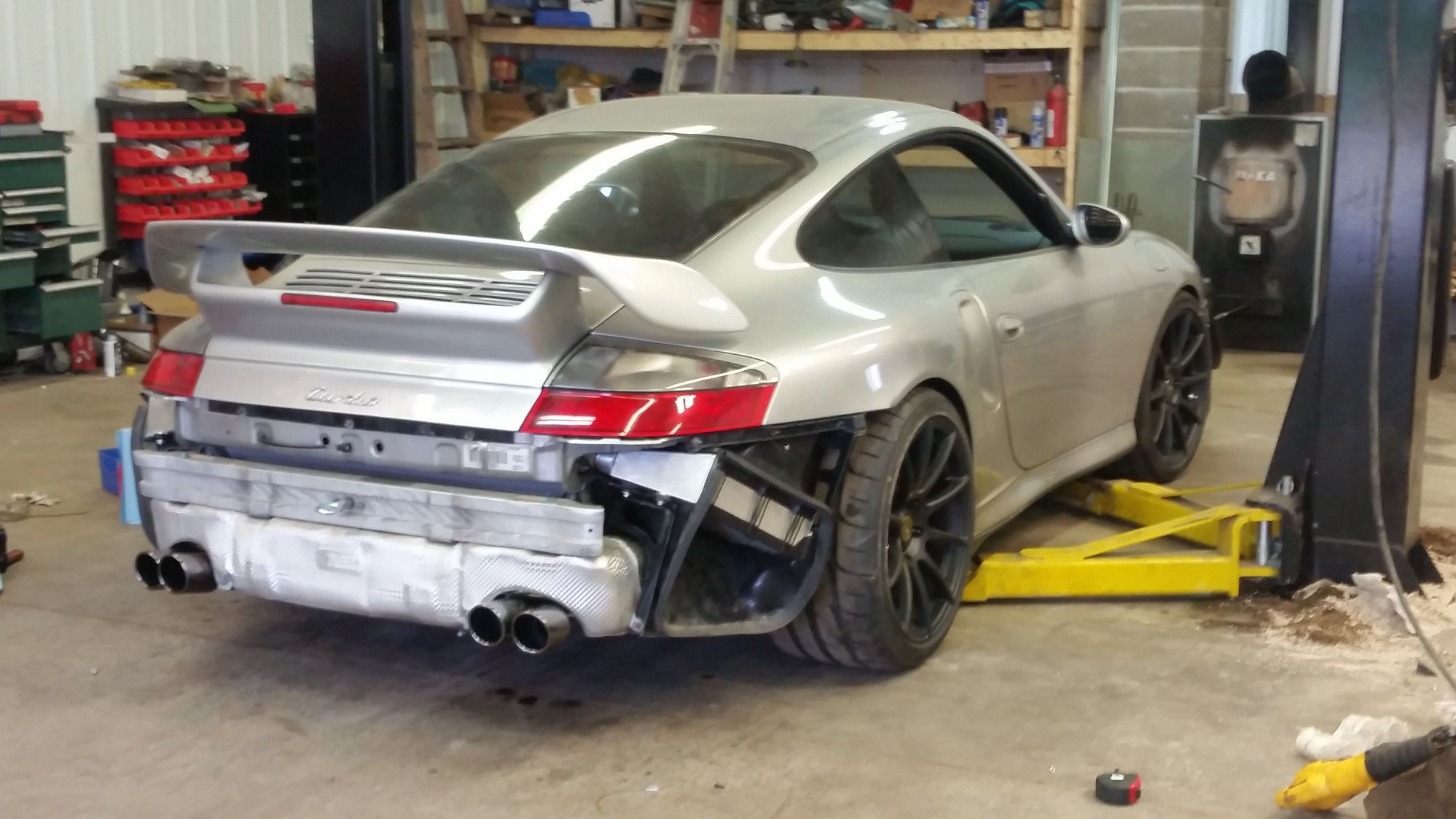

Will thought I was going to be able to finish the car over the weekend and today but just a little short. Overall I got a lot done though.
Built the exhaust, turned out ok, not as nice as I'd like it to have been. Also mig welded it because I didn't have time to tig it.
Ecu and wiring is 100% done
Srm 4.5 intercoolers in and shrouds modded

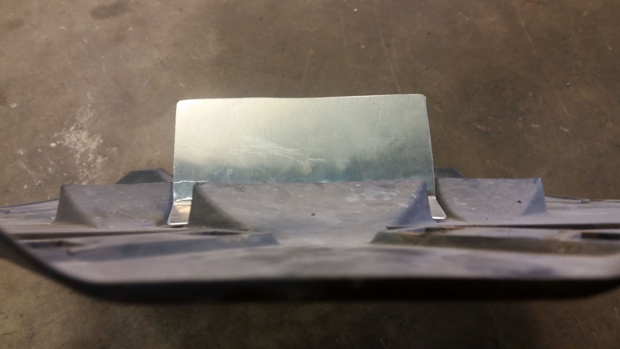

Scoop for my fuel cooler worked will with the factor diff vent.
Alignment is done
All I have left is install the y pipe, rear undertray, fender liners, and remount the air intakes. Then tuning.
