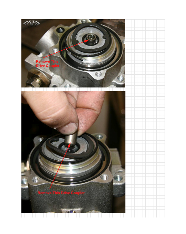

You need to disassemble and remove the coupler from the power steering pump. This often gets overlooked.

Description or pics? Need to do this I guess.

Just take it apart and you will see how it works. There is a coupler that connects the two parts of the pump that you disconnect. You have to block off the line openings also. I had a hard time finding plugs that fit. I finally took the line out plugs and welded them shut and put them back in.

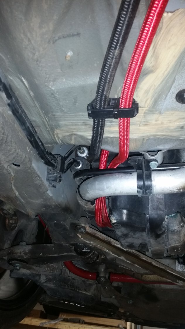

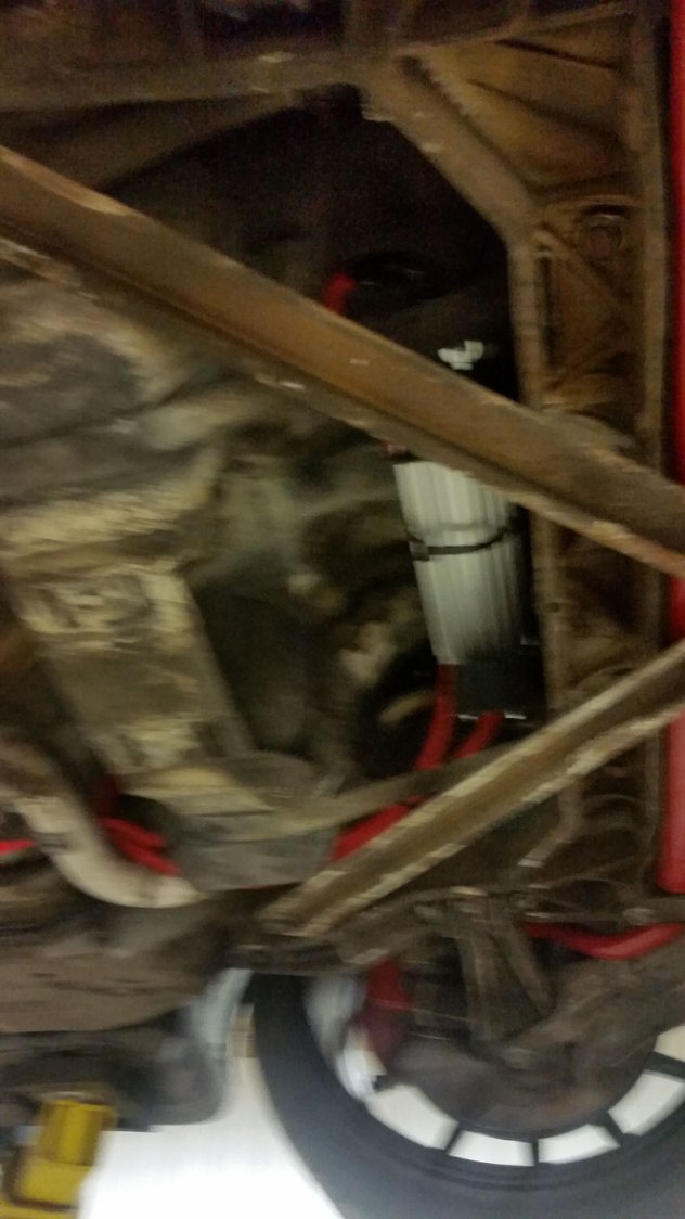

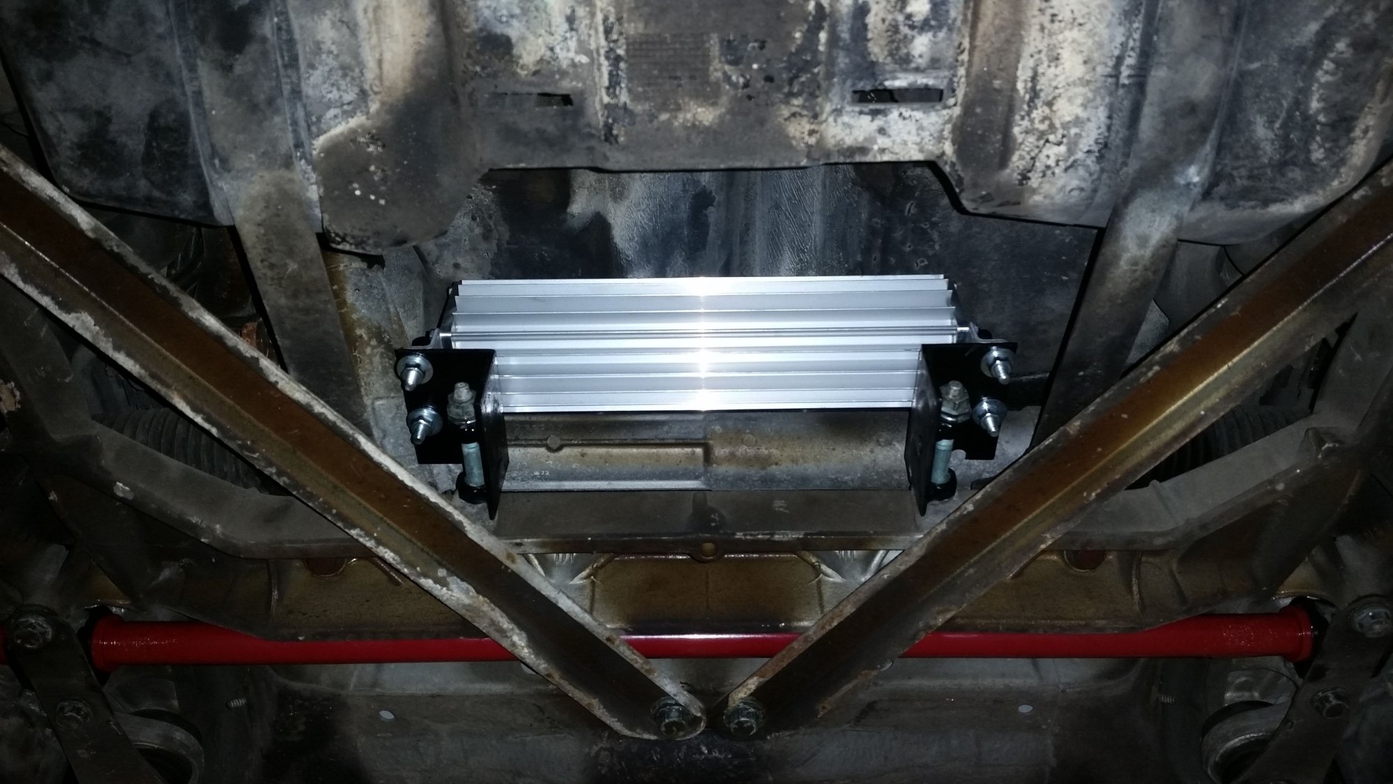

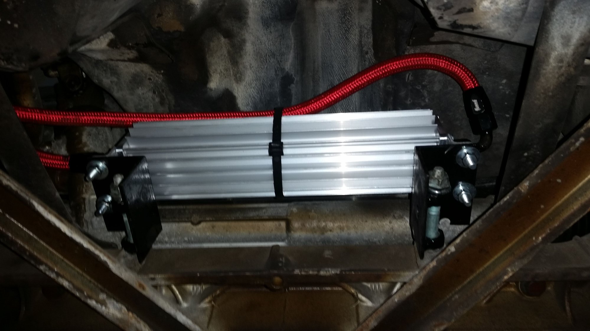

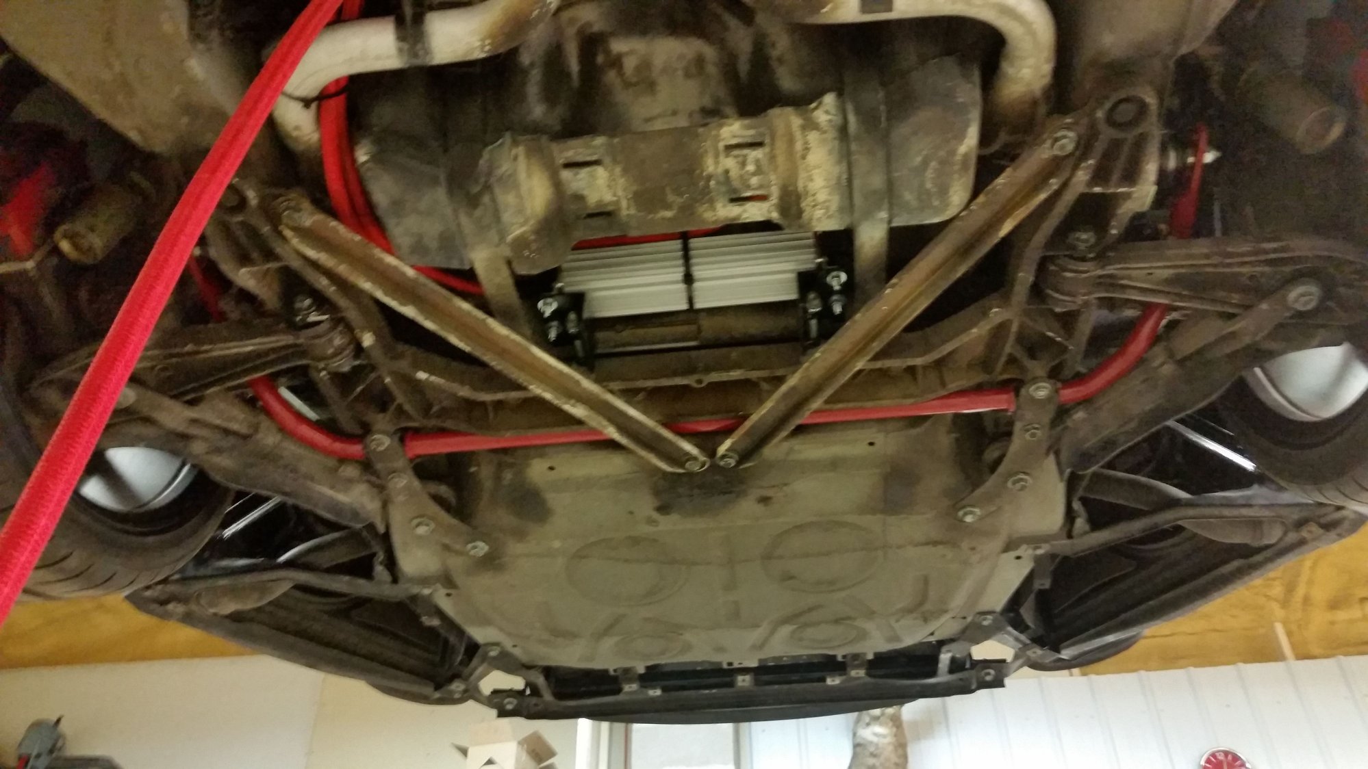

Well got a bunch of stuff done this weekend. Finished the fuel system including the cooler. I still have to make a vent for the cooler. Got the front bumper back on, bunch of wiring done. Vents screens on as well. Still so much to do thought and not enough time to do it.
