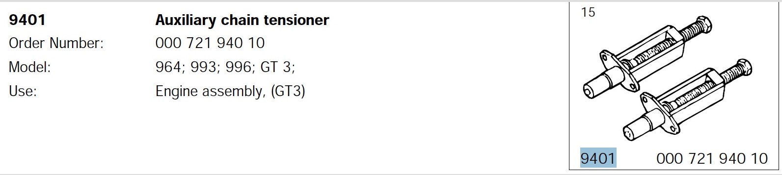

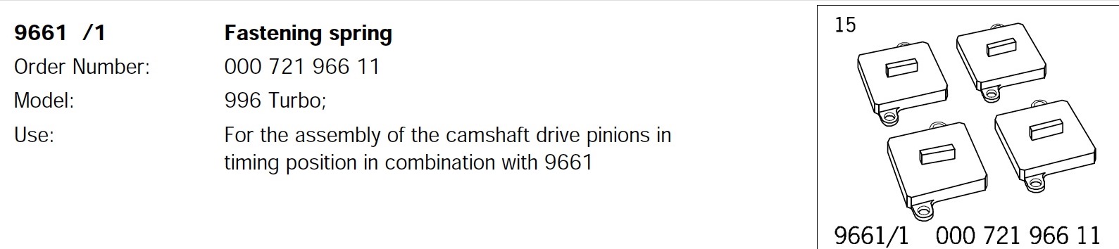

That's frustrating. Same thing happen to me 2 years ago. We took out the engine from mtlsp (a member here) and got it to a Porsche specialist for a rods replacement...This guy do mostly air cooled engines. After we reinstall the engine we had cam sensor fault ;-( Later we found out he made a mistake timing the cams.... Strange because I ask him at the beginning if he had the plates to time the cams and he show me the exact Porsche tool!!!!
Name:	Screen Shot 2017-08-03 at 08.54.54.jpeg
ID:	505644   Click image for larger version
Name:	Screen Shot 2017-08-03 at 08.55.33.jpeg
ID:	505645   Click image for larger version
Name:	Screen Shot 2017-08-03 at 08.55.42.jpeg
