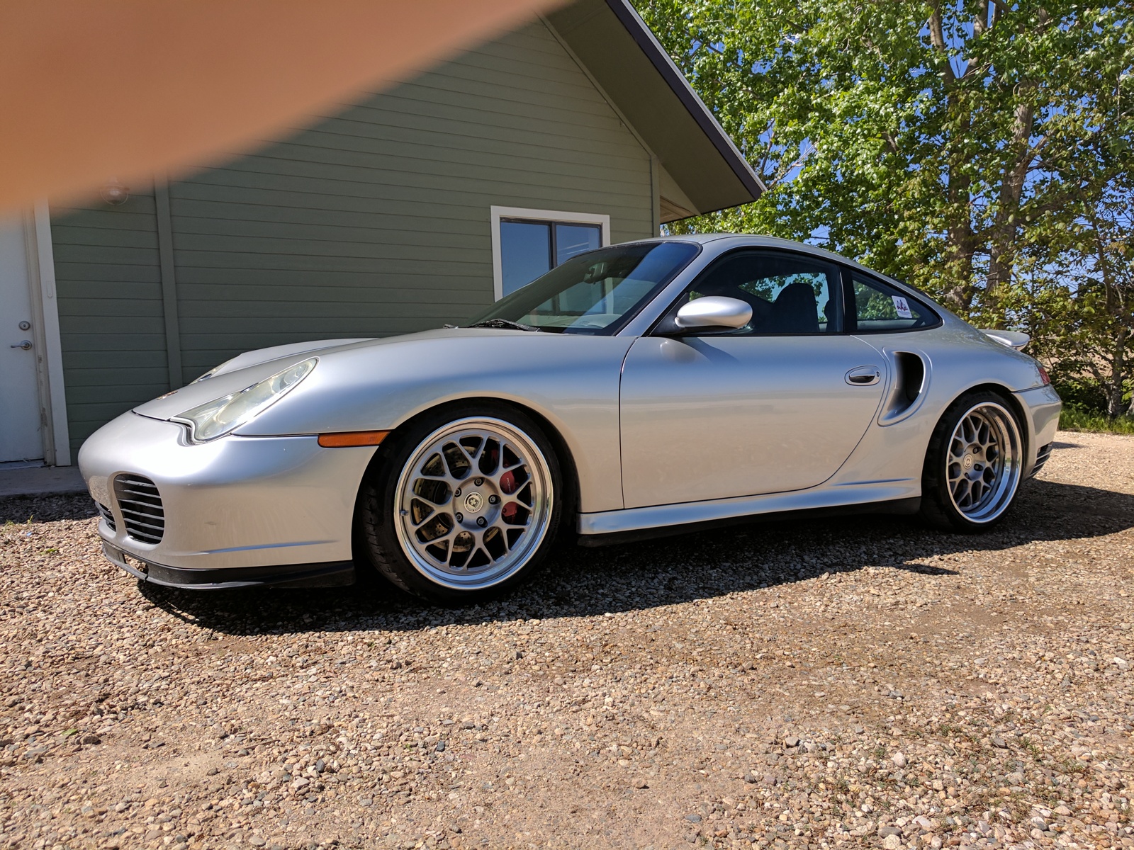

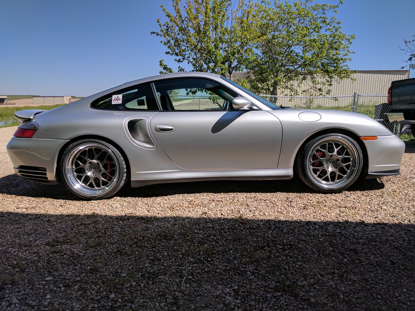

Washed it up.
ID:	476116   Click image for larger version
