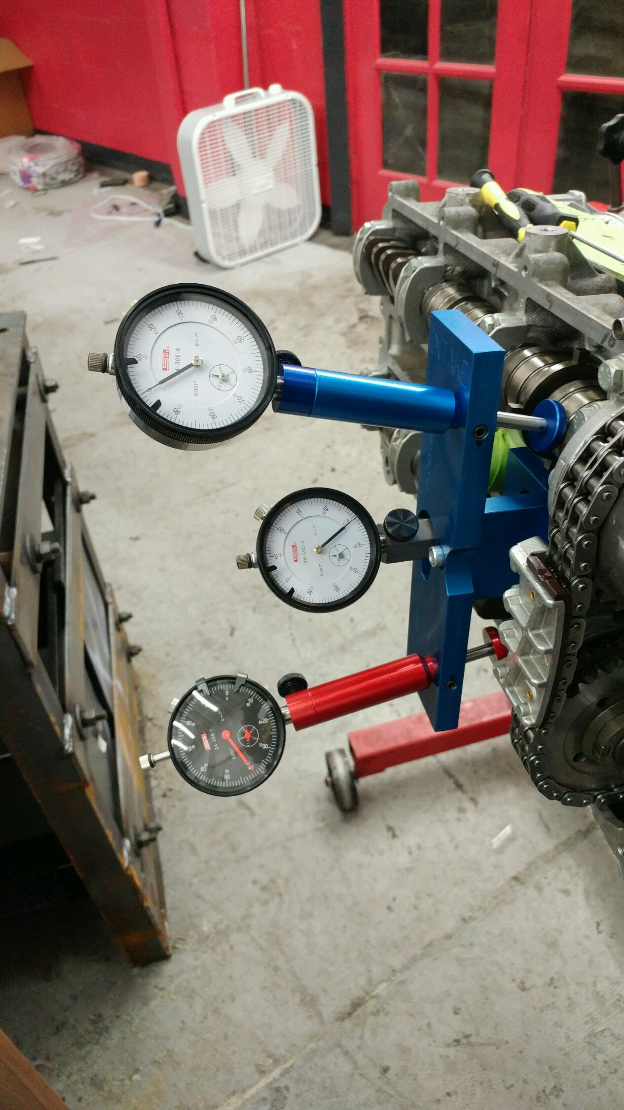

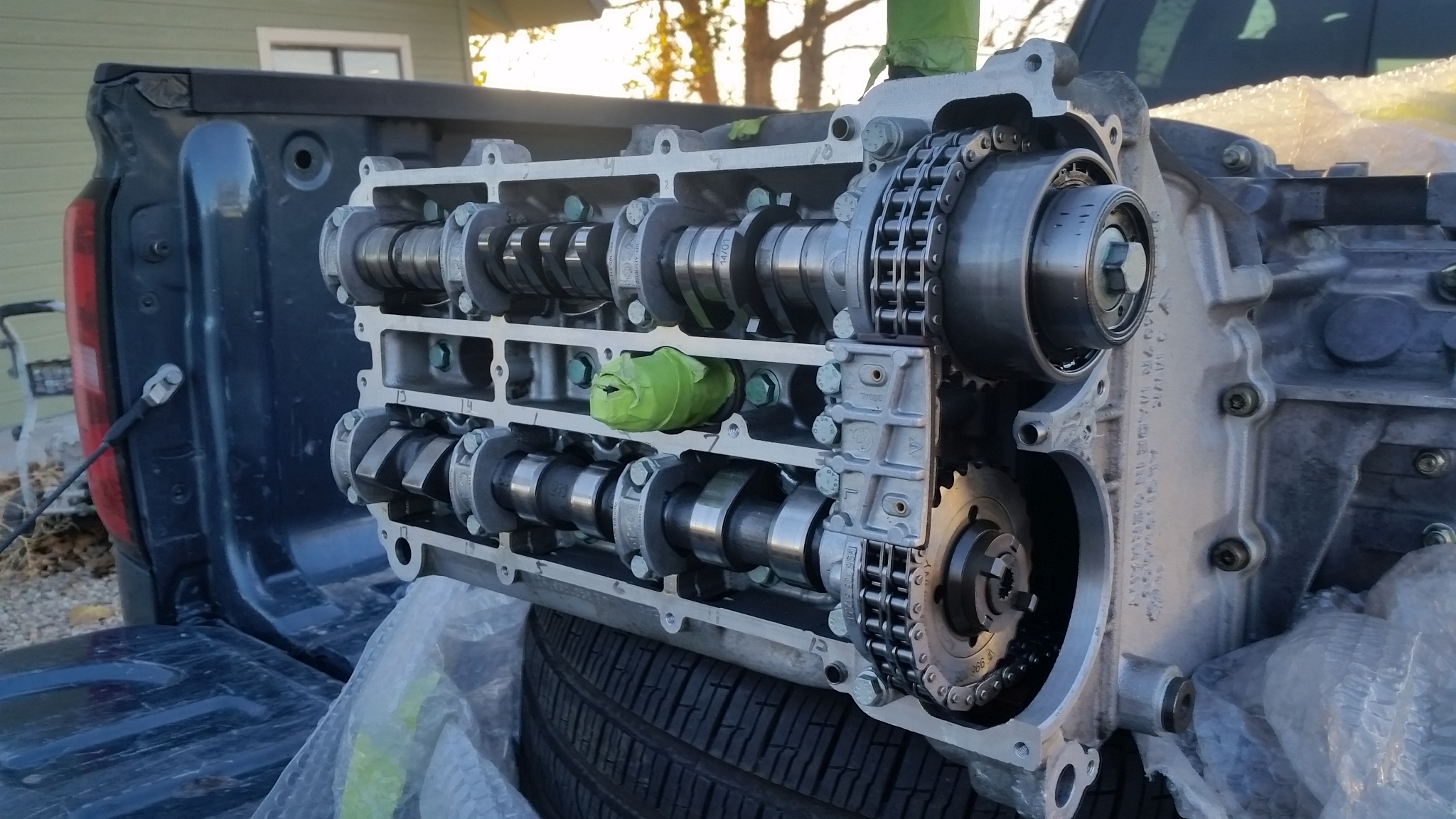

Ok I finally have my motor back with the cams timed properly. I'll share what I've learned about timing them with the dial indicators. Apparently the timing specs are a big secret for some reason and it is not in the service manuals. Porsche factory as well as several shops I called were being dicks about it and would not tell. Stomski apparently does not know either but he does know the GT3 specs. My shop called a race team they are friends with and got the specs and I was able to confirm them with Mark and Tim who were helpful. I think it's BS that this is some type of secret so here they are: 110/110. I think it is the same as the GT3 cams. The exhaust cam is direct to the chain but for the intake cam you have to set the position on the crank and you have to advance the variocam all the way forward to the stop and set at 110 in that spot.
I'm going to start putting everything back on my motor so it shouldn't be long now.
It is sad. Honestly, I find with most things like this on higher end cars are protected secrets. The worse part is it isn't because it is more difficult to understand or do. It is because if the knowledge becomes obtainable shops loose business. If you can successfully protect the information from being distributed and concince everyone it is too hard to do and only you(insert shop name here) can do it because you are specialized with special tools. But it also turns the enthusiast community into obe that woukd rather throw money at something than grab a wrench and learn. I recently had a local Oregon Porsche specialist who is quite renown and highly regarded refuse to sell me a couple of $7 differential carrier shims. I get it, he may need them for another job perhaps. But sell two shims to an enthusiast seems like a blatant dick move. Especially when acting like a dick about communicating it. Just a clear divide in our community. The people who pay and the people who do.
Yah I can understand it from their perspective. Engine builders are probably hoping it fails and this thread becomes a cautionary tale. . I'm really confident that it will run great though. I've seen a few DIY top end builds but I think I might be the first guy to do a bottom end on here. It is the same as the old 964's so not a big deal with plenty of info on it IMO.

Well I think I screwed up. I can't get my chain tensioner on. One is really tight and one is loose. I suspect that I mixed up my chain guides or installed one inverted and I'm going to have to start all over with the cams. Dammit! You can see in the pic that they are different.
