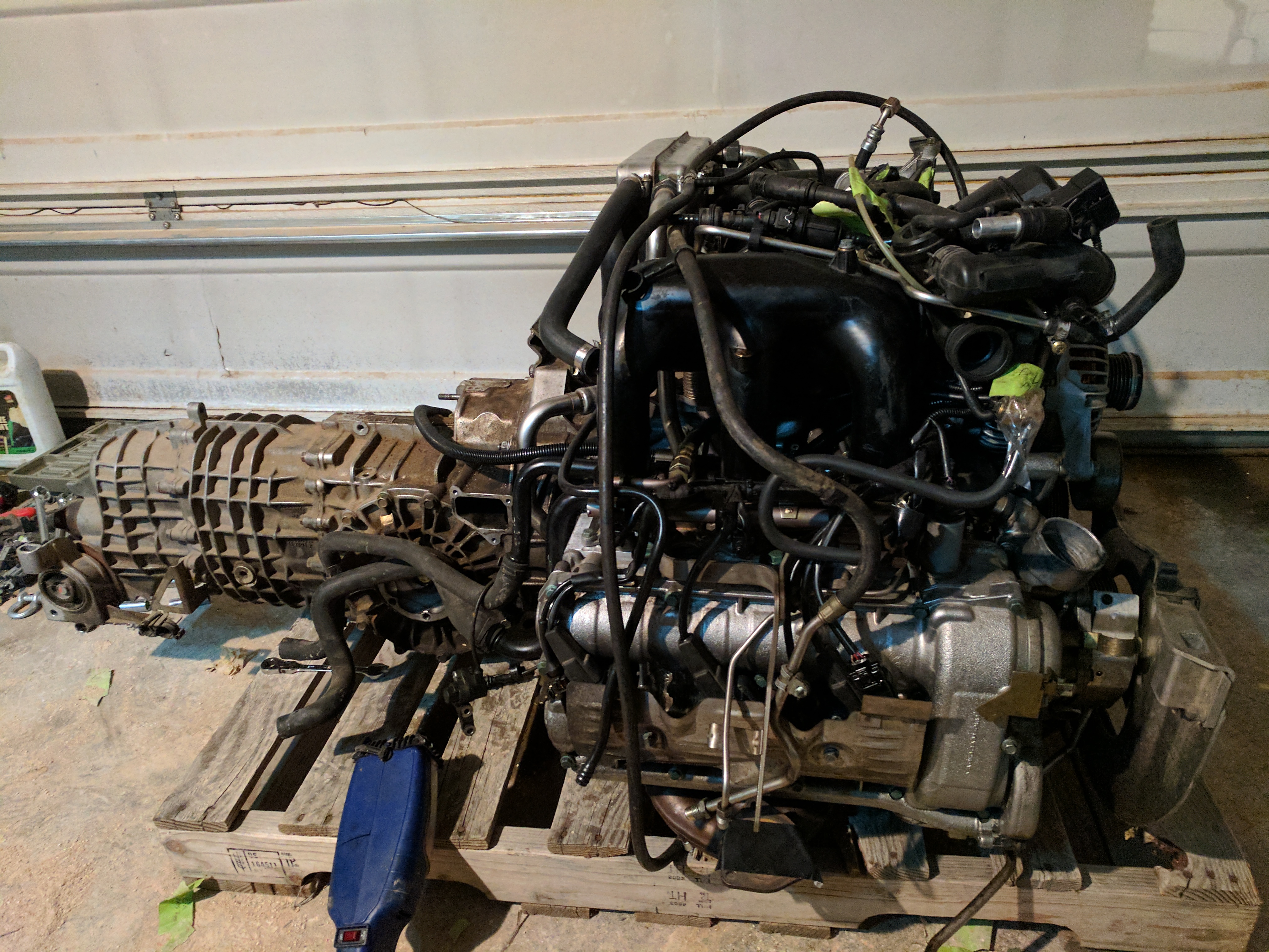

I got the engine mostly done. I just need to install my turbos and then some of the tubes on top. We've had a really bad winter here with record 36 inches of snow along with sub 20 degree temps. My family owns a large dairy farm so I am outside in it every day and I am pretty burned out so I have been slacking on the car. I will put it in this month for sure though.

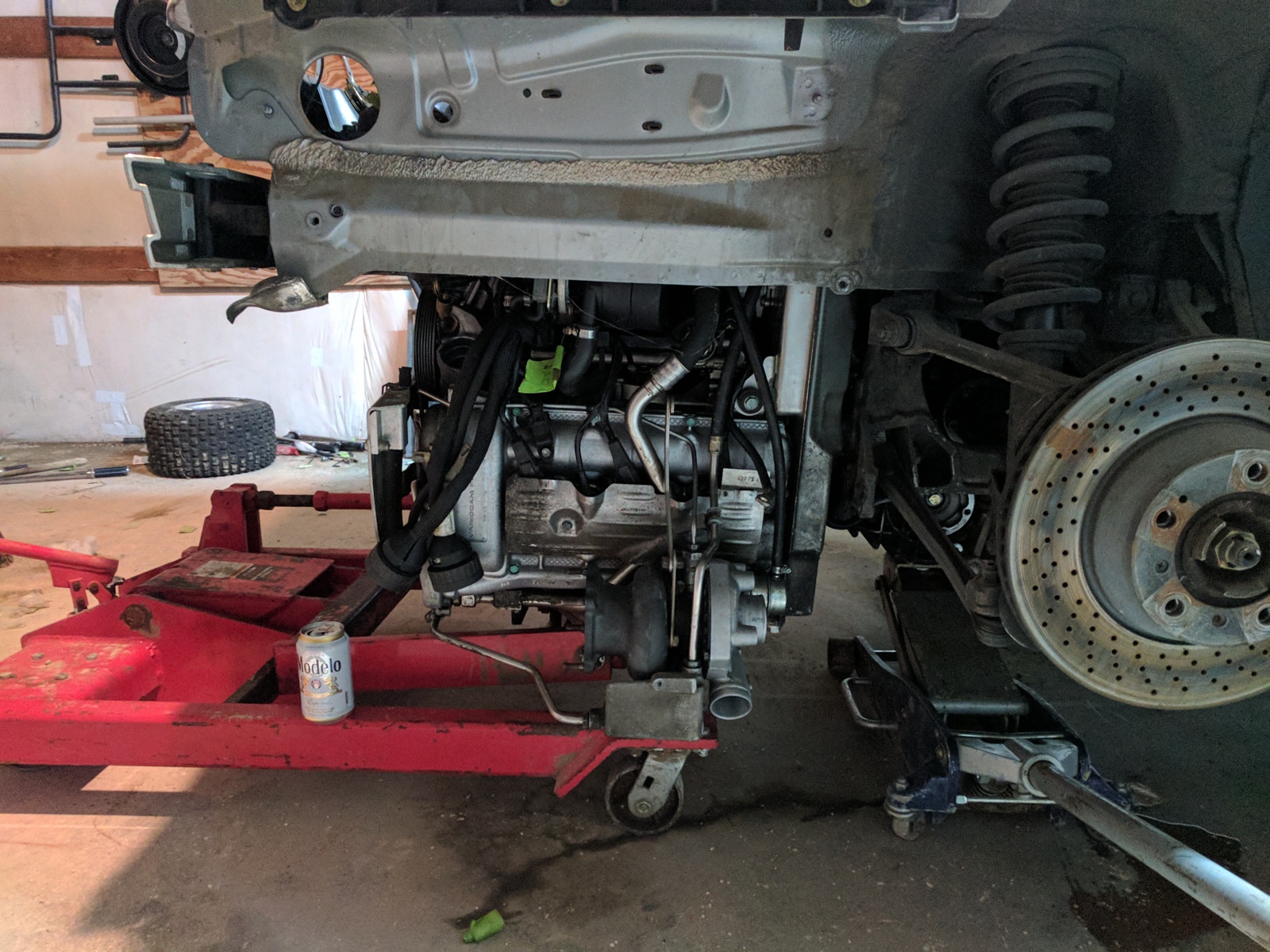

Finally ready to finish this project. This is how I lift it in with the car on jack stands.
