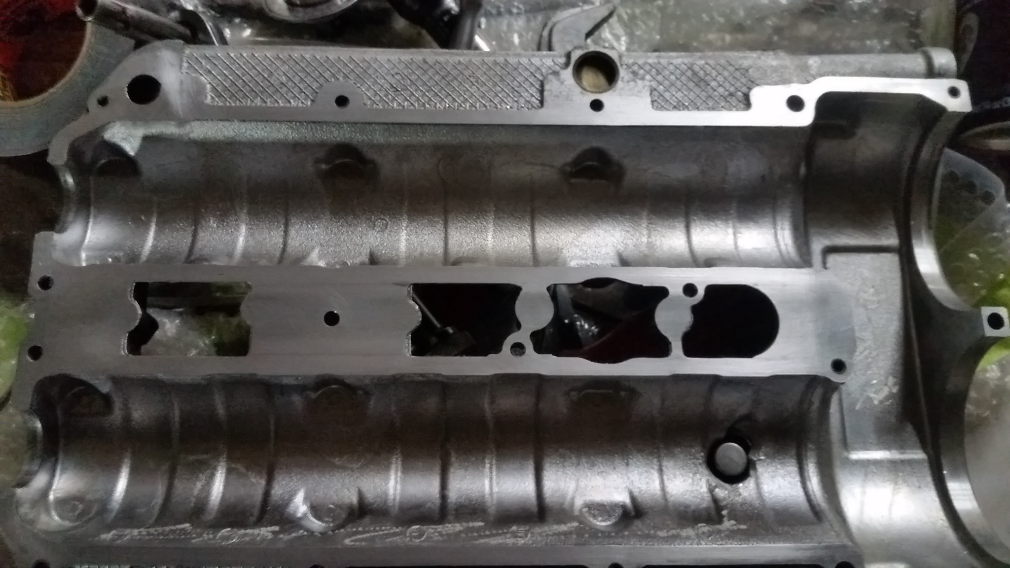

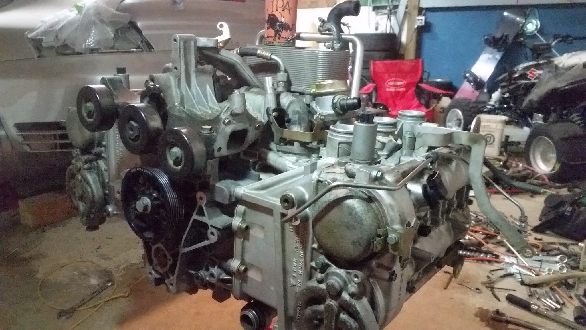

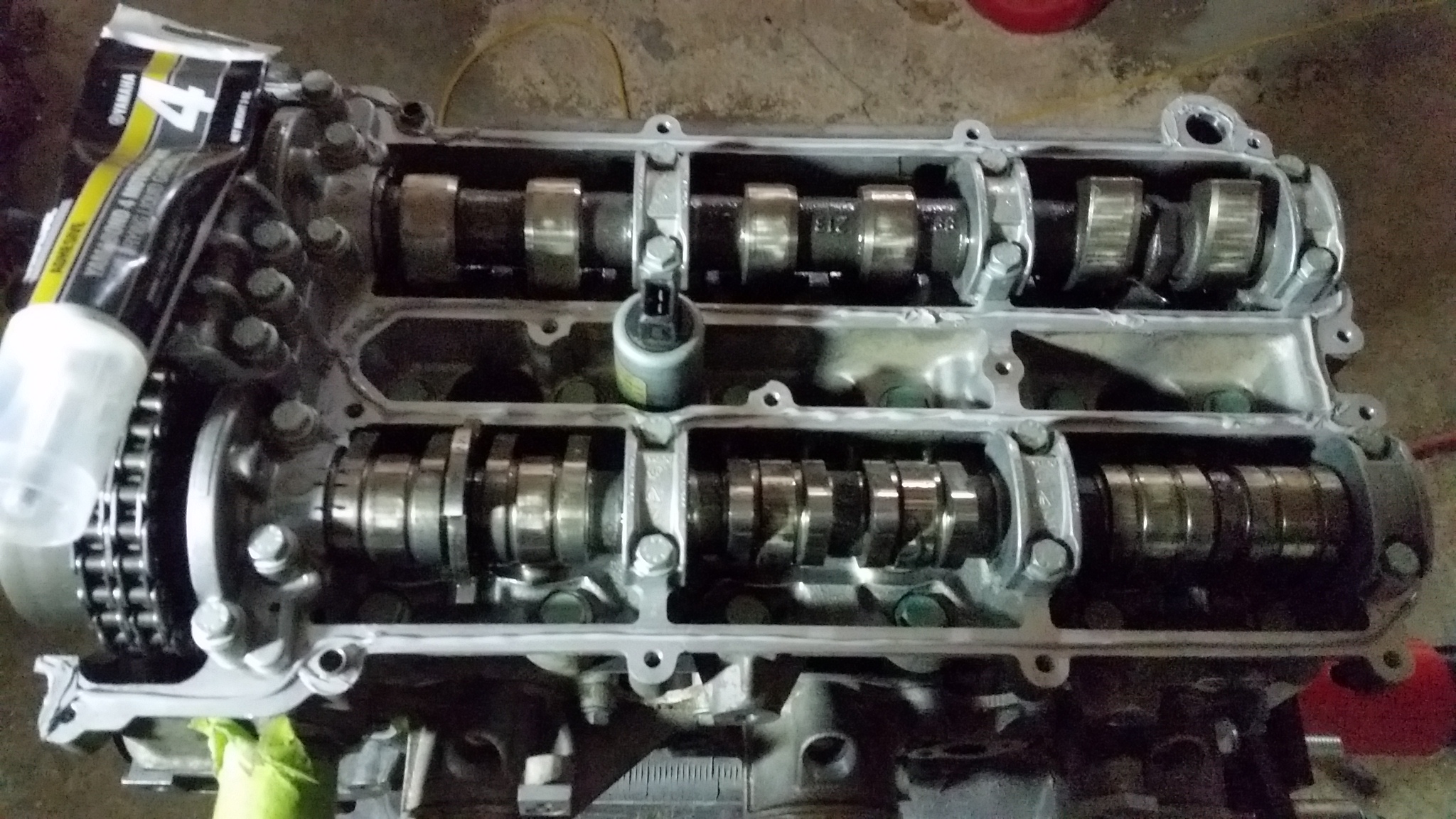

I'm working through the final stages, I can see the light at the end of the tunnel. I put my valve covers on and then realized that my shop had mixed up my exhaust cam sprockets and pump drives so I had to take them back off, swap the sprockets, re align the exhaust cams, clean off the sealant, and install again. I got half of the accessories back on last night. It's a bit of a puzzle remembering how it all goes back. I did take pictures as I tore it down which helps. Drank too many IPAs with 7% alcohol in them and now I have a headache. I suggest sticking with Coors while wrenching.
