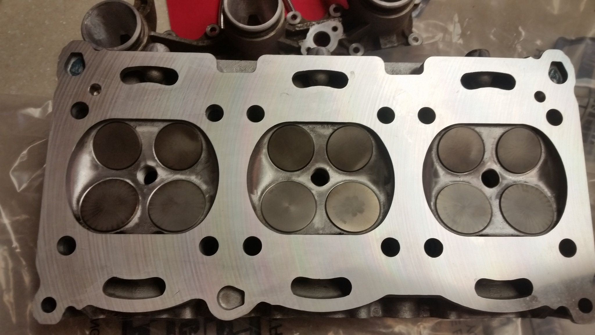

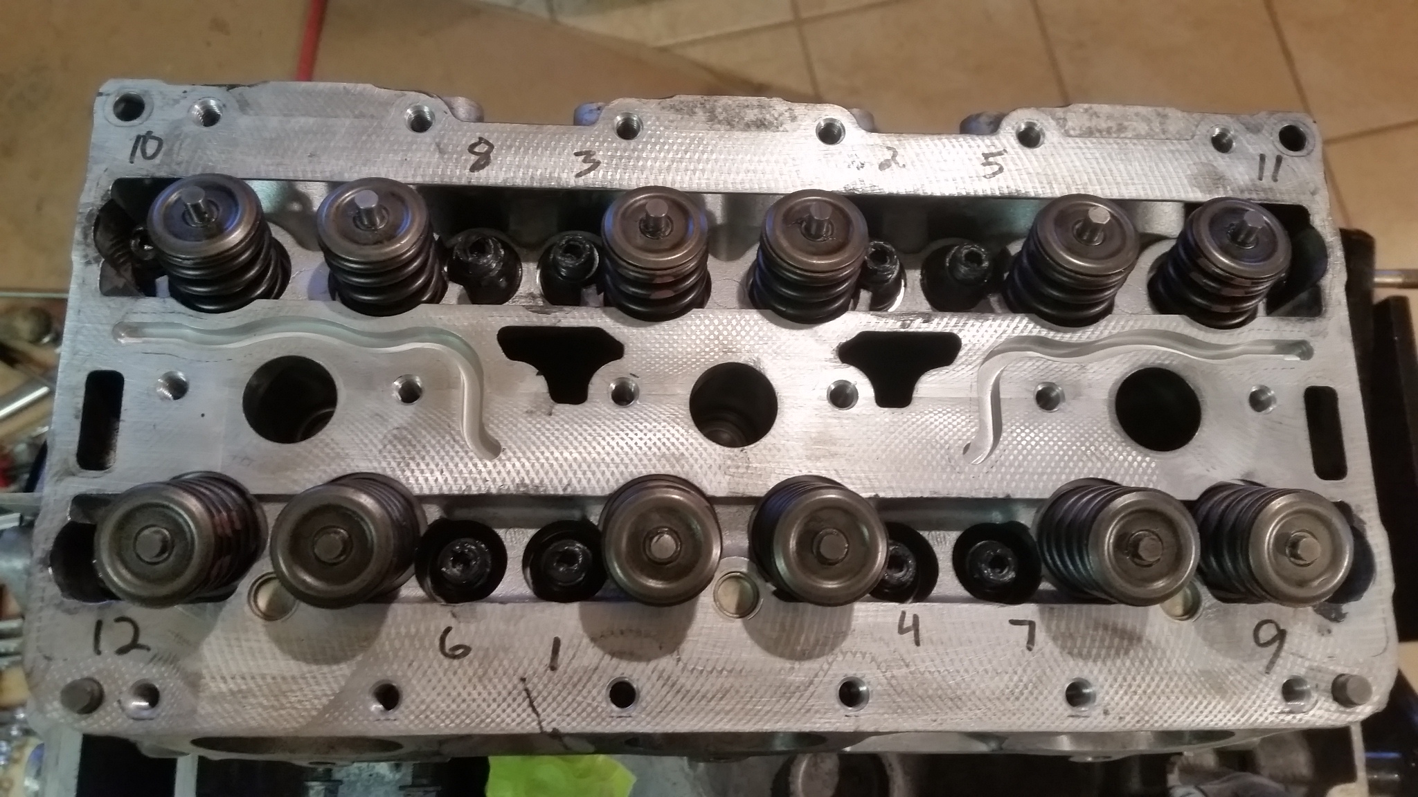

Ok I have my heads finished finally, feels good to know my valves are totally fresh. My plan for torquing down the heads is as follows:
Use generous amounts of ARP lube on the threads.
Torque down the bolts 10lb ft at a time using the factory pattern until I get to around 55ft lb.
Let it sit for a day to let parts settle.
Loosen it up a small amount and torque back to 55ft lb.
Torque 1 nut to 85 ft lb and angle torque the rest to the same degree using the dial tq indicator. I may set at 60 instead of 55 depending on feel. This should give me an accurate even bolt stretch and alows me to maximize my head studs.

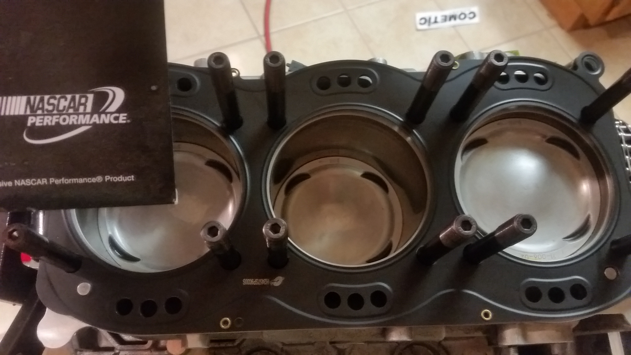

Also of note is that I am using a SRM Cometic head gasket. It seems like a real quality piece and it says NASCAR on the packaging so I know I am in good company. It is a bit thicker than the stocker so it should compensate for the 4 thousanths or so that I shaved off of my heads. It comes sized for 12mm studs so one less thing to worry about.

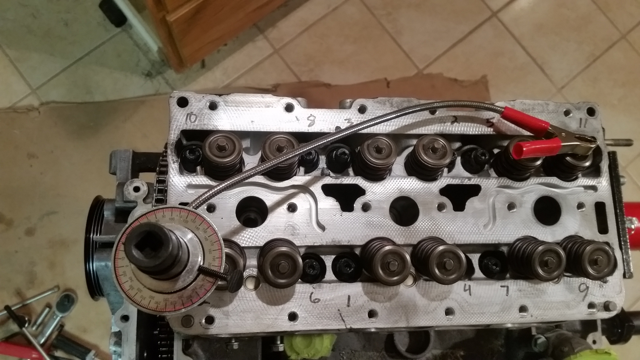

I am torqued to 60 ft lb. I've noticed that when the parts settle as the wrench turns it slips a bit. On the 60 ft lb pass only 1 nut out of 24 slipped just a bit. When I go for the final angle torque I will know if I am right if there is no slip of the wrench. If there is I am going to reset at 60 or maybe higher and try again. Here is a pic of my angle torque dial.

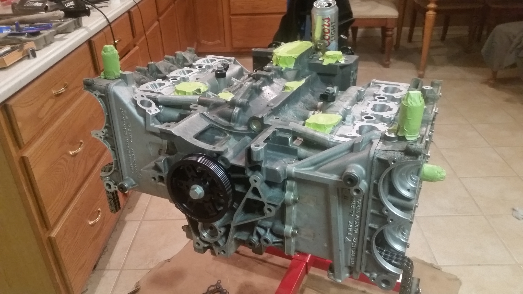

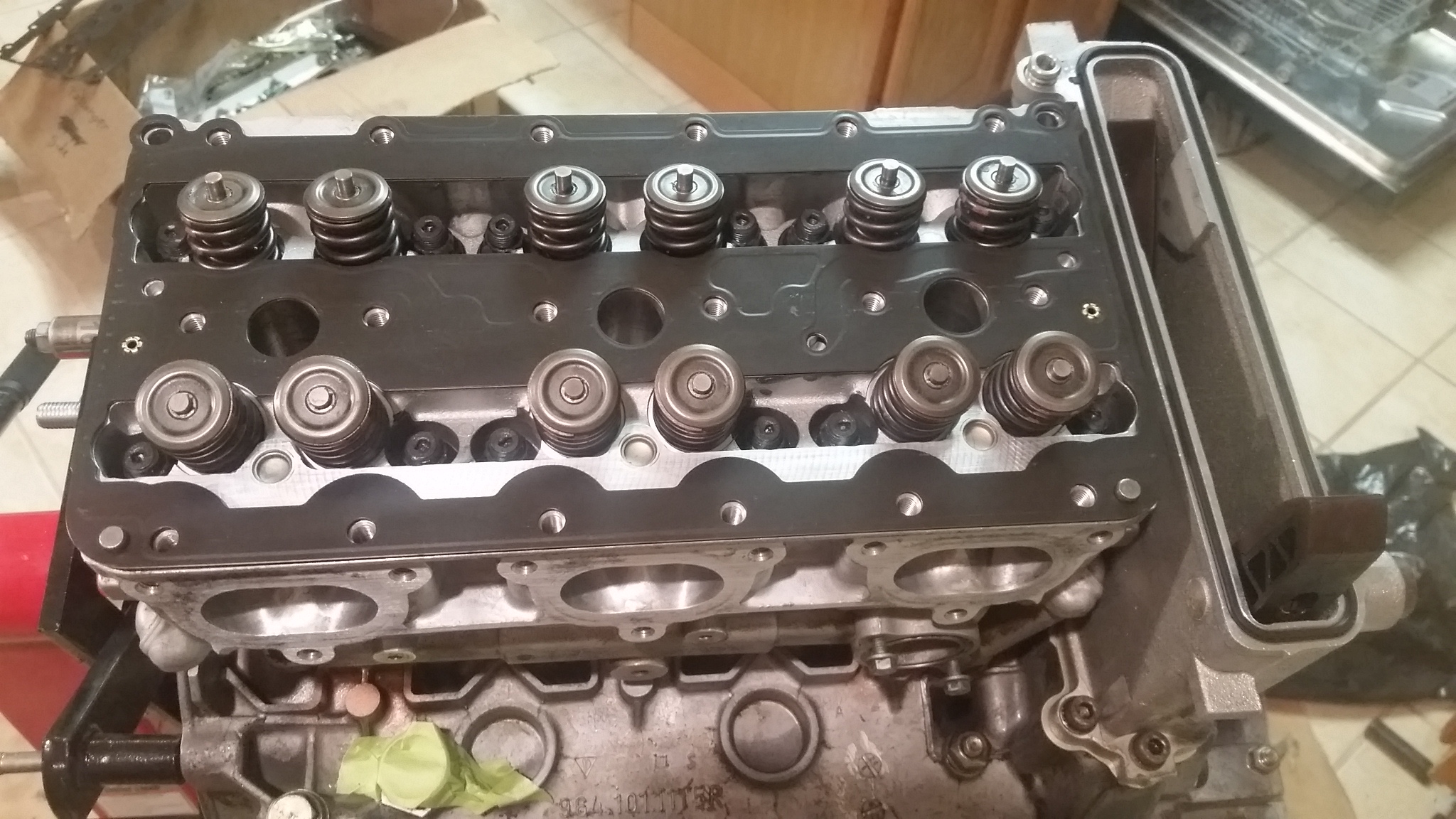

Installed the chain box, chain guides, and cam towers. It all goes together nicely. As noted a few pages ago the MLS gasket for the towers is ambidextrious save for 1 hole, so it can be installed backwards by accident causing the variocam to malfunction. I've gone as far as I can go without any special tools which was one of the big scary reasons to not try this. I'm trying to get an appointment with EBS Racing to set my cams so hopefully this can be done soon.

Seeing the motor in your kitchen in the last pic made me laugh. Again.

You mean "climate controlled clean room." Looks like October 8 @ EBS Racing. I tried to talk to my local P car dealer, they haven't been very cooperative so far but we'll see.
