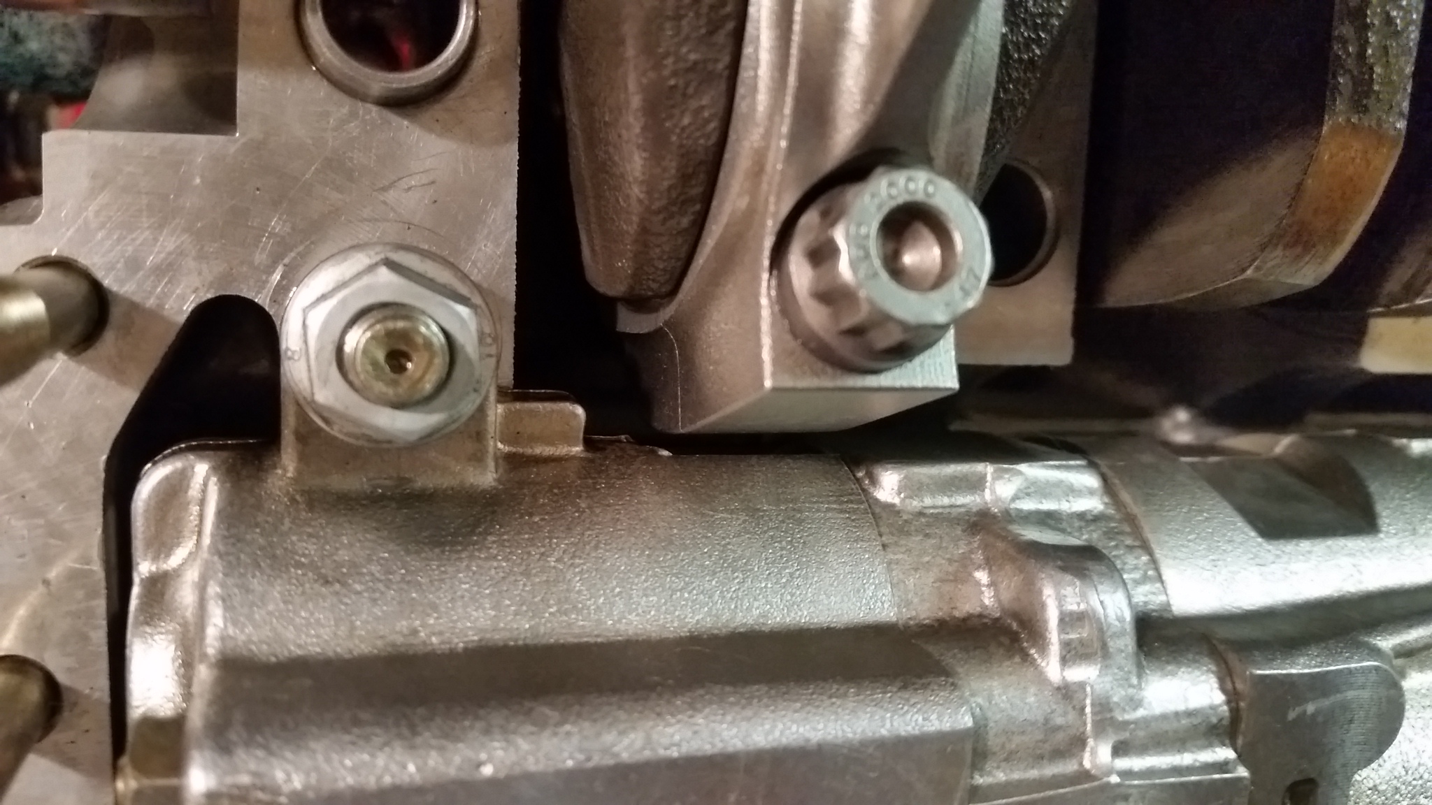

Got my new rod bolts from Pauter last night and made some progress. First I assembled the crank. I stretched my bolts to around .0055 which was around 56 ft. lb. I assembled the new nose bearing and installed it with lube. I then dropped the crank into the case by taping up the middle rod and holding it by the top outside rods. I put the oil pump, IMS, and new chains together and dropped them in along with the seal under the pump. I should be able to seal my cases tonight.

No clearancing of the oil pump with the Pauter rods, correct?

My understanding is that they do clear the pump. They had great customer service also. They look and feel very high quality.
correct.
The video I posted earlier is well worth the $. I went out and got more supplies last night and didn't have time to work on it. I'll try it tonight.
I run Pauters with an RSR crank and no clearancing is required but I was under the impression with a stock TT crank you have to clearance it. I'd verify it to be sure... I may be thinking of Carillos however..

Carillos you do , pauters you do not

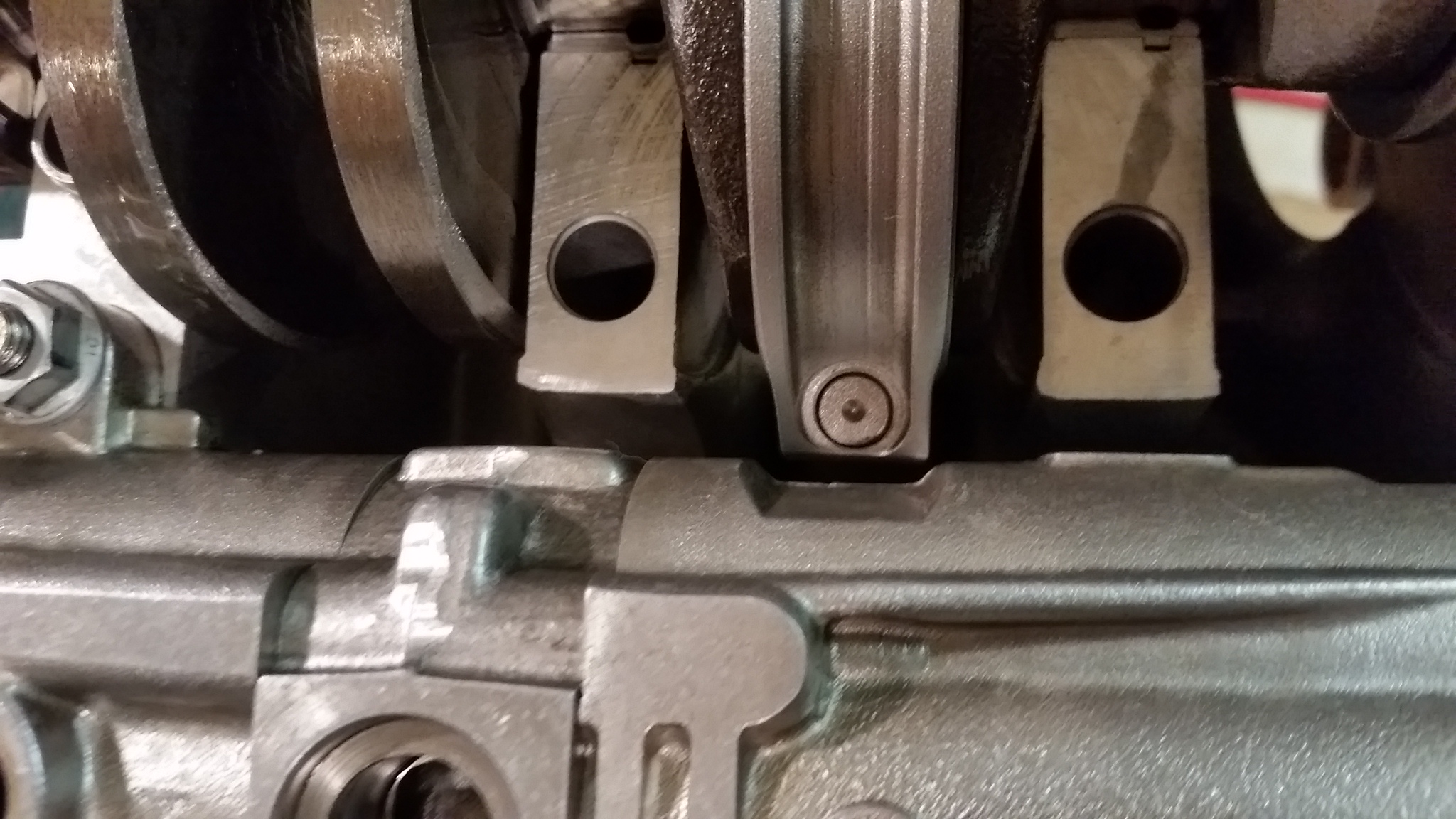

Checked rod clearances over the oil pump. They do clear. #1 is pretty close and #2 is very close. #3 has plenty of room. Just to be safe I am going to shave a bit off of the #2 slot on the pump. 1 and 2 pictured.

I'd heard they would clear via word of mouth, glad you checked! Better safe than sorry for sure and I now see why Carillos don't clear! :-O

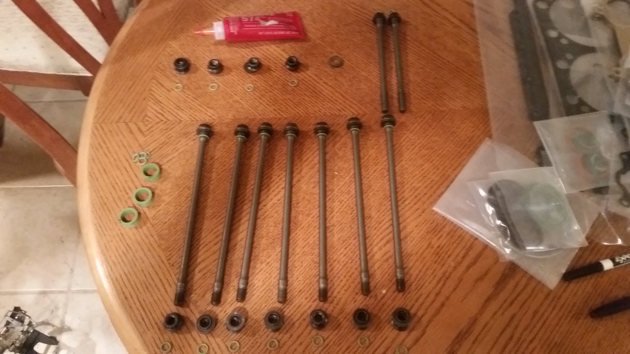

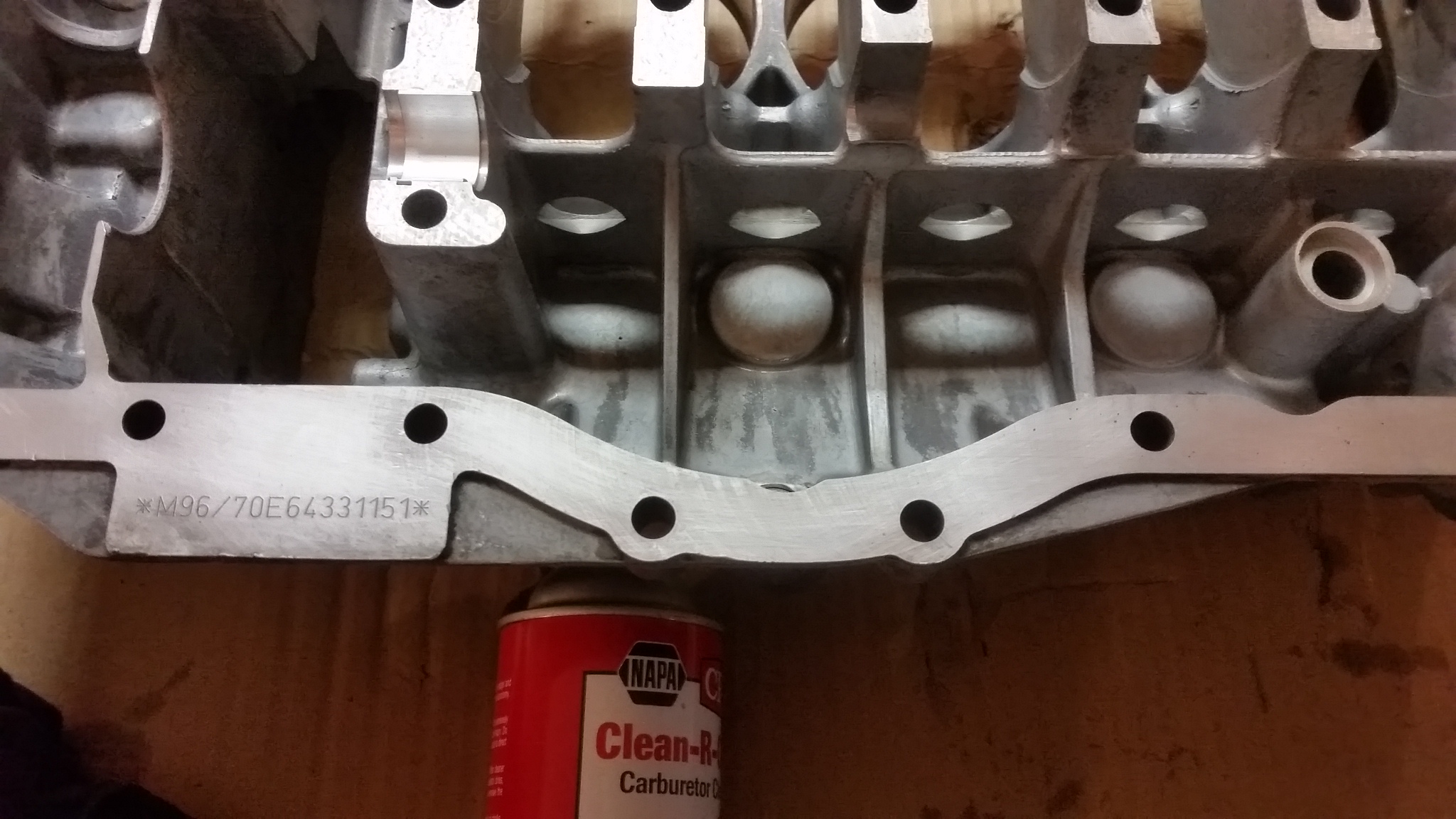

Made some progress but not the exciting kind. I clearanced my oil pump a little. The rest of the time was spent scrubbing the perimiter of my cases for the sealant and organizing my parts and tools. It turns out that the Loctite 574 sealant cures in about 20 to 30 minutes, so you have to torque down the bolts as fast as you can after the cases are joined. You need to be very organized to do this. When the sealant cures it forms a crusty strong glue type bond, so you can't let it cure before you torque or it could leak from not sealing properly. I am going to rehearse the process tomorrow and go for it.
