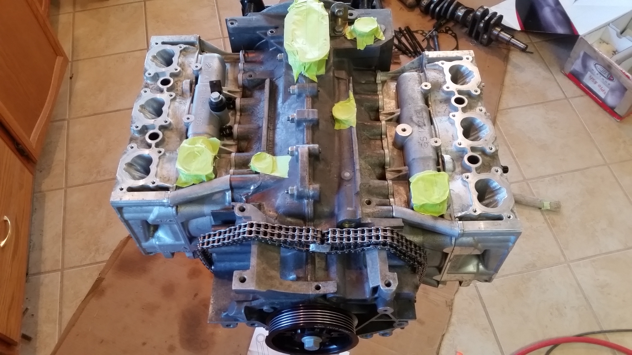

Thanks for the compliments all. This has been a lot of fun and I think that I've really nailed it so far. It is getting close now. I finished installing the cylinders, crank pulley, and now have the heads mocked up on the engine. The heads are going in next week for a valve job. My valve springs seem to be in good condition so I am going to use them again, just 58k on them. SRM shipped me a set of Cometic head gaskets, they should be here soon so I can bolt everything down. I'm considering my options for having my cams set. I tried the local dealer but they have not gotten back to me. They weren't sure if they had the tools or not.

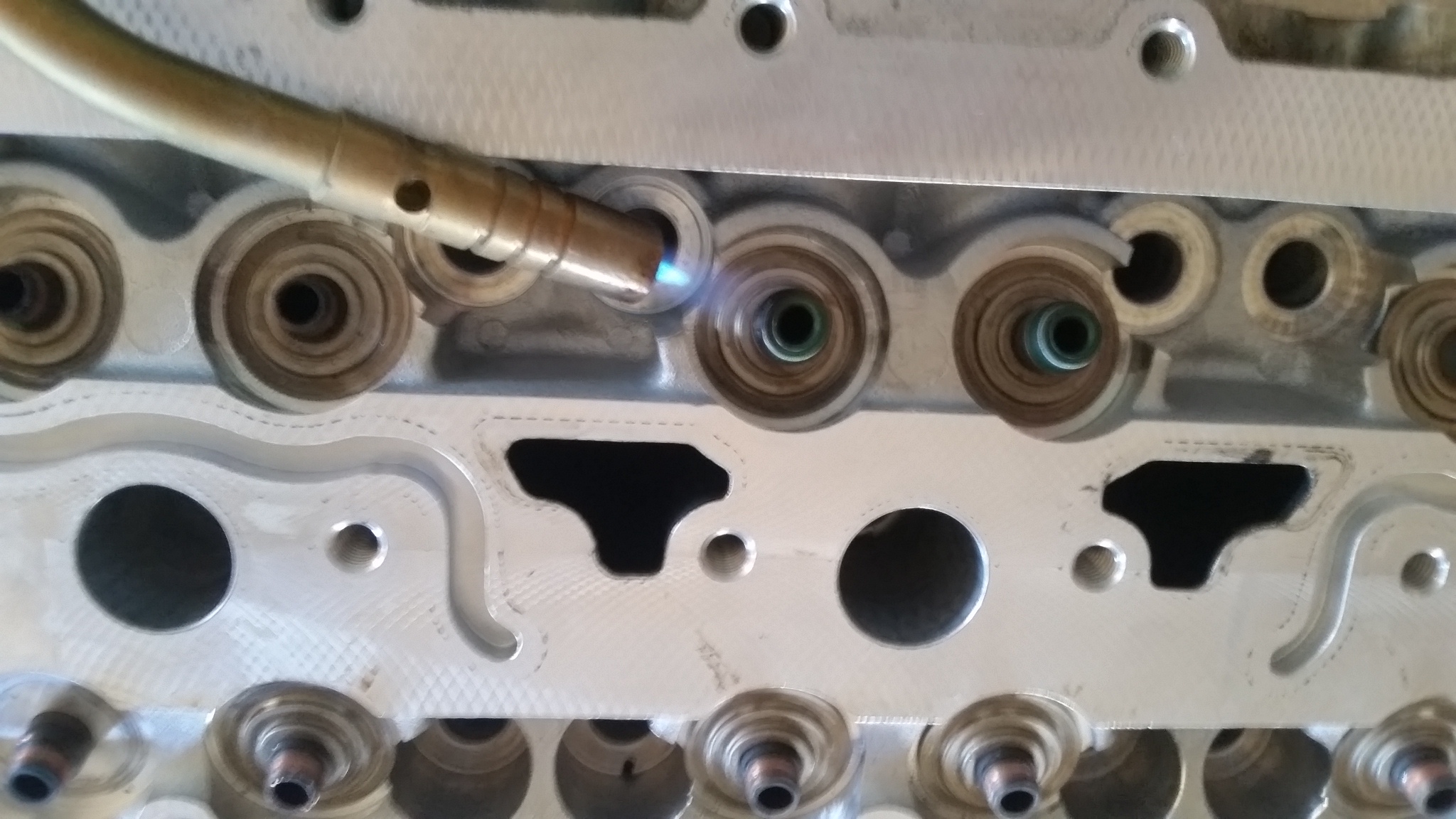

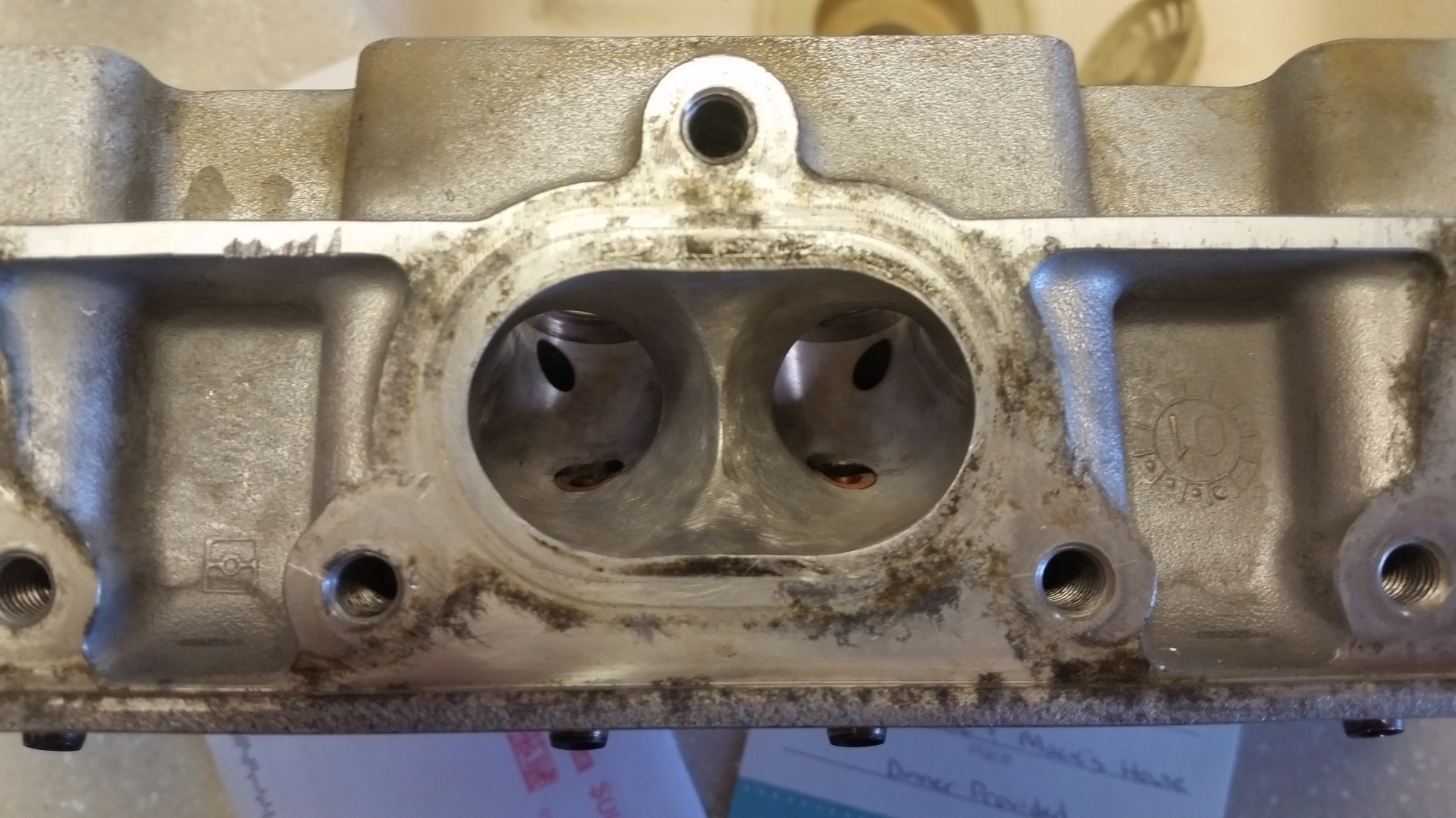

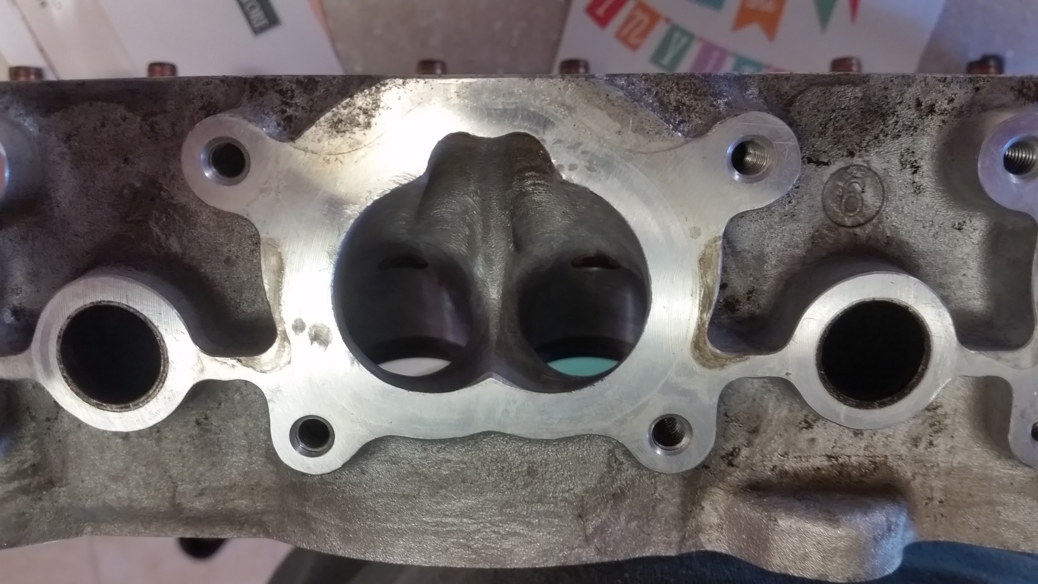

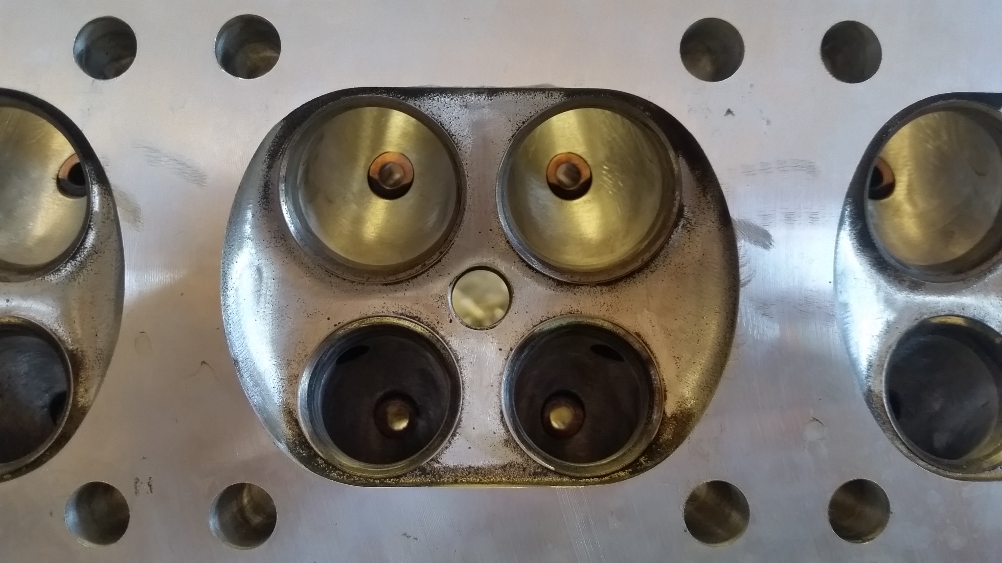

A little update to revive my build thread. I've been taking a break from the project having been on vacation and going to weddings but am now ready to proceed. My porting is finished and the heads are off to the machine shop to re seat the valves. The intake side is good but the exhaust valves were pretty beat up. The valve stem seals were difficult to remove. I was able to pull them by heating them up with a propane torch. I should be able to bolt down my heads next weekend if the machine shop comes through for me. Hopefully I can get it all together and catch the last few months of the season.
