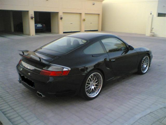

Here's a picture of my now sold '03 turbo. ROW suspension with HRE 19's.

Howcome i have ROW suspension and it doesnt look anywhere near as low as that

Illm3,
I don't think we can clearly see the pics that was posted by the two previous members... How can you say it look low ? IMO, the picture is not clear enough to justify it.

And maybe its just the angle but 03turbo's ex-black turbo looks real low like with hardly any wheel gap!
