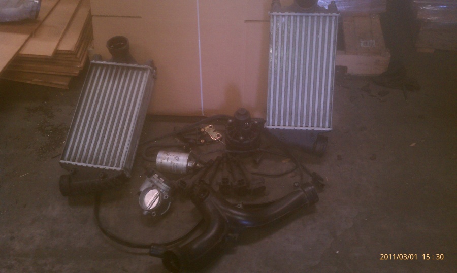

Originally Posted by tom kerr
down to 2850lbs with doors recently gutted, Cup car mirrors and headlights removed. pic below was right before mirrors and headlights done. Was down to 2:18 for Sebring lap. Big Cup car race there in several weeks so looking for another second!
Car is actually down closer to 2750 with recent weight loss and removal of some other things you dont really need...

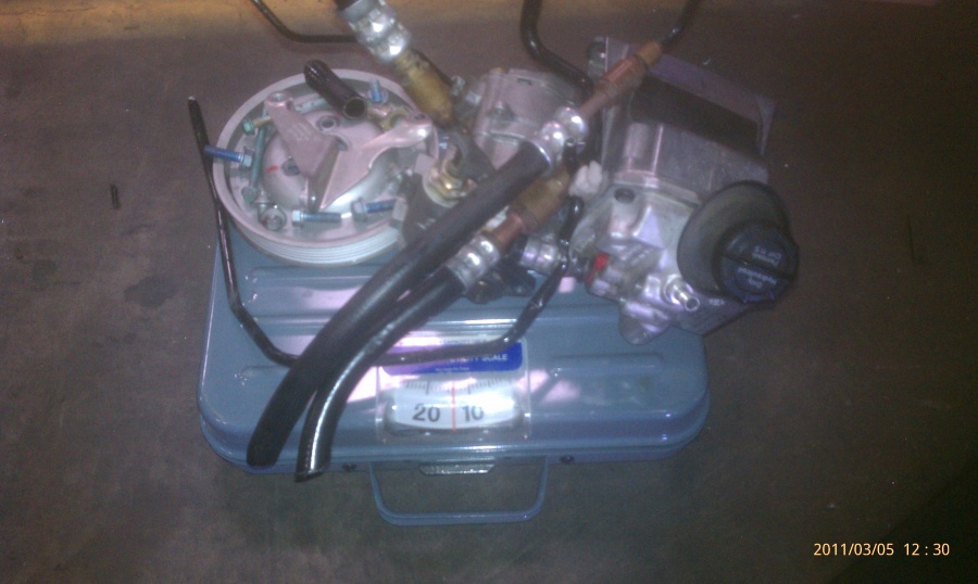

I have plenty of the things.... Send me your address in a PM and I will send you some bent up... Take me 5 minutes....
Also took off Power Steering Pump and will be installing electric Motorsports unit. With Fluid will save about 17 lbs off very back of car...

bob thanks for taking your time to share your expertise. I'm sure this forum appreciates it.
The last above weight savings came from taking off the power steering pump. it was 17 pounds on the rear of the engine.
got the cup car one (5pounds) and put it in the front of the car
so weight off rear and small amount added to front for better balance.
we also have all the front and rear fans and shrouds out for better cooling on the track (dont do it to your street cars!)
car is very light!

Taken a bunch more stuff off Tom's car. Will weigh when done. Most likely will now be in the 2700-2750 range WITH a 1/4 tank of fuel. Add in a svelt 150 lb soaking wet Tom and you have one light 996TT packing 700 HP at the track. (and a pain as he has the smallest damn little German boy type seat that my 235 frame has to shoe horn in to test at the track)
