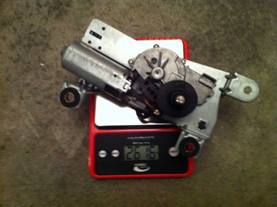

Some time ago I removed the rear wiper, rear wiper motor, and all associated hardware (and installed a BumperPlugs.com exterior body colored plug)
This scale is accurate to the thousandth of a pound.
Picture 1: Bare rear wiper motor (2.616 pounds)
Picture 2: Wiper motor plus wiper and mounting hardware (3.713 pounds)
I also removed the rear cabin panel plus insulation that hides the wiper motor assembly (my car is black, doesn't stand out) but don't have those parts available for weighing at this time. If I come up with those, I'll add them to the list.
