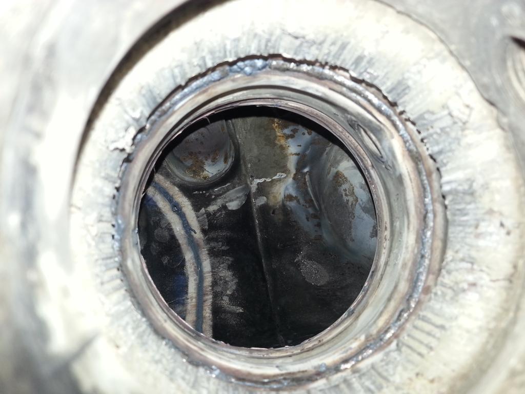

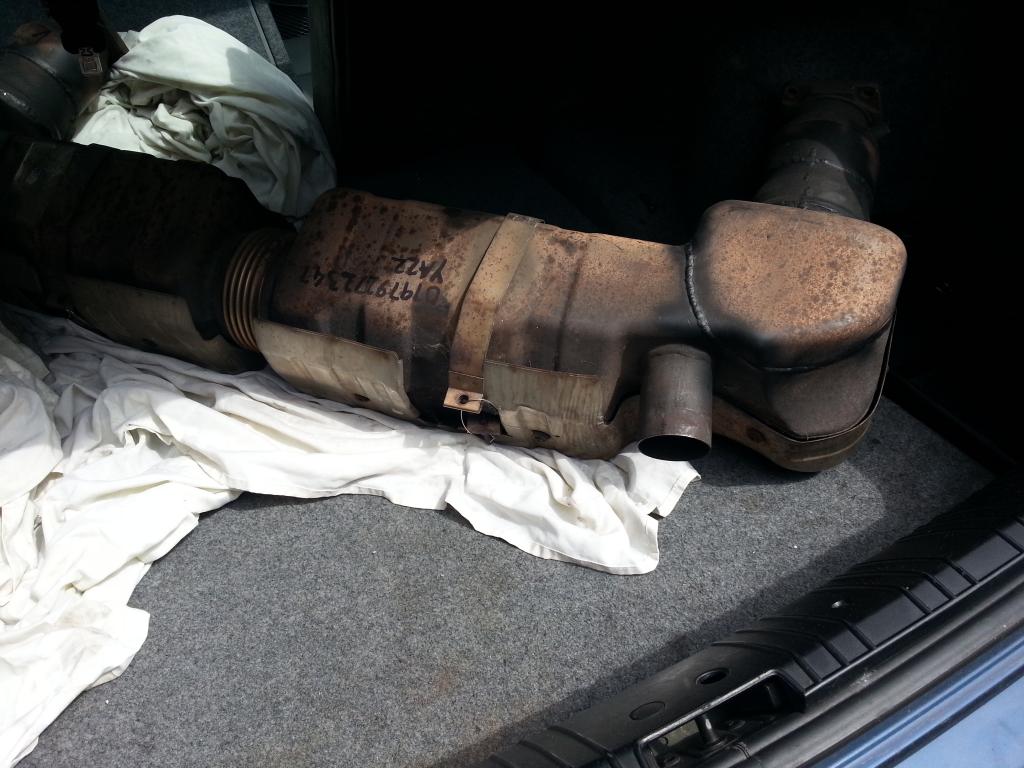

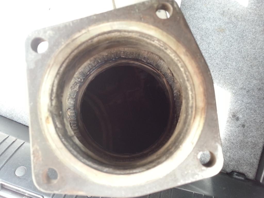

Just to add what I had done the other week........
[/URL]

My Fabspeed Gen1 was fun for the first 15months.....but now it was just getting annoying....so I went and had this done....as apparently this is what RUF do but with a single 100cell cat.

I think you are wrong.......and this is my proof as to why......
I have a similar set up to yourself and John Speed, Stage 1 K24 Billet Hybrids (basically K24/18Gs), intake piping, air filter, 1 bar actuators, 72lb injectors, diverter valves, Fabspeed Gen 1 CATLESS, Proto Tuned.
The Fabspeed Gen 1 was getting a bit annoying after 18months of having it on and UK race circuits have a noise limit of 98-105db static, my Fabspeed was 110db so I couldnt really get the most out of my car and I wanted to do more track days. I was very hesitant at putting the stock exhaust on, so I thought I'd just do what I can to minimise restriction and back pressure. I had the cats cut out completely.
Then after fitting this oem modified muffler I data logged and sent back to Todd K to make sure the car was not running lean or dangerous in an areas of the map. Did the usual durametric logs, 3rd and 4th gear so it could be clearly seen. Todd got back to me last night saying the map is still perfect, no need for any adjustments.
I will admit the car has a bit more lag but hardly noticeable when you u are going through the gears...and after a sound test at track day i did at the weekend...she got 99db static!! WOOHOO
