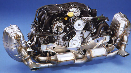

Originally Posted by c4swat
thanks for all the help guys..if it was a intermix problem what is the solutionto fix that.

sounds good.....
