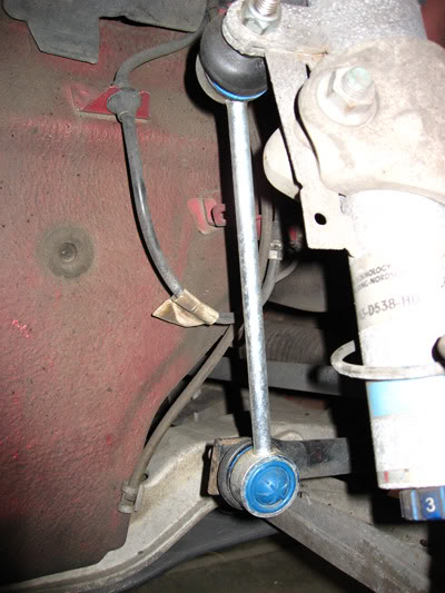

I had clunking noises at slow speed over bumps, and some creaking when turning at slow speed. This was on 2 year PSS10s. We do have rotten roads here in MN. All the noise went away with a single replacement part:

Please forgive my daftiness, but what is the part? And is it a replacement or add on?
Hopefully someone more knowledgable than I will also reply! I have the installation manual for these things (PSS10s) and it is not labeled much at all. In the manual it is called the "pivoted lever assembly (again, I think).
This link came with the PSS10s. If you grab it, it should be very firm. On one side it was slightly moveable (the technician showed me on the lift). This translated into noise over bumps at slow speed and general creaking noises while turning. All at low speed only. Replacing one of them (about a $50 dollar part) fixed things for me.
Of course there are a ton of other things that can clunk, rattle, creak, on these things . . .

yes, the drop links for the swaybar.. very easy to replace.. im doing mine in a weekend or 2... supposed to be about 20 min per side... :-)
