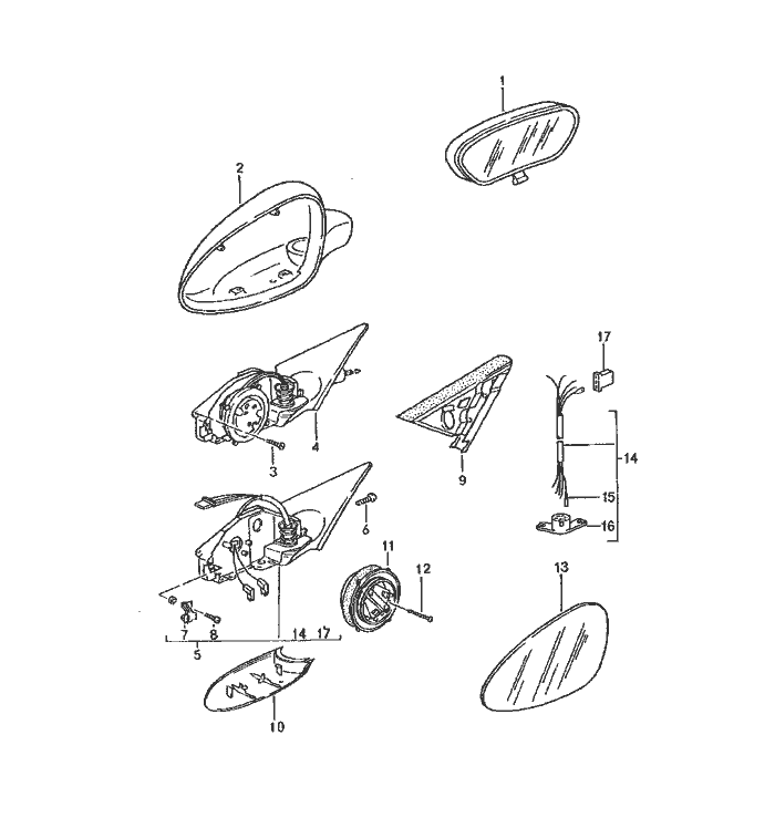

The jiggy is back. #$%#@# !!! I am going to take the mirror apart. Does anyone have a diagram or link of a 996 side mirror. I am going in blind.
Old Jan 4, 2013 | 11:10 AM
FLA996TT's Avatar
Joined: Apr 2012
Posts: 1,850
From: Brandon, Florida
Rep Power: 183
FLA996TT Is a GOD !FLA996TT Is a GOD !FLA996TT Is a GOD !FLA996TT Is a GOD !FLA996TT Is a GOD !FLA996TT Is a GOD !FLA996TT Is a GOD !FLA996TT Is a GOD !FLA996TT Is a GOD !FLA996TT Is a GOD !FLA996TT Is a GOD !
Its a pretty simple job however it a bit time consuming due to all of the hardware.
* Remove Interior Mirror Trim Pieces ( Triangles )
* Remove the 3 Torque's fasteners on each mirror base
* Unplug the Mirror from the base
* Remove the glass/mirror from housing ( be gentle when it comes to prying this off )
* You will then see the necessary **Small** Torques fasteners securing the mirror motor and the mirror cap. Gently remove.
http://www.autoatlanta.com/porsche-p..._911_parts.php
Porsche 911 (996) Interior Mirror Door Mirror
