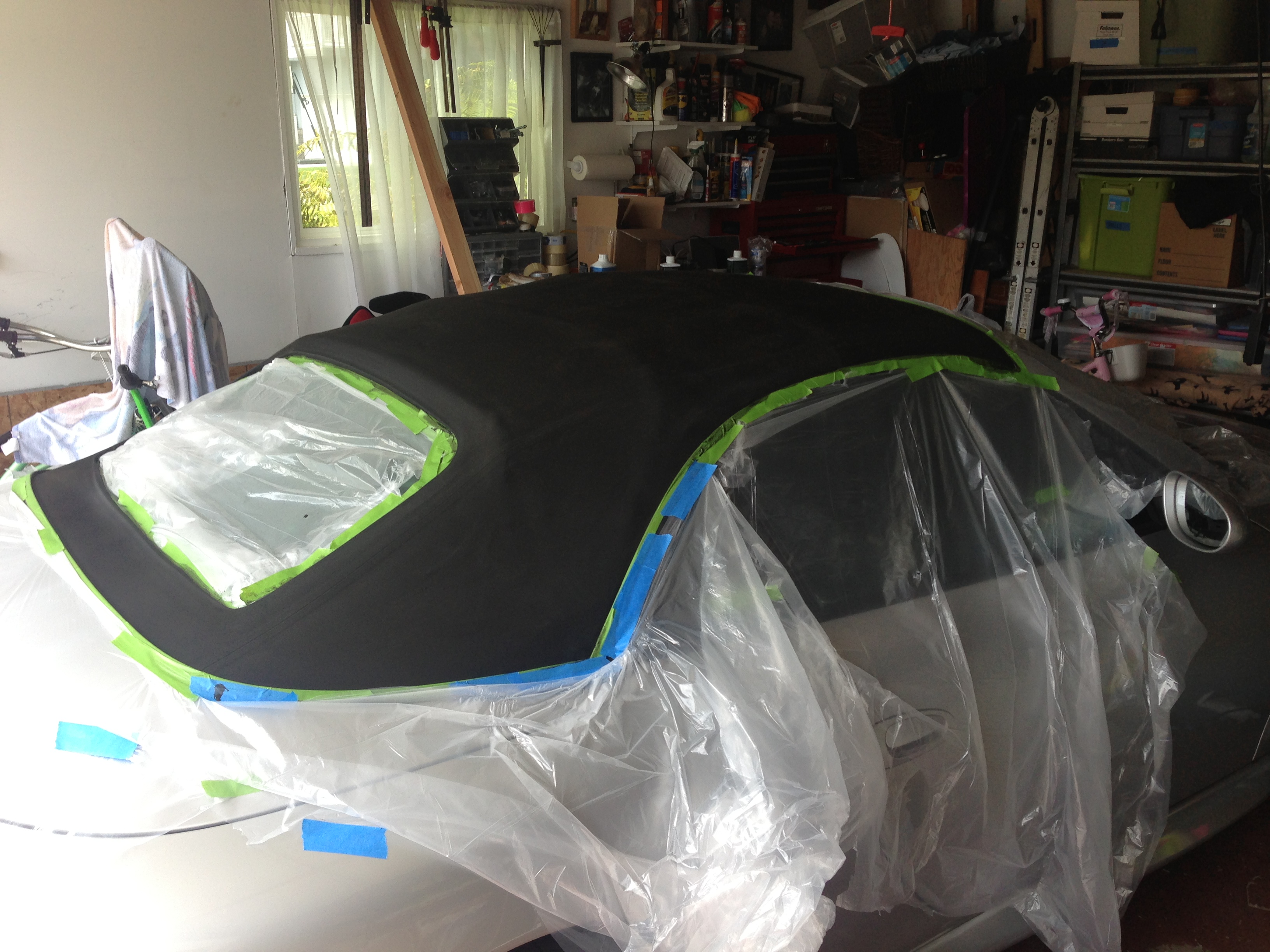

Here are the before/during/after pics. It was so easy and now, about 4 months later, it still looks just as good as the day I did it.
