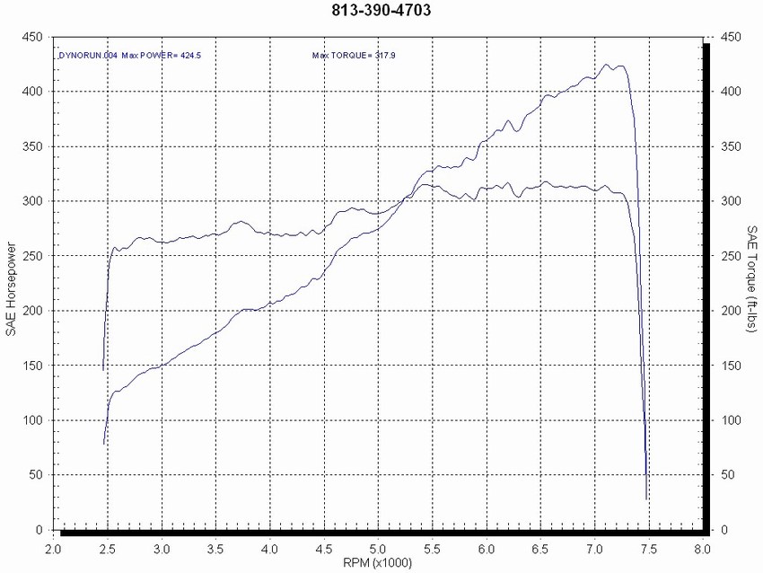

i was looking at my charts again. i actually didn't post the best after chart. i used the second "after" run based on the peak HP number. the first "after" run actually picked up more peak torque than the second one and was approx. 1 peak HP less than the second one. the heat soak probably diminished the second run. this shop does there runs back to back with the car idling on the dyno for a minute or so between runs. i probably should have overlayed the first "after" run over my "before" run.

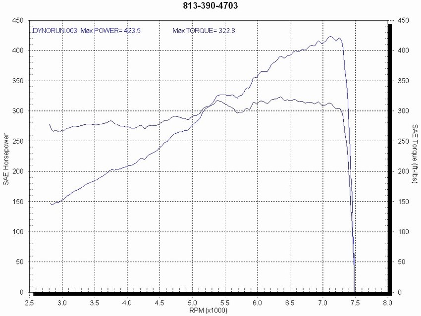

here's the second "after" run for a comparison to the first "after" run i just posted.
