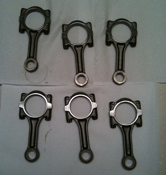

So there’s been a bit of talk lately about exactly what power levels the 997.1 and 997.2 Turbo motors are capable of handling in their completely stock form. Having done quite a bit of research and accumulated quite a bit of experience on the matter, I thought it might be time to share some of what we’ve learned, about both engine platforms. The good, the bad, and the ugly…
There story starts here, everyone remember this car?
http://www.youtube.com/watch?v=6HjodyfW95c
This car was built with the intention of testing both the upper limit of the stock engine internals, as well as our new (at the time) 68mm VTG turbochargers. Not too long after the 777 awhp dyno run was done, we noticed that the car was starting to feel down on power. (As a footnote, that dyno run was done at a 3rd party facility, not ours, and was run by the dyno owner, not us). So, noticing the car was down on power, we decided to trouble shoot the typical areas….hoses, vacuum leaks, etc., but everything was fine. The next step was to perform a compression test on all 6 cylinders, which is when the reality set in. Each cylinder displayed a dramatically different psi number, which is when we knew the engine had to come apart because there was internal damage. After a day or two of removal and tear-down, this is what we saw:
*note: There are only 4 rods pictures because the worst two were sent out for analysis*. The cylinder pressure created by generating this amount of power has obviously caused some serious damage to the rods. Once the rods become deformed in any way, you’ve basically got a ticking time bomb in your engine, and they’re not likely to last much longer at all. Luckily, we became suspicious early enough to prevent any further damage, like a total engine failure. Keep in mind, this is after only a few dynos run at this power level. During it’s daily use and prior dyno testing, the car was running a pump gas program at 725awhp, which is what we’re confident caused the damage.
At this point we decided that we had to try to transfer some of this experience to the new 997.2 TT engine that we’ve been working so hard to make power with. The PDK and fuel system were already a known problem, but in order to prevent any potential issues, we thought it would be wise to make a comparison between the stock 997.1 and stock 997.2 rods. So were ordered up a complete set of both and had them sent out to an third party facility to conduct some strength test analysis.
Unfortunately what we suspected about the .2 rods is true. They proved to have about a 11-12% lower tensil strength then their .1 counterparts, which unfortunately also means that a lower cylinder pressure will cause them to deform. Right now, we’re guessing that that level is unfortunately somewhere around the 650 awhp range. Now, before anyone asks the question….no, we did not do any damage to the stock rods or engine internals in our 997.2 PDK test car or “blow up” any .2 Turbo engines. Strangely, this one of the few occasions that we’re actually glad the PDK and fuel system limited the amount of power we could put down. If it wasn’t for those two roadblocks, there’s a good chance we would have already pushed that engine far beyond that power level and done some serious damage. Moving forward, we plan to upgrade the internals before adding any more power. The upgraded parts are already here and ready to go into our new PDK test vehicle. The War Admiral has retired to greener pastures and the entire project has moved on to a new test car, one which you’ll see a lot more of soon.
Moral of the story: if you’re out there on a completely stock engine with a power kit capable of making over 700 wheel horsepower, and you just don’t think the car feels quite as stout as it used to, now might be the best time to invest in an engine build.

Well, that wasn't quite the idea. Unfortunately with the rods out of the engine, there's not really a scientific way to determine exactly at what power level they're prone to damage. The idea was primarily to see what kind of power we could make with our 68mm VTG's. The car belonged to us, and still belongs to us, so it serves as a test mule. Unfortunately, the reality is that in situations like this, you never quite know what the limit is until you cross it.

Nope...no knock whatsoever. All of our tuning is done completely through the ECU with GIAC. Every tune we provide, whether in pump or race mode, is completely without knock (with full control intact), and with full lambda control.

TQ on the 777hp run was 714lb/ft I believe. By no means am I trying to suggest that any car running this power level will bend the rods. I just wanted to share the experience of what happened to our car. Every engine is different, but knowing that this potentially could happen is the reason we limit power from our kits to below 700 wheel without a built motor.

The 777 awhp dyno runs were done with race gas. The car otherwise was driven daily with 93 octane pump gas at a much lower power level.

According to local build/test ( 996 turbo ) rods start to bend over 1 000 newton meter = 737 pound foot torque, especially at low rpm. Engine was running on an engine dyno.
Talked this about the builder an year ago, can't rememeber exact rpm-figures.

Hmmm....maybe it's just me but this seems like a contridiction. You say no knock, car running at "much lower power level" but at the same time you say it's running on pump gas program at 725awhp (not that much lower) which is what caused the problem.
It seems to me that it's not the pressure per se at that power level but rather uncontrolled pressure due to detonation from wrong fuel use.
