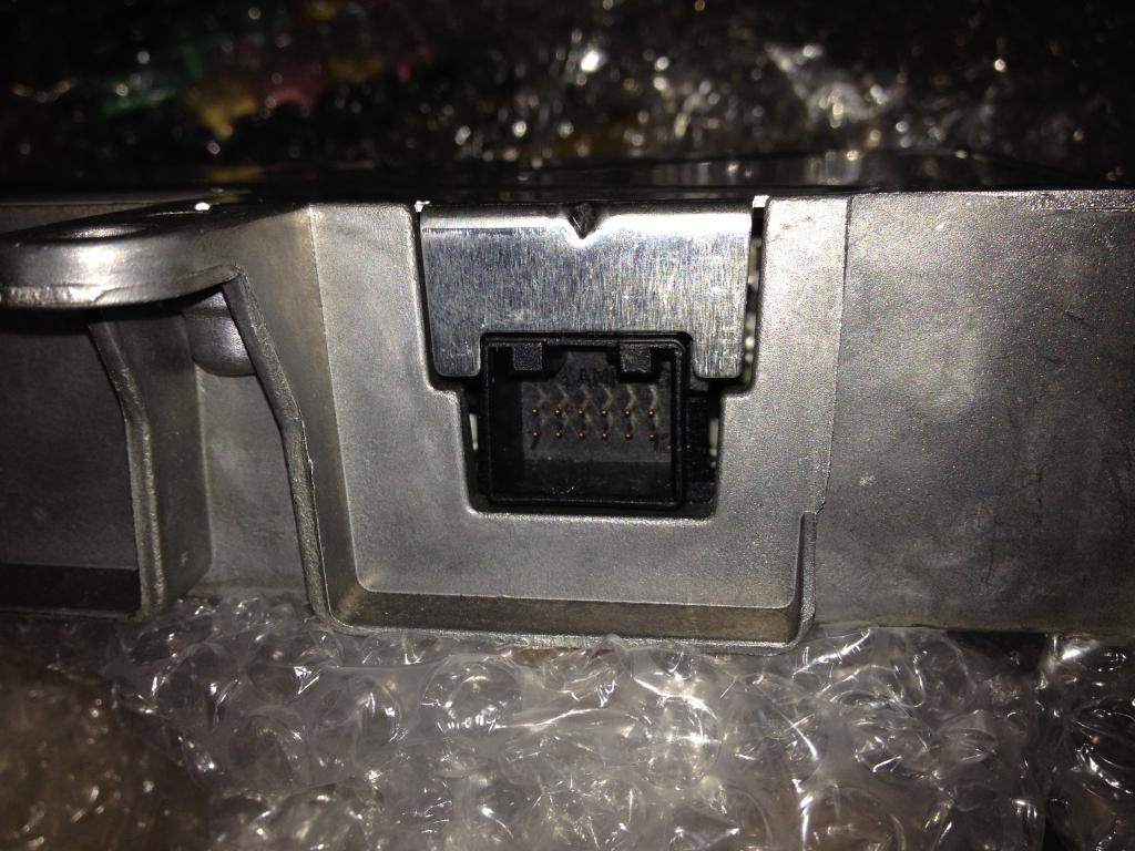

New amp for PCM 3

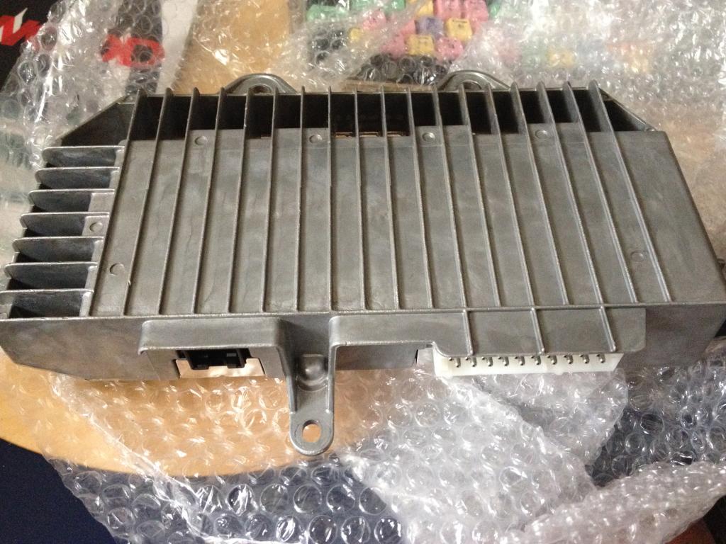

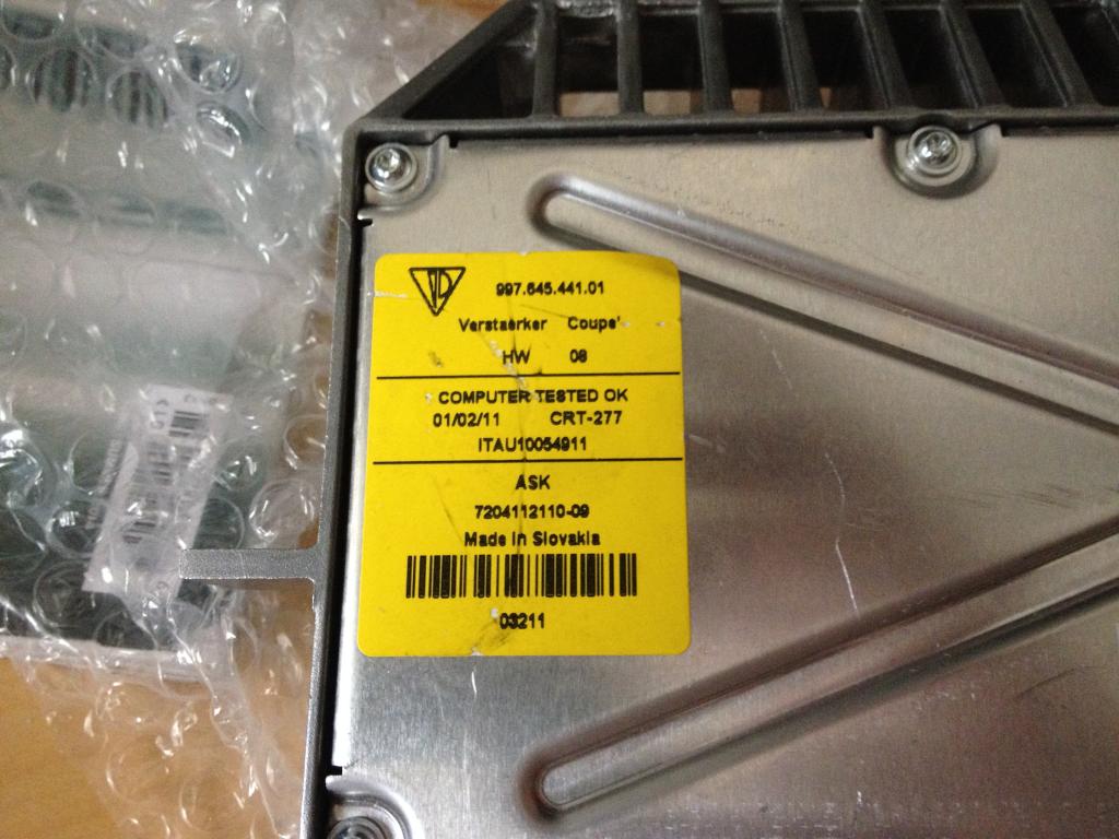

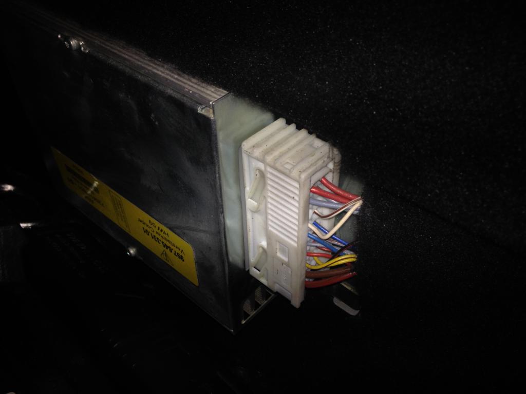

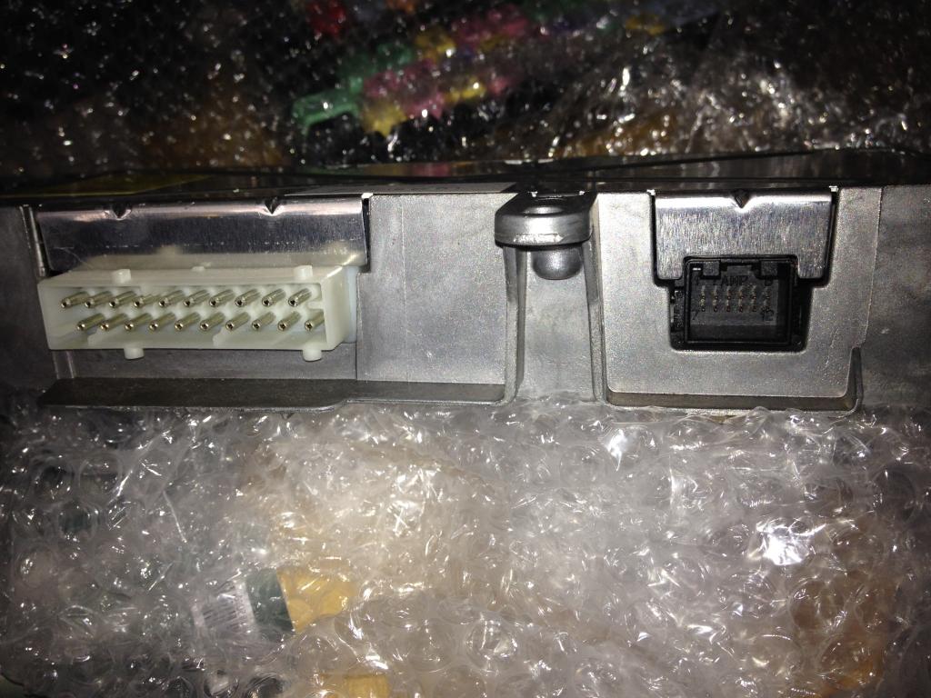

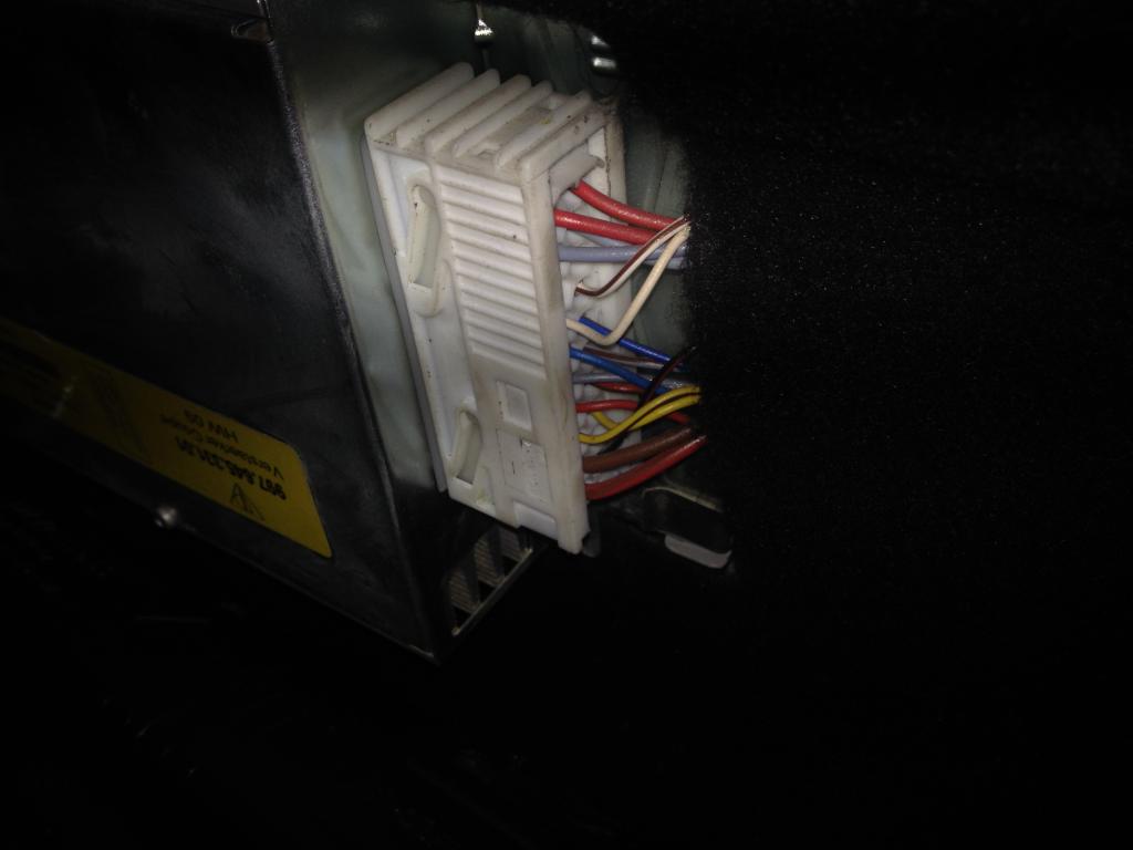

Hello hello hello chaps I'm back,,, I've got a new AMP for the PCM 3 mod now I've notice it has two Separate plugs on the new amp and my old amp it has only one white plug ,,,, its not plug and play ,,, would you have a wiring diagram for this conversion please and where do I get a plug for the black Square bit and what dose it do ... Thanks for your help In advance. ....... I now have all the bits in place ready to install but I'm Scratching my head regarding AMP....thanks from London
My old 997 PCM 2.1 amp wiring below
who EVER told you about plug'n'play???
I beleive black plug is 4A0972883
I beleive black plug is 4A0972883[/QUOTE]
Hahahahahaha no one said ,, but was just hopping it was hahahaha thanks for the plug info do you have a wiring diagram on how to make the connection or photos of the end result in car ... Serg124 thanks

mmm of course I have wirings. but. it all russian. and not at home. google for "porsche wds"
this black plug is for sound input, so you need to cut old loom off pcm connector, isolate wires each, and make new loom from pcm to amp from 4 twisted pairs 0.35 gauge

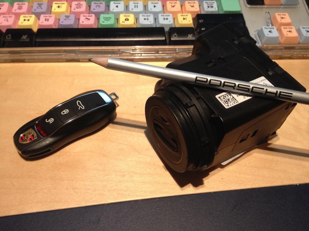

BUT ,,, I did manage to pick up a little something for a bit of fun KEY modding this key is from a 991 turbo s ,,, can i mod it to fit into a 997 ,,, IS IT even POSSIBLE ,,, check it out, what do you think ?

That would be nice if it works.
But pcm3 instead of pcm2.1. would also be great to have in my car...

have same kit (key and lock) for new cayenne. no plug'n'play at all. but I hope to find a time to do something with.
