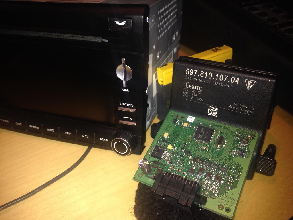

In the models 997.1 you don't need to change the gateway.
You change the gateway to cayenne models .

Pcm 3.0 gateway ....
INTERESTING, you see, I didn't know that, its not explain very well in the translation, so the GATEWAY only apples to the 4x4 cayenne models,,, hahaha,,, i just got a new GATEWAY and was so worried about fitting it in the car,,,,SO, i don't need it hahaha well off to ebay it goes

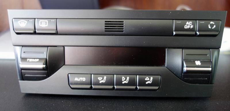

Since I changed my mind I have available an as new bose amp and A/C unit (without heated seats).

This bose amp is ok.. I dont know about your A/C unit as it has to be produced by a specific date (It is the same for the other buttons with pasm and sporct button as well).. ( I dont remember) i did this mod over a year now and i found out all these by myself... It is a great mod though..

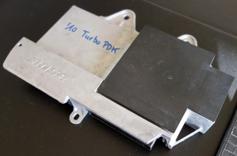

Guys could you please explained why you need to change the amp on the gen 1 997 PCM 2.1 I have a non Bose system is it just a matter of volume output I being to hight,,,, I know you can't adjust the volume on the outside of a Porsche amp but I'm sure you can from inside of the device ....

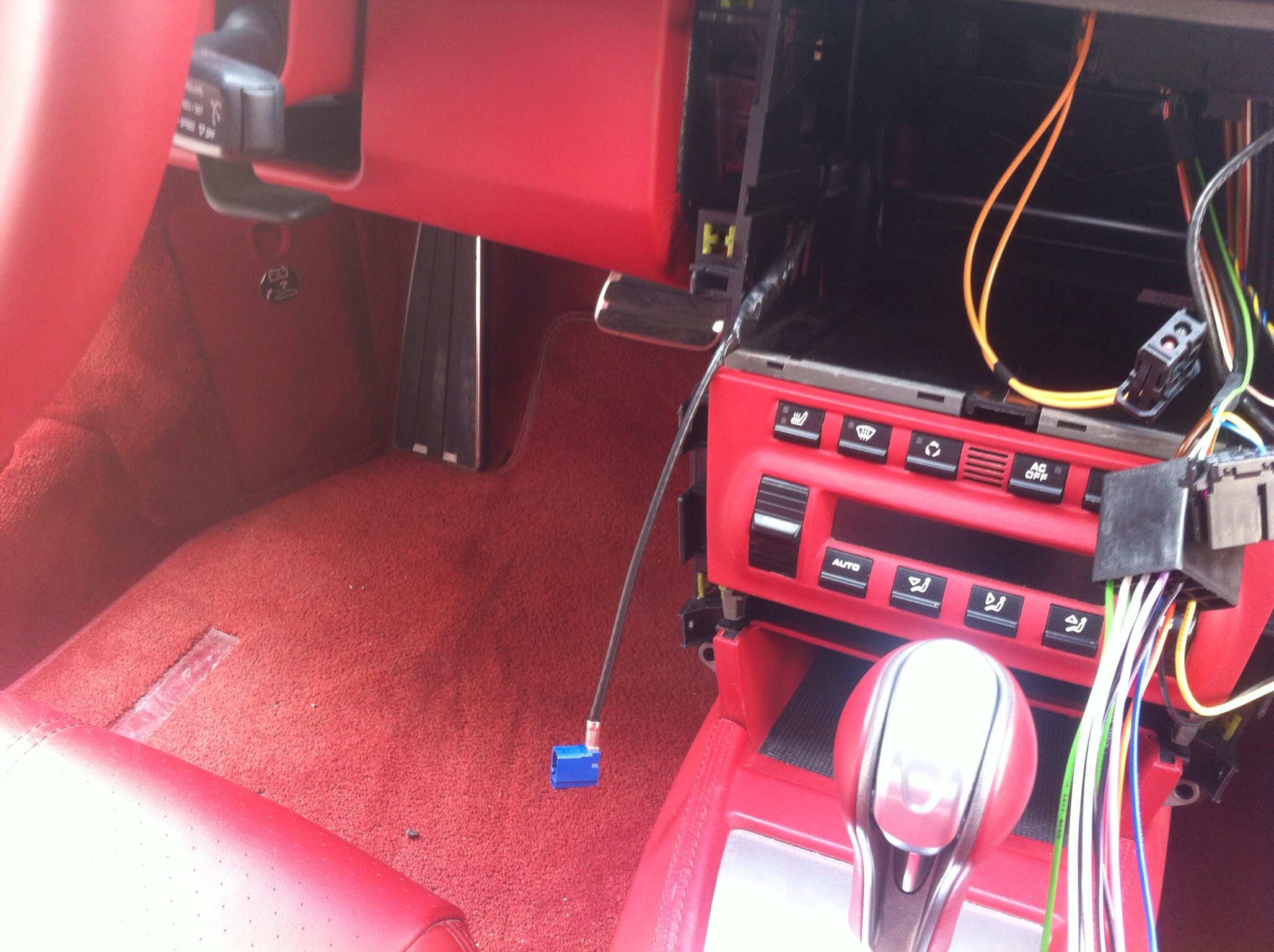

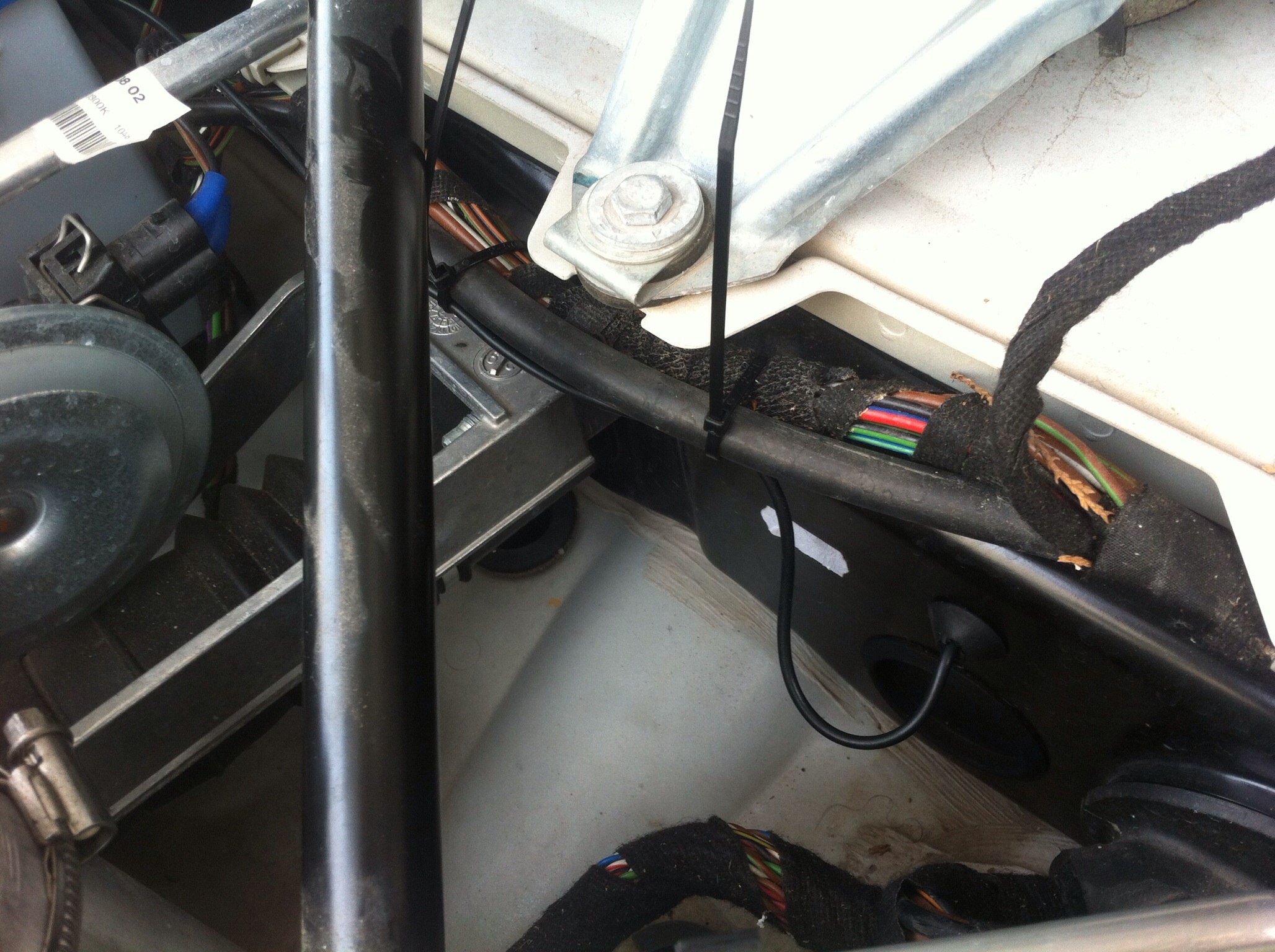

GPS cable from the back of the dvd Nav deck under front hood, is that correct, you have to replace this cable

You must change it because difrent PCM need difrend amp.
You must add a few meters of this cable.i have fotos I can send you.

Photo 2

My system is not Bose , dose it matter if I use this Amp all my speakers Connection will need to be wired and and Bose use a difference speaker systems with connection too , I've seen them,,, so what € are you asking for the Bose Amp as for the Ac module I need the one with heated seats and the auto button ,,, in my rush I got one but it doesn't have the AUTO AC Button so I have to go shopping again ....

Love the Red Interior sexy smile ,, nice ride and thanks for the GSM Cable photos Much appreciated I see you cut and rejoin the cable any problems with that ?

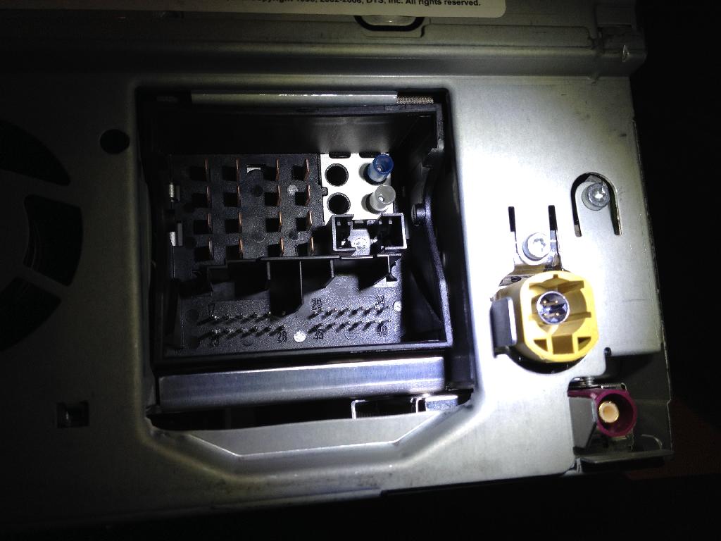

The socket back of PCM 3.0
