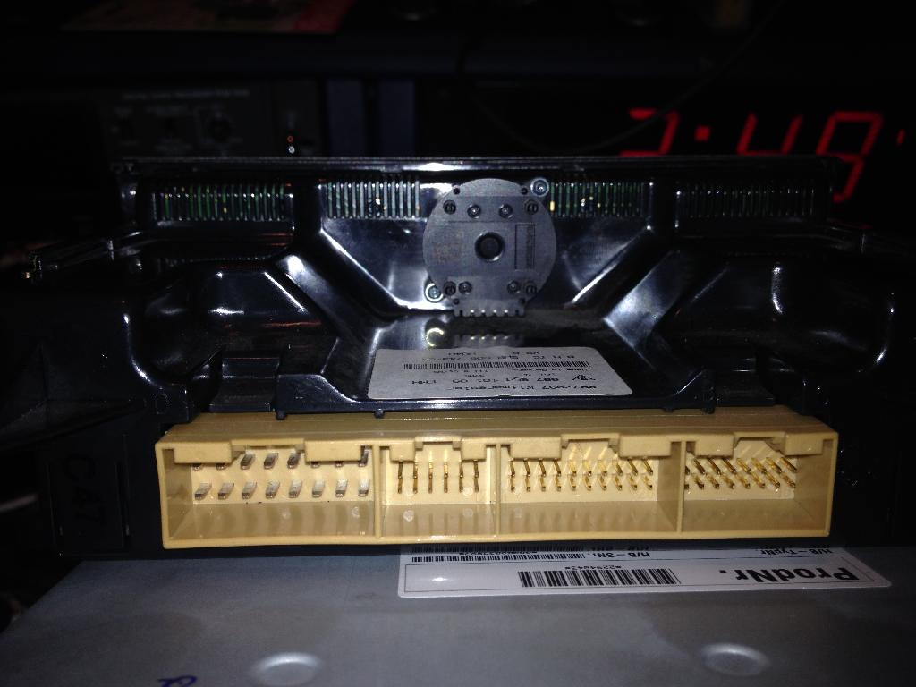

Pins from the my old AC CONTROL UNIT

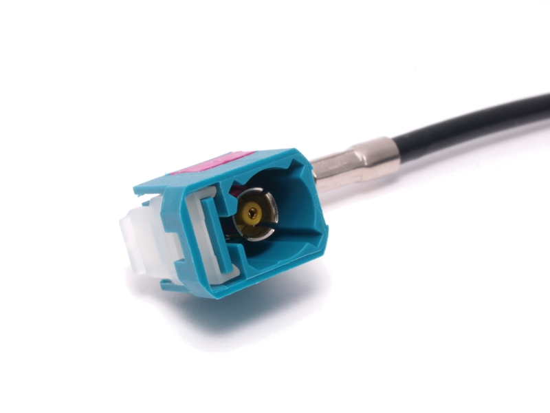

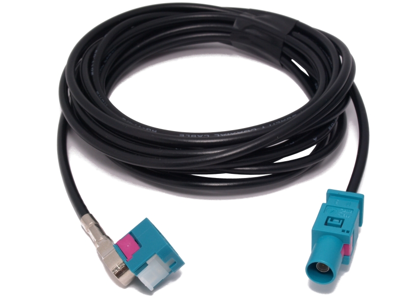

Here is the GPS 3m Antenna Extension Cable called a FAKRA Z
about £$€10.00
ID:	338948   Click image for larger version

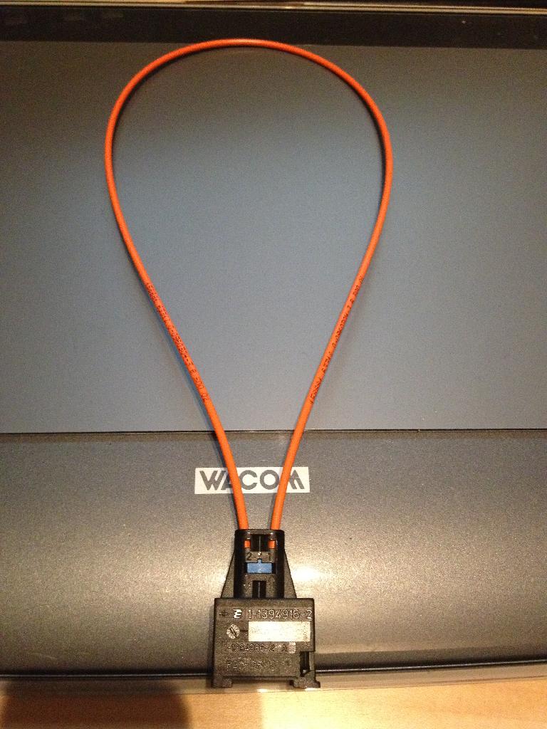

back of a PCM 3 socket from a Bose system ....
optical bridge/ loop £10
front of PCM 3 connector
ID:	343575   Click image for larger version
ID:	343576   Click image for larger version
