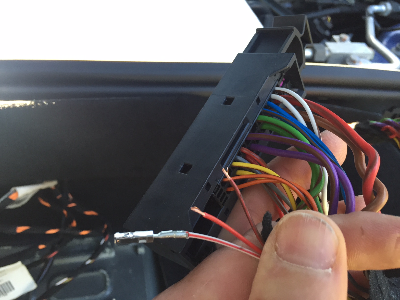

monster1 is infamous around these parts
This is the re-pinning of the old Bose amp connector as the pinout is different for the new amp - also the wire colours are different - the 997.1 amp also uses a large connector and a small one with 3 wires in - the 997.2 amp just uses the one large connector - same as the old one - but it includes the 3 wires in it from the separate plug - all this becomes clear when you study the schematics.

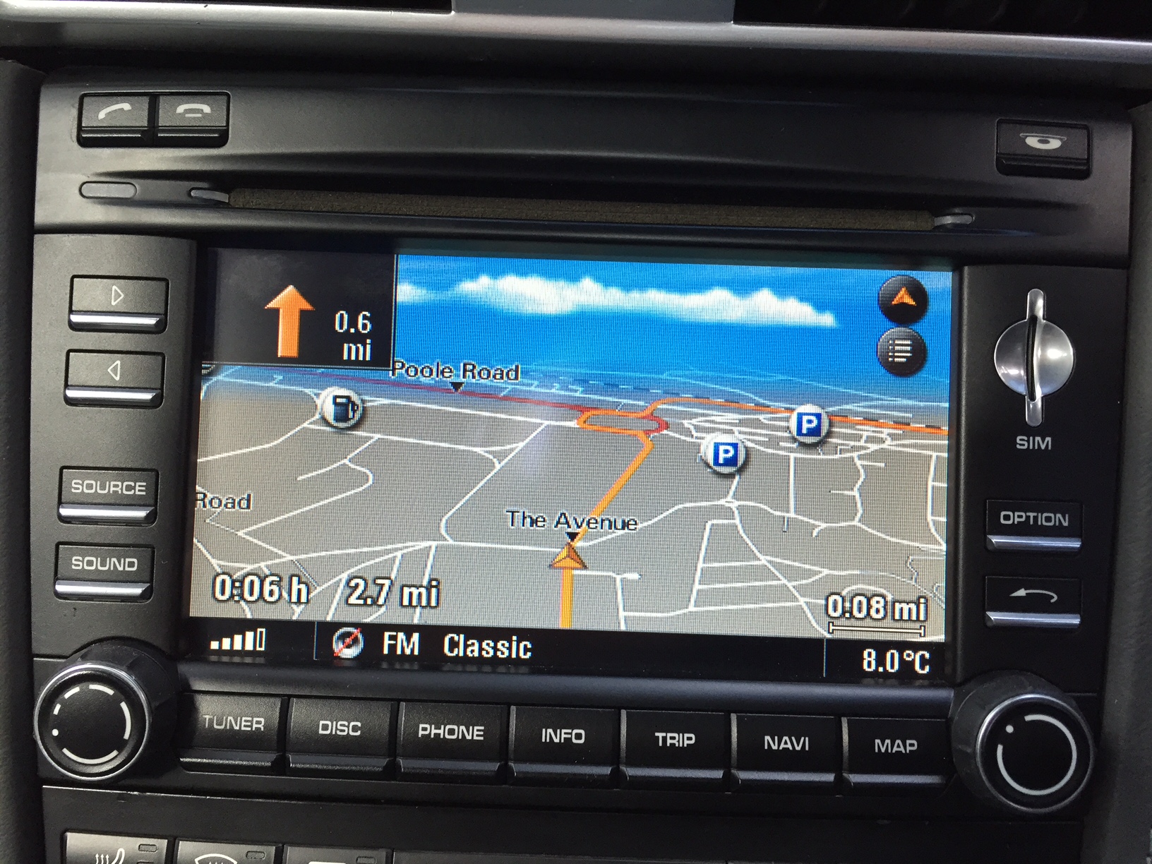

navigation

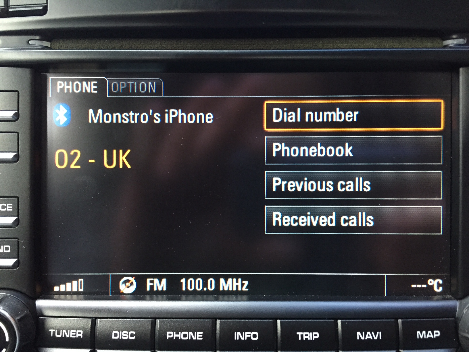

bluetooth - phone book downloaded, takes and receives calls - still got to wire the new mics into steering column - job for later this week
