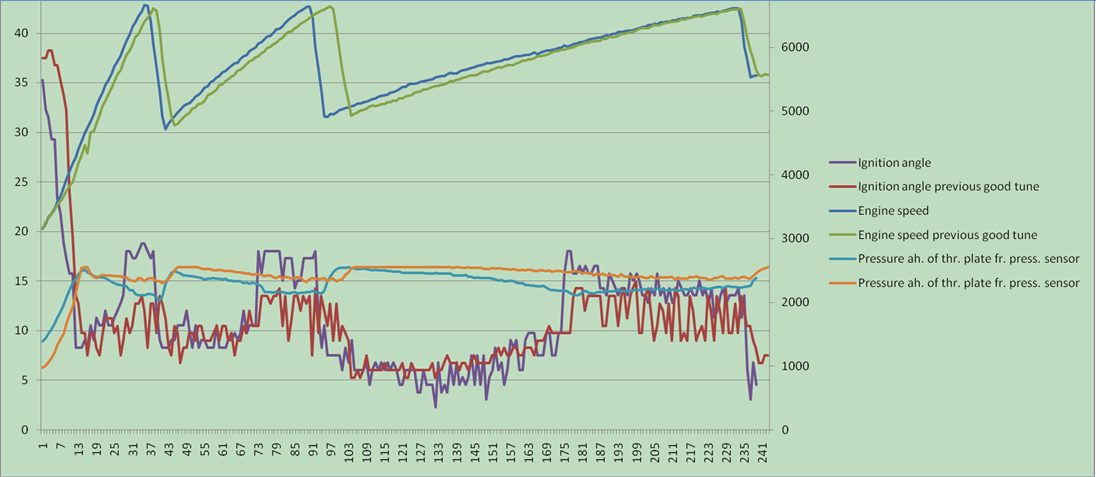

The DME is still correcting the "fun" above ~220kph on the new tune. Timing is gone, AFRs go to 10.0, and boost is reduced to cool things down and quell potential knock. There are signs of life again above 250kph but thats because you're at 1.2 bar vs 1.5 bar. Too much boost for whatever octane you're running, particularly through the 5000-6000 rpm range IMO. I'm sure Todd will have some input though. You get away with it until that 3-4 gear change. Octane/boost aside, high ambient temps can be brutal on these cars, even with good intercoolers theres only so much you can do without getting into chemical intercooling (methanol).
It looks like he did pull some boost out at the higher rpms on the new tune, but only above ~6000rpm. It's getting there.

You need intercoolers to keep get your IATs down. As earl3 said, it looks like the the ECU is pulling boost to compensate. In fact, look at your boost when the IAT is logged >60.

He's got the .2 coolers which is why he's "only" 33C above ambient at 270kph Its the 30+C ambient temps combined with 1.5 bar+ boost that are just brutal on these cars. I'm not sure he's going to see much better IATs without a meth nozzle helping things out. CTR cores would probably keep it within 25C of ambient on a hot day but big $$$.

Hey Earl, Thanks alot for taking the time to look at the data log. Yes you are correct Todd told me he had reduced the boost on the higher end in the new tune. And as you mentioned I do have the .2 Intercoolers installed but I am still seeing Higher than expected IAT's. Im sure Todd will have alot to say about the data log, So I'll wait to see what happens, And I will keep you posted!
Just a quick question for you, Do you think if we reduce boost <1.5 Bar, will it reduce or increase performance? Will it significantly reduce IAT's? What would you recommend in my case? (I would prefer to avoid chemical cooling).

Hi Tareq, I'm not entirely sure but my hunch, based on sifting through various logs, is that you will sacrifice 0-200kph performance a touch for the sake of increasing 200-300+kph performance, particularly in the hot environment you're in. Unless tuners have the ability to request torque/boost by gear or speed which I don't think they can with the factory DME(?)

Thumbs up Updated Graph Comparison
Hey Guys,
Todd managed to send me a graph comparing my previous "Good Tune" with my new revised tune.
It would be great to get some feedback from you guys so I can choose which tune I should settle on for the meantime until Todd sends me a revised one.
Thanks!
