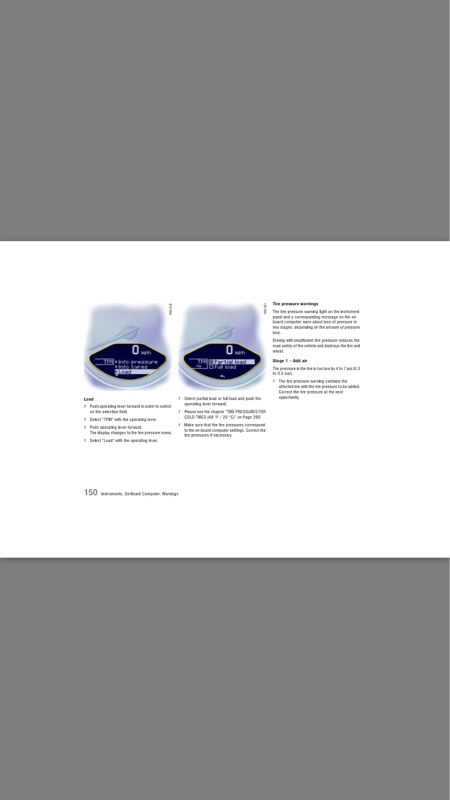

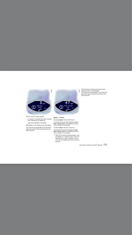

On a related note, any way to change the PSI reading by which the sensor activates the "Flat Tyre!" dash light? Right now it comes on when the fronts reach about 35psi and the rears get down to 38psi. Kinda annoying.

This is set by Porsche. See the owners manual below.
Also, to be sure, have you set the proper season and load for your tires?
