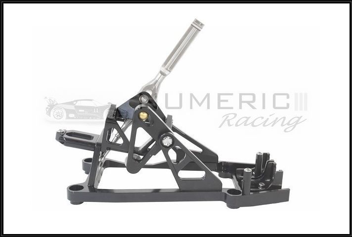

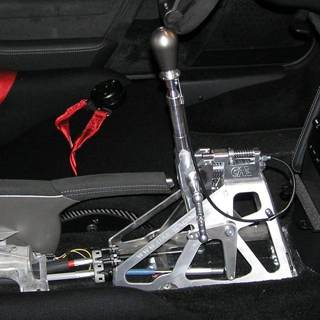

Numeric or CAE Shifters -- Both are significantly higher quality and more "race" focused parts
Numeric
CAE

Would those even fit under the center console? I'm looking for a shifter for my daily driver, not a full blown track car to be clear.

i know numeric will.. thinking same for CAE.. wasss looking to pick up a numeric from the classifieds.. goneeee.
