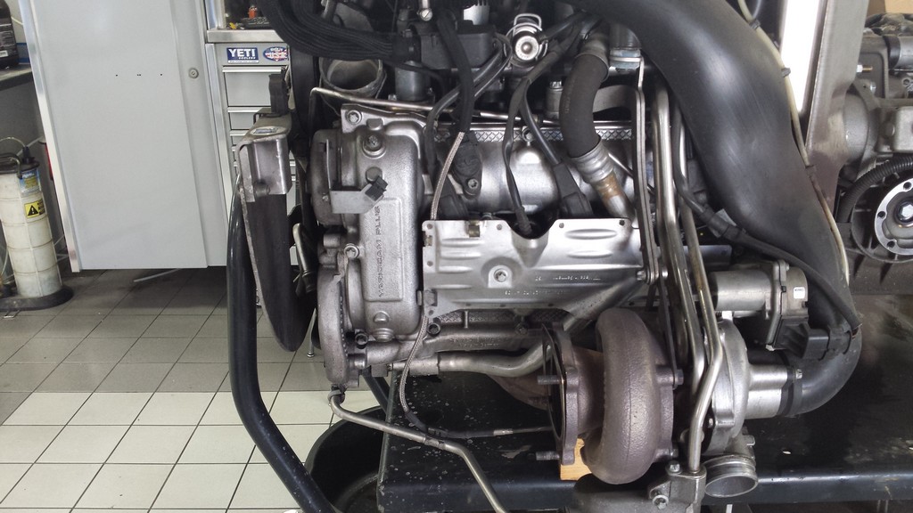

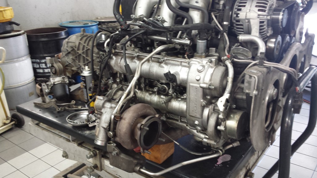

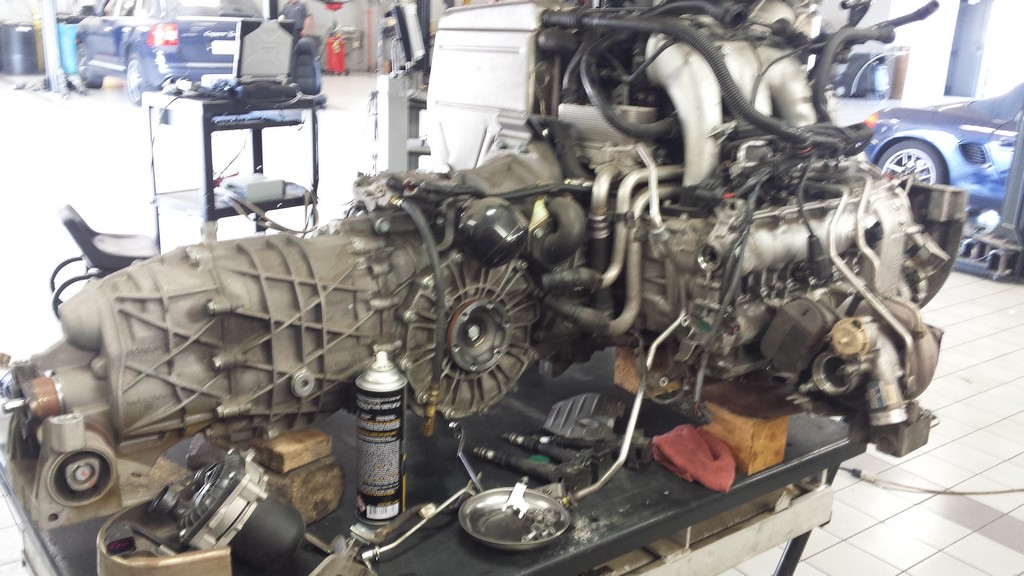

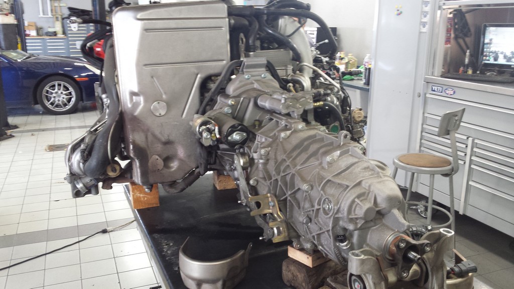

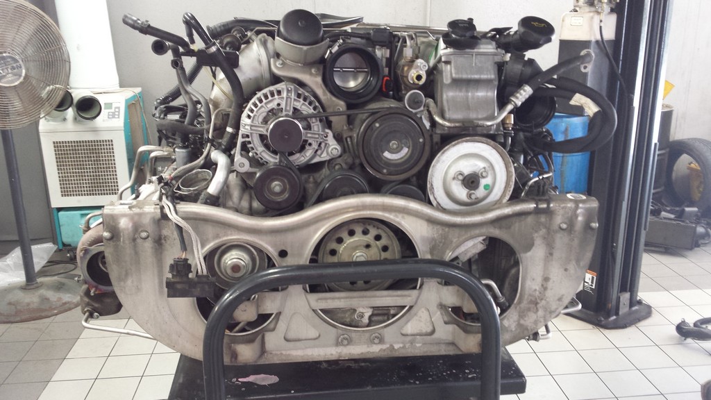

So today I got my car back after a lengthy stay at the dealer. I dropped it off on Sept 1st, back to me on Oct 21st. A little background on the car: 2007 997.1TT, 43K miles, I’ve had for 2 years and it had 31K miles when I bought it. Never tracked. A few minor mods (Speedtech exhaust)
A few weeks ago, driving along in traffic, the CEL comes on.. First time in my ownership that I’ve seen the CEL light.. I get home and read it out with my Torque app.. Uh oh, P0011. (Aside: whoever said that Durametric does NOT reverse some codes on readout was WRONG. I hooked my Durametric up and read out the code and it reported a P1100. This was with Durametric version 6.3.2.5 )
From reading the forums I had an idea what this was.. so I make an appointment at the local Porsche dealer in town.
First they replaced the variocam actuator (the one that sits on top of the cam housing, not the solenoid between the cylinders.) Not sure why they don’t just swap it to the other side to troubleshoot, but whatever.. so they give the car back to me (end of 1st week). I drive all of 3 miles toward home and CEL comes back on.. back to the dealer I go..
This time they pull the engine and, according to them, inspect the camshaft and see that it is still lined up.. the camshaft holes are aligned. So, according to their book, they replace the camshaft actuator on the end of the camshaft, along with the hex bolt that secures it to the camshaft itself.
It all goes back together, they do a test drive this time and the CEL appears again..
So once again the engine comes out and the cam is inspected and this time they can see that it has spun in the sleeve. So a new cam is ordered and put in.. Since this is a dealer they don’t support “pinning” it. The shop foreman was apologetic about the time it was taking to troubleshoot and said that he spoke to the regional rep and also to another dealer nearby.. supposedly the other dealer had a car with the same issue and it had had its engine out 3 times trying to fix..
A few other notes:
- During the 1st engine-out procedure they managed to break the alternator mounting bracket, so I got a new alternator out of the deal as it’s an entire assembly, apparently.

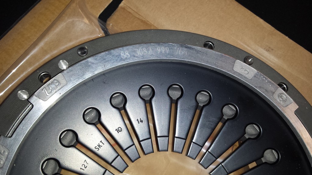

- Since the engine was out, I decided to have them crack the clutch housing apart and inspect the clutch. Good thing I did, as it was pretty worn, probably about 40% was left. I elected to buy the upgraded Sachs “2.5” clutch that comprised of the 764 Pressure plate and 098 disc. (pics below) Thanks Sam (by Design) for the quick delivery!
- I previously had complained on a previous visit to the dealer that the clutch didn’t feel completely right. It worked correctly, and didn’t have any visible leaks, but sometimes I could feel an almost a pulsing thru the clutch pedal when I went to push it in after cruising in gear for a long time. I mentioned this again with the shop foreman and he said he would check it again.. Well, they ended up putting in a new accumulator & clutch slave as well.. that’s the 2nd one done on this car (the first was done prior to my ownership - I have records indicating it being done at 11K miles.)
- I had them replace the fuel filter..it was sitting on my shelf from an parts order from last year and I never did put it in yet.
- I had a Volvo S60 loaner for 6 weeks, not too bad for a family hauler..
So you might ask, what was the damage? Well thank goodness as the car is CPO, and it expires in about 3 weeks.. needless to say, I will be obtaining a Fidelity platinum warranty before the CPO is gone, I have already shopped around and got some pricing.. If I didn’t have the CPO this repair would have been between 6-8K.
All I paid was the labor to R&R the clutch that I provided, which ended up being 2 hours at dealer rates.
Anyone know a procedure to break in the new clutch?
Car feels good as new, clutch feels nice and smooth, just a tad touchier than the stock one.
A couple of pics below:

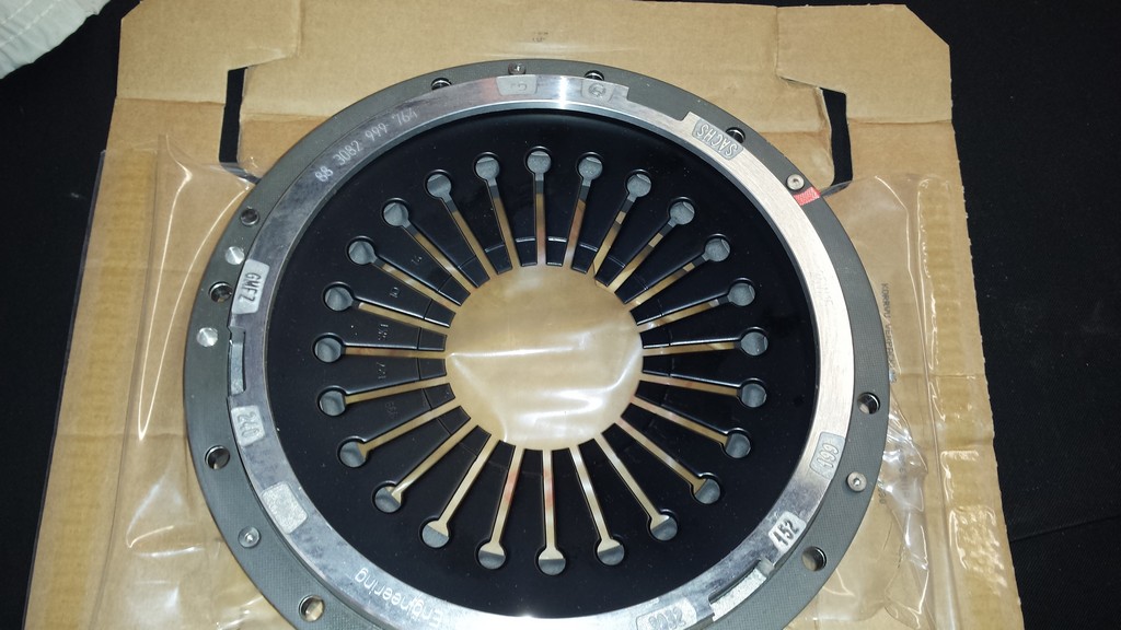

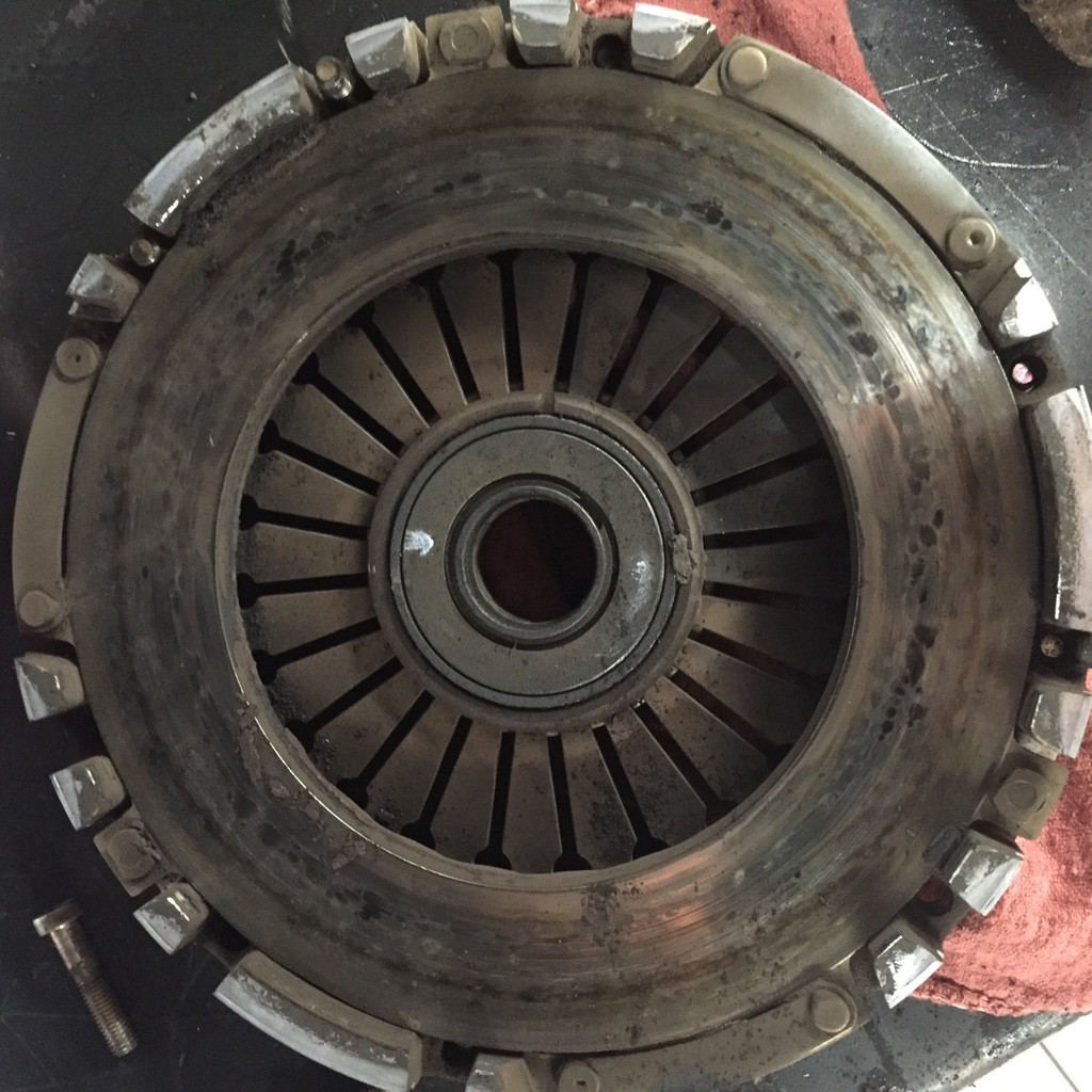

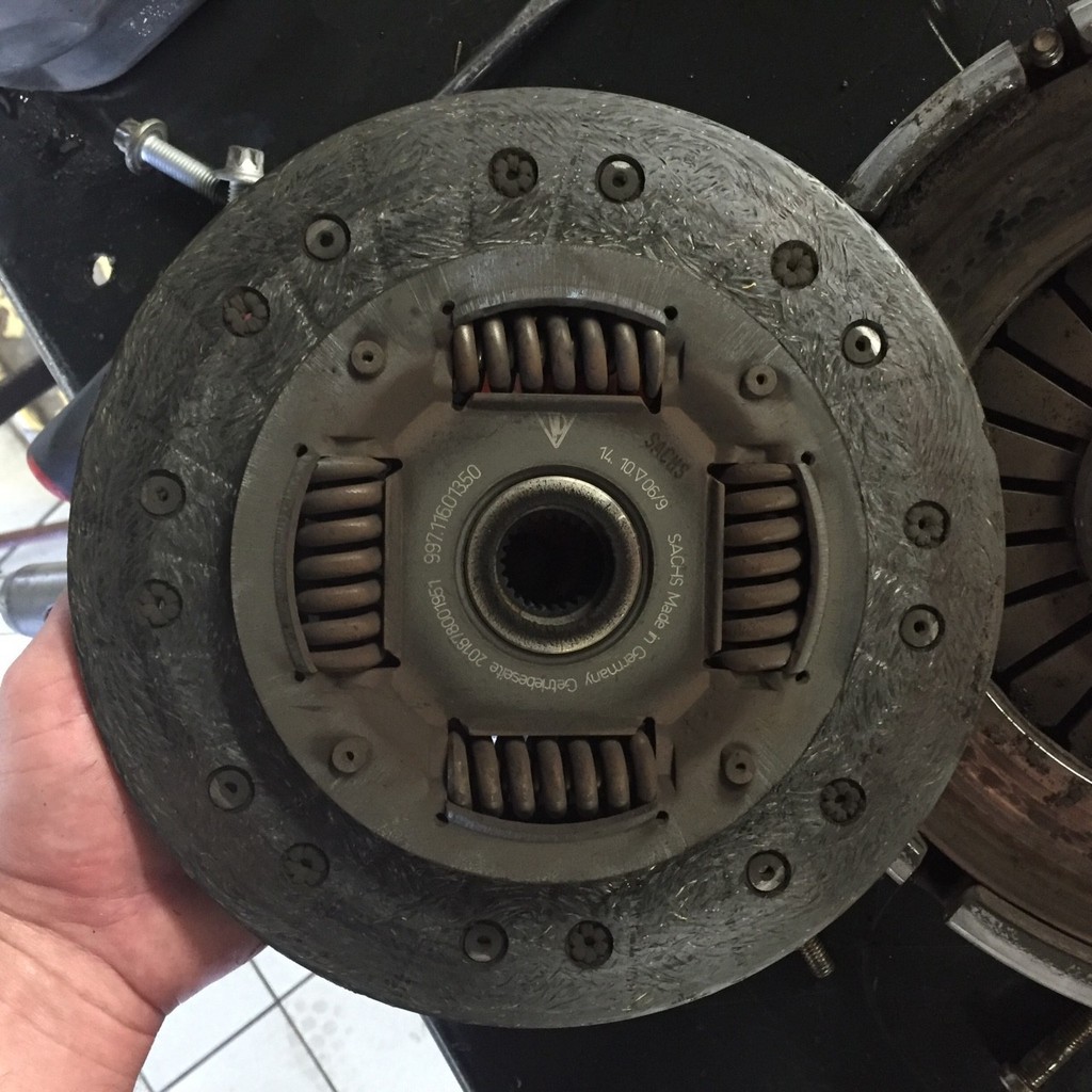

Old clutch disk & PP
New clutch & PP

Good choice on the clutch though. I'm sure you'll enjoy it. Looks like you had a little slipping on the flywheel. Did the old clutch shake the car at all during engagement?

Originally Posted by elite1
Dang, Sorry for the troubles. I haven't come across this error "yet."
No, it wasn't slipping as far as I could tell, and no shaking..
What's the correct "break-in" procedure for a new clutch?
