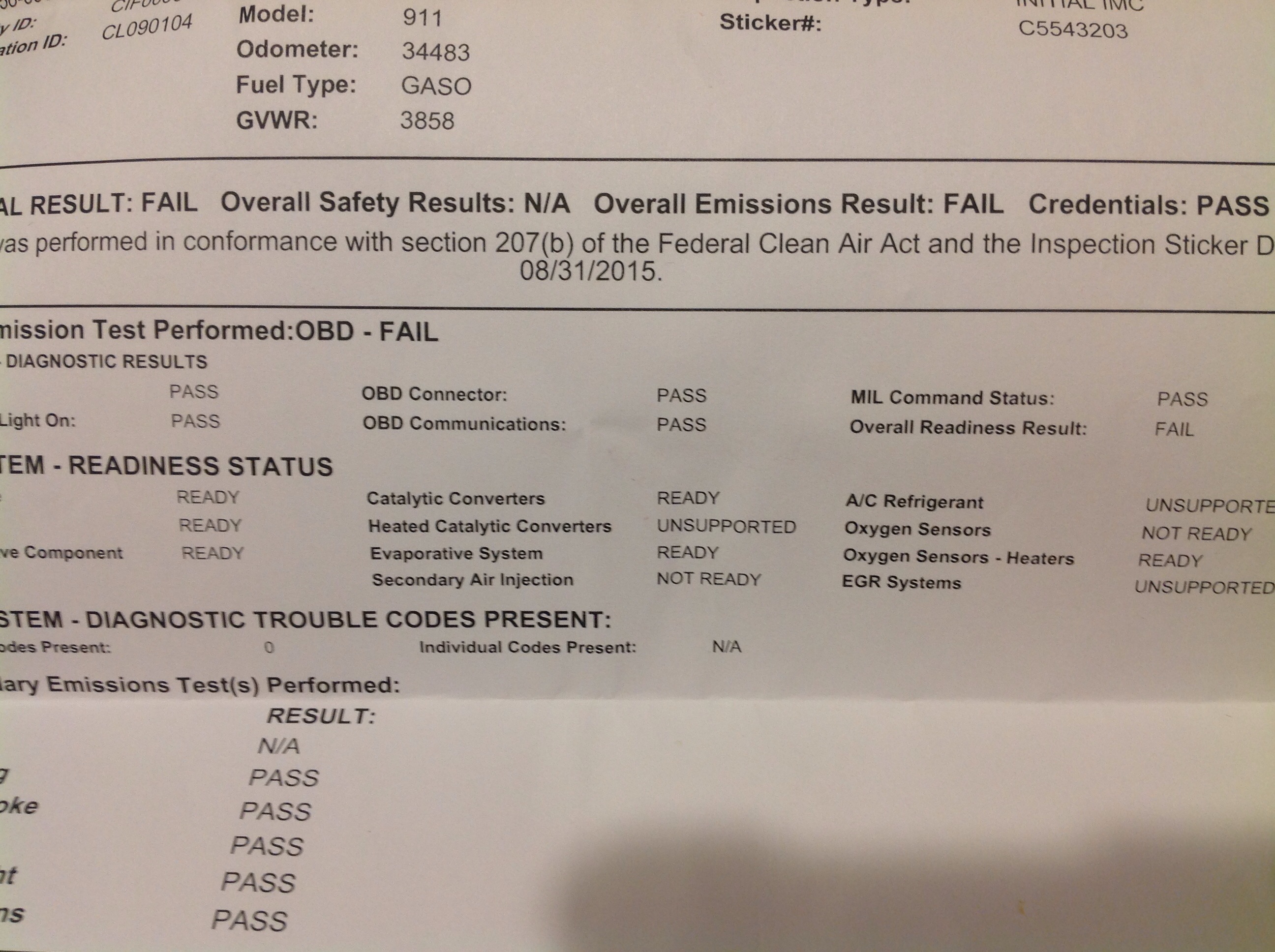

Hey guys, just got a new to me 08 997Turbo. Car has GMG headers, exuast,xpipe and its probably catless (or high flow cats). Runs great, no check engine, no codes, etc. I assume its got a tune on it but no clue who did it or how.
Here in OR Its just a plug in test, no sniffer to pass DEQ. It passed visual and smoke, failed the rest. Here is a print out.... Who can "readjust" it to pass ?

If your not getting a cell the o2's may be turned off. First thing you need to do is get them turned back on. You need to find out who's tune it is. Either that or get it flashed back to stock and start over with a new tune that you can put in and take out when you want.

There's definitely a tune to ignore the O2 sensors. So it's currently not in ready mode.
Revert tune back to stock and all those errors will come back.
