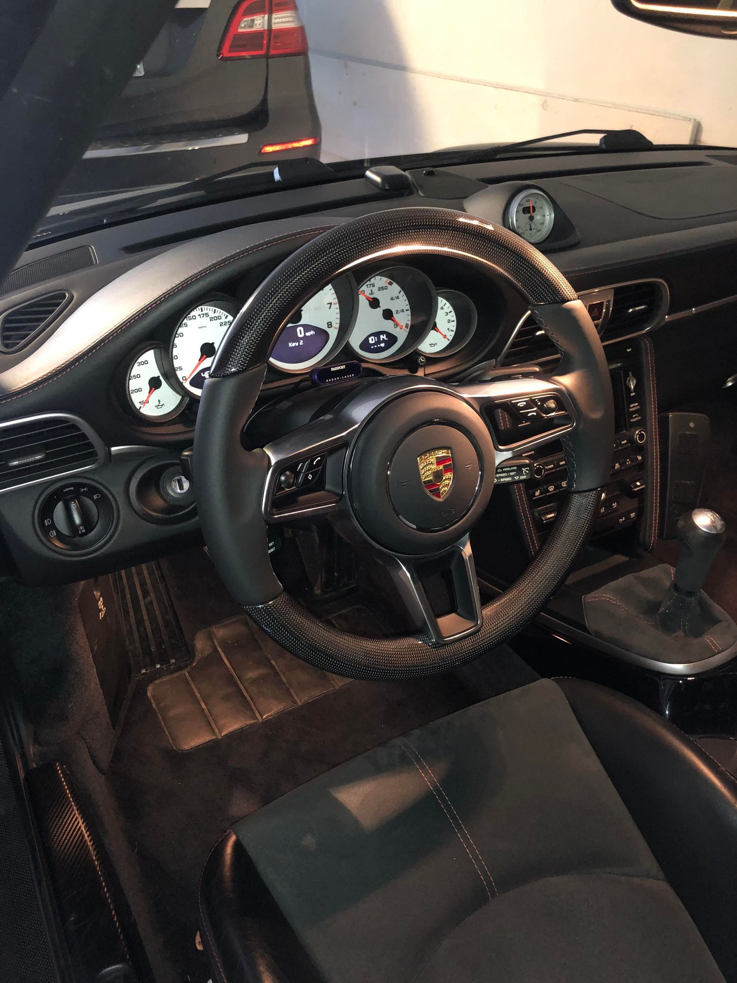

I have a 2009 6MT 997.1. Turbo
My car did have MFC and i installed a 991.2 Carbon Wheel with Heating
After installing the Horn does work although the MFC nor the Heating work
can someone relay the part number i need from Porsche to enable Heating and MFC
I can verify i did have my dealer try to enable MFC and nothing happened,
thank you

I worked with Ryan at Vivid Racing to have an OE blank hand made to my specs, then it was a straight swap of steering wheels. Note how well they matched the leather color on the new sport grips with my OE airbag cover.
