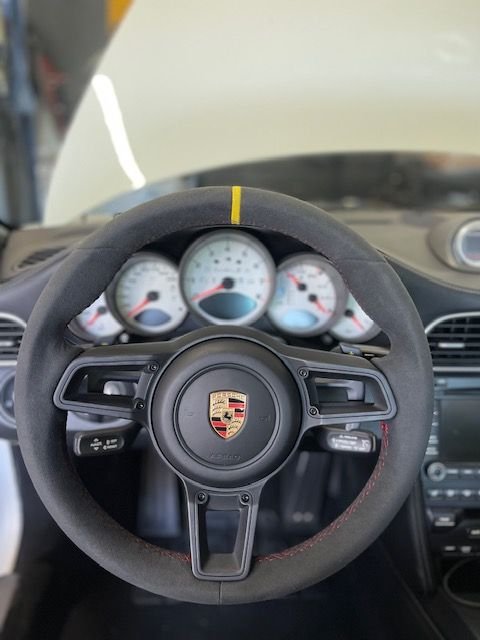

Updated my 997.2 Turbo S to 991 GT3 RS alcantara steering wheel. Love it.
